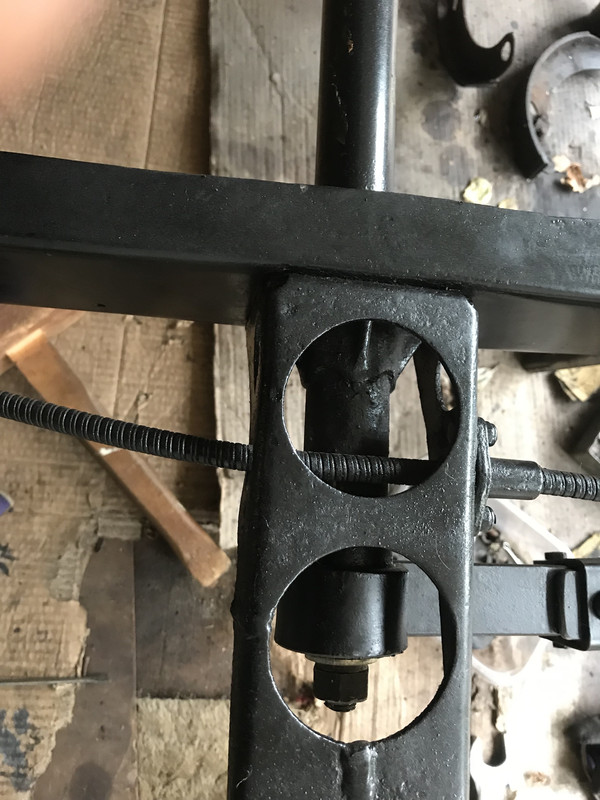

I am replacing the rear springs on my TC and having great difficulty in fitting the (big) spring eye to the mounting boss. The old spring came off easily but the new one just doesn't want to go on.
Anyone had this problem?
Polite suggestions as to what I can do with my springs welcome!
Ray.

Pictures or more info needed for clarity on your situation. However, taking a guess, a common mistake sometimes is to have the rear shackle plates (item 63) orientated such the rear spring eye is wrong way round. The spring wants to "flatten" making it very difficult to install.
The rear spring eye goes above the pivot point of the rear shackles in the proper orientation.

The difficulty I am having is getting the front spring eye of the rear spring onto the silent block bush/pin (item 62A/7) in your illustration. No problem at the other end of the spring.

Put that end on first, A little grease on the silent bloc, snug it up and rotate the rear eye into position with only the inside shackle plate in place, install outer shackle plate and snug everything up. Unless I've missed something, it sounds like you've got the rear eye and shackle plates in place first.

I have tried offering the front eye on the silent block first with grease and it won't go on. Not even with help from a persuader.!
I wonder if the eye has been made a shade small.
Can you tell me how the pin (with the silent block bush) is fitted onto the chassis please?

That pin is mounted to the frame rail via a through hole with a nut and washer on the inside. Based upon your question I'm guessing it was not removed and the Silentbloc is new. So with the pin O.D. being larger than the Silentbloc I.D. (which is a metal bushing), you have either a Silentbloc that is the wrong one for a TC that just happens to be the right outside diameter but the wrong inside dia. Or, the inside metal bush has manufacturing mishap in a raised lip on it that prevents it from accepting the frame mounted pin or a wrong metal bush from the git-go. Are you replacing both sides and if so, do both sides present the same situation. For the record, I did not have any problems with mine, they were Moss supplied items.
I would measure the inside diameter of the bush in the Silentbloc against the outside diameter of the frame mounted pin. If the interference is small, you can probably ream or carefully drill the bushing out to a larger diameter. The fitment is SFNS (slip fit-no slop) as it does have a small degree of rotation on the frame pin and wear will be accelerated if you have a loose fitment.
If the difference is so much as to compromise the thickness of the bushing wall if you do any machining to it, then I suspect you have the wrong Silentbloc and should consider getting a couple of new ones from Doug at FTFU.

Thanks for that, Marv. No, the silentblock bush is original and the pin on my car appears to be housed in a tubular extension to a chassis cross member. I can see no obvious way of removing it as everything is riveted.
As it happens, I have now succeeded in fitting the spring... I made certain there were no burrs on either the spring eye or the silent block bush and applied a slight chamfer to the edges to get things started. I used a heavy brass drift and tapped the spring eye on until there was sufficient thread showing and used the nut and a big washer to draw the spring fully on. Phew!

Whew, that's good, I was incorrect in my statement on mounting the pin. I believe, although I'm not positive as I've never removed one myself, that that pin unscrews from the frame. No access to allow for a nut and washer on the TC.
Problem solved anyway. :thumbs: :lol: :thumbs:
