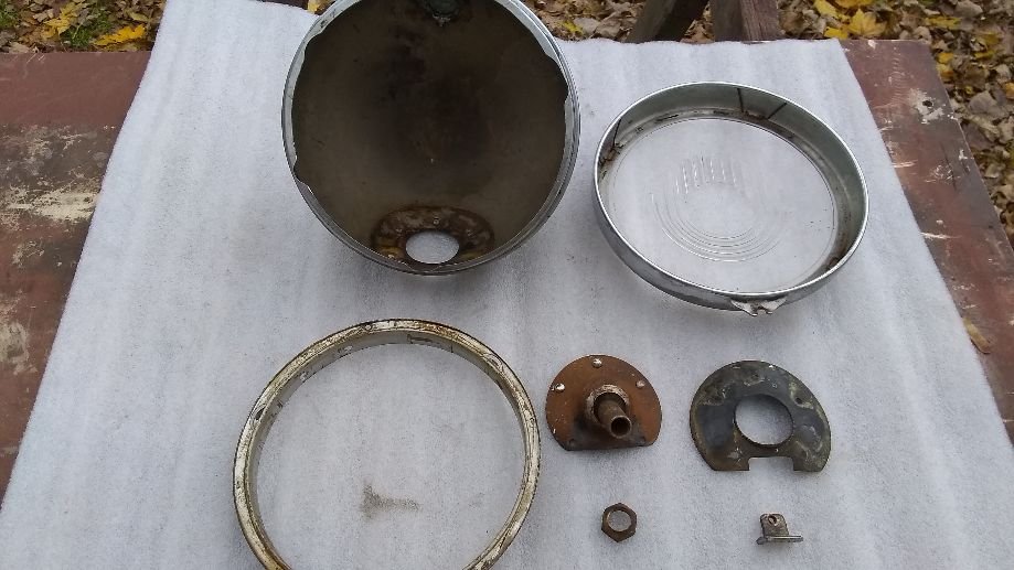

Post by Rob Reilly » Sat Nov 13, 2021 8:20 pm
Here are the head light parts I have in hand (two of each). They are model L140 with the U lens. Fortunately those are not damaged and I have wrapped them in bubble wrap bags.
I need reflectors and bulb holders. Can anyone post a picture of them?
What additional parts do I need?

Here is one of the mounting rings I have.

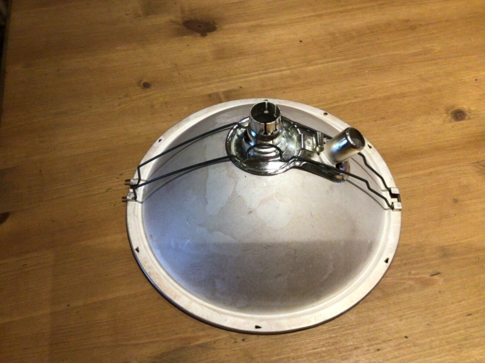

Post by Rob Reilly » Mon Nov 22, 2021 3:23 pm
Is anyone able to send me pictures of the back of the reflector and bulb holder for TA or TC?
robreilly120@comcast.net
Posts: 2784
Re: 8 inch Headlights
Post by Steve Simmons » Mon Nov 22, 2021 3:48 pm
I can post photos of both but it will take a couple days. Hopefully someone beats me to it.
