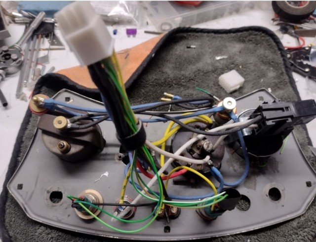

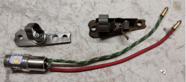

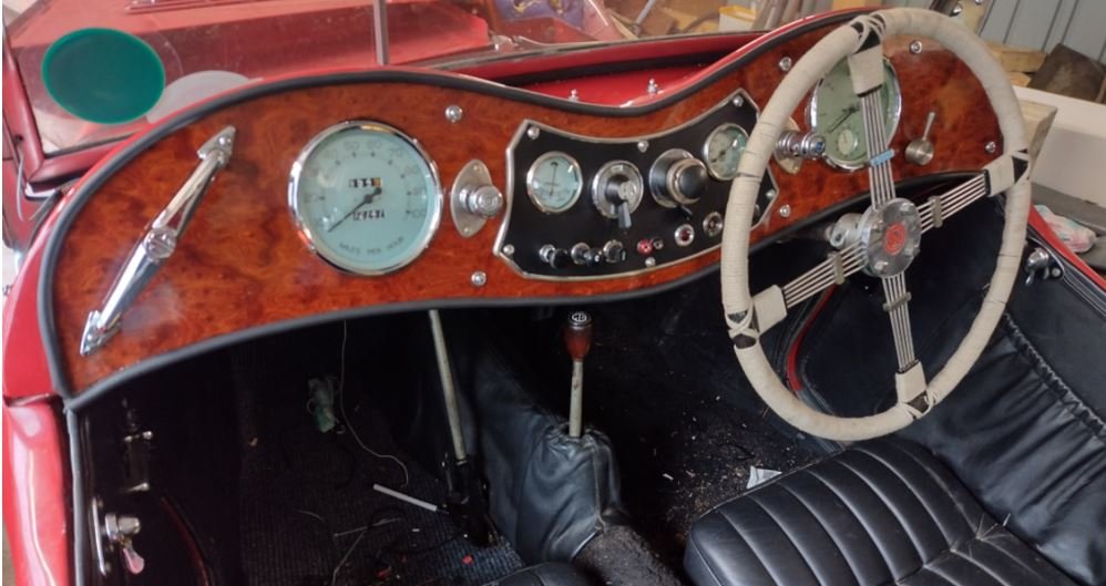

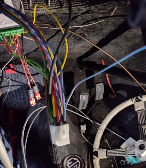

here are some pictures from my new dashbord
first from the new sockets , krimped and soldered
as you see i have two sockets for the direction lights behind the dash, here still with lamps. I will take them off later, so it is possible to check fast when something doesn t work.
dash 2.JPG (81.08 KiB) Viewed 4129 times
Posts: 578
Re: MG TA1932 in Germany - Blog - all problems and ...

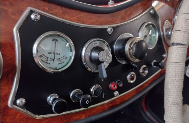

Post by Franz Tenbrock » Wed Feb 16, 2022 11:11 am

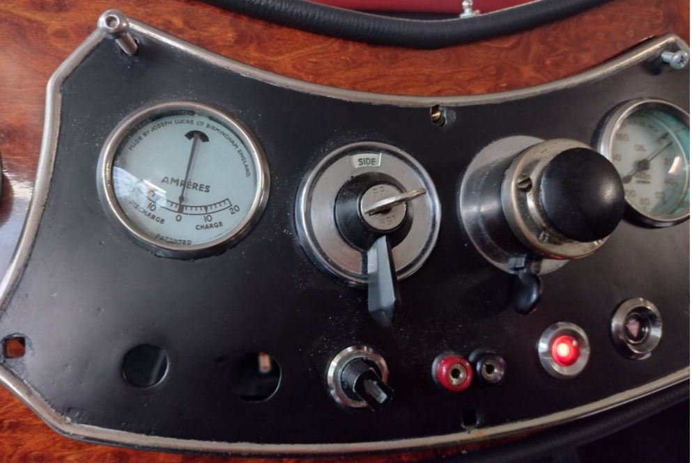

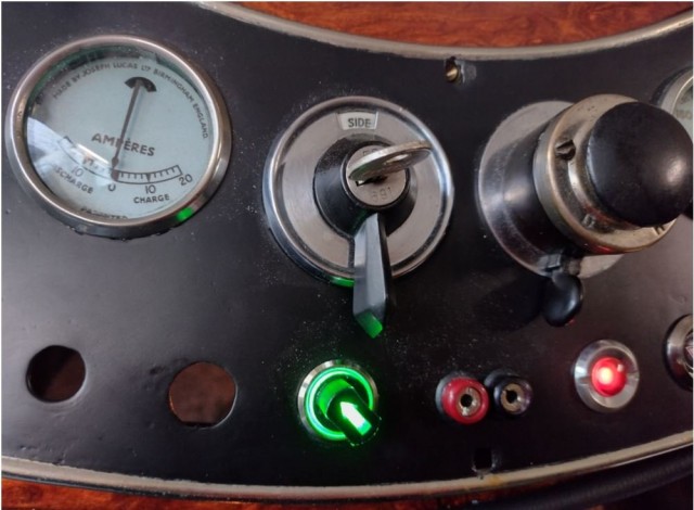

and here from inside the car
look how bright the control lamp for direction light is,
if light is off it looks like the original switch, but in use it is really bright so i will not forget to switch it off
i started the car this evening and it runs wiht first try
still have a little problem with the choke, have to pull harder then before
perhaps i will change to the old choke cable, with this cable i can block it in several positins
most work done now, much faster then i thought
no additional switch on the dashboard
control light for beamlight in blue, hazzard warning light in red and direction light in green
so all what i need here in Germany
and all so bright that i will not forget to switch it off
perhaps i will install a remote switch controlled battery cut off

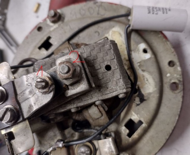

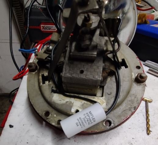

one horn was damaged, which I had written a few days ago
I ordered a capacitor
received it today
the horn works now again
first I used my transformer and not the battery
with this tool the horn gives only one loud, I cleaned the contacts
all around
after that nothing worked
then I took a battery and the horn screams loudly
must adjust the screws so that the sound is a little better than now
Do you know how to adjust screw 1 and 2?
I know, not exactly how it works,
screw 1 is for the contact and when the horn is off it should be just closed
Screw 2 is for the tone, and sets the stroke height, high stroke height = high tone???
also I made some changes to the choke and everything works fine now

on the table the horn runs perfectly
but after i installed it on the car it doesn't scream anymore
as i tested it is the positive ground that is not good enough
will do it later, the other horn is ok

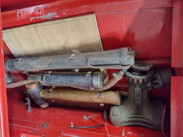

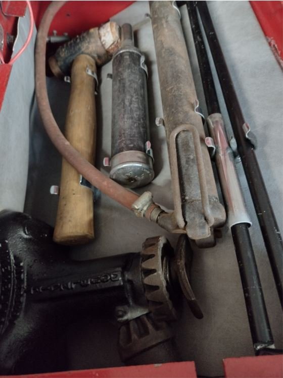

then I installed the tools in the tool box.
the jack is not the original one but a double one so i can lift it higher and i got it 2 years ago for 30 pounds with shipping
i did not want to pay for the original one
so I had to make some changes to the position
but this way it is ok for me
now i still have to make the handle for the jack, a folded one like the original but i will make it myself
as you can see on the second picture the starter cable goes through the toolbox
Also I don't want to make new holes for the tools so I'll take a wooden plate to fix everything, will paint it still later ( in summer when it's warm and I should be bored of sound )
don t know why, but the starter handle i got with the car is about 3 cm to short
will take it for the YA and make me a new one, should be not too difficult

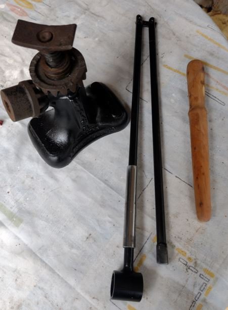

Post by Franz Tenbrock » Fri Feb 18, 2022 5:18 am

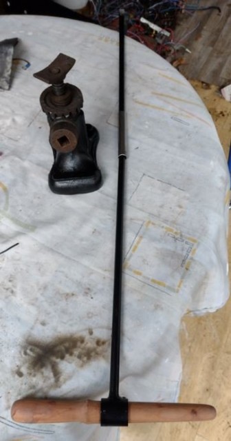

there was one part missing in the toolbox
and really expensive
so i made my own today., tooks me 5 hours for all
and the best
it works perfect as it should work under the car
was a little bit afraid if it is strong enough
all parts found in the cellar
1m 12mm round steel
an old tube, a little bit larger, so i cut it and weld it together
and 2 screws for the junktion
as you see you can fold it like original
I'm thinking about taking some faux leather to line the bottom compartment, but then in black you can barely see anything, let's see if I have gray faux leather

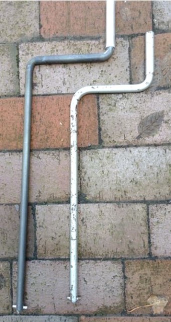

Post by Franz Tenbrock » Sat Feb 26, 2022 12:37 pm
the starting handle was a little too short
Why?
made a new one today, cost me 8 euros
2 weeks ago I ordered non polarity sensitive reverse LEDs
but something went wrong and I got my money back
so I had to order some in England, cost me 35 Euro because tax and shipping are so expensive
doesn't matter
yesterday they arrived and i installed them today
works perfectly

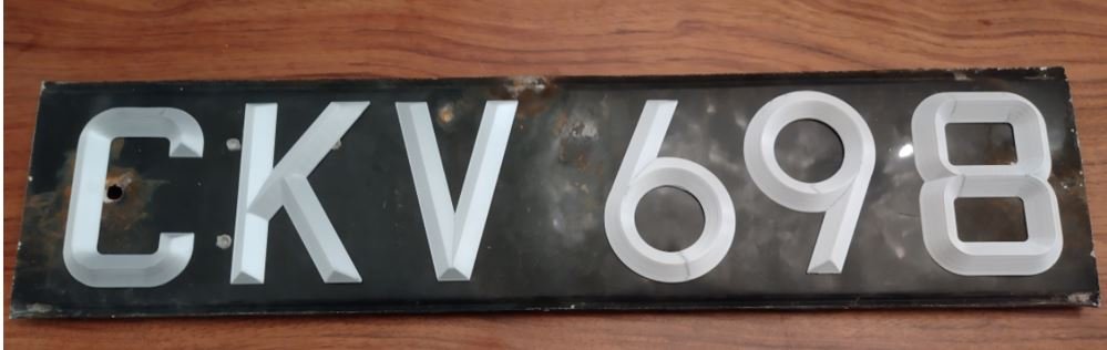

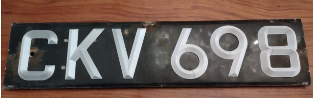

some weeks ago i decided to print original like letters for the original english car number plate of my TA
today i found some time
snow outside
i took my original YA number plate and designed numbers like this plate
print it with my 3d printer and happy now with the result for some cent
i will take a sheet metal paint it black and put the numers on it
so if i on a car show i can took the plate ;-)

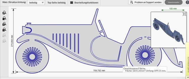

Post by Franz Tenbrock » Wed Apr 06, 2022 3:11 am
after finishing my number plate and some work with freecad
i have a new projekt
if someone wants one , write me ;-)
on the Essen classic car event i sw this here
so i decided
i have to have such a thing too for my garage
first i tried a car from the front, but this one i like more
some work this morning and some help from the forum and it is nearly ready now
Post by Duncan M » Wed Apr 06, 2022 5:48 pm
With the correct 48 spokes on each wheel. Well done!
Posts: 578
Post by Franz Tenbrock » Wed Apr 06, 2022 10:46 pm
you haven t count correctly :lol:
only 24 spokes
more was not possible to make a laser cut
but i think it is ok like this
have to think about how to make the light behind
order will take 2-3 weeks so some time

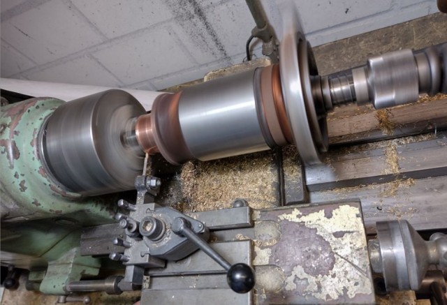

next day the starter doesn t work
one cable of the carbon bush was damaged
found this aber i thought that it is a different problem
if someone has the same problem with the starter the rebuild is here
it is the same starter as the TA, so perhaps interesting:
https://www.mgexp.com/forum/t-series-an ... sg-4499840
now working again
