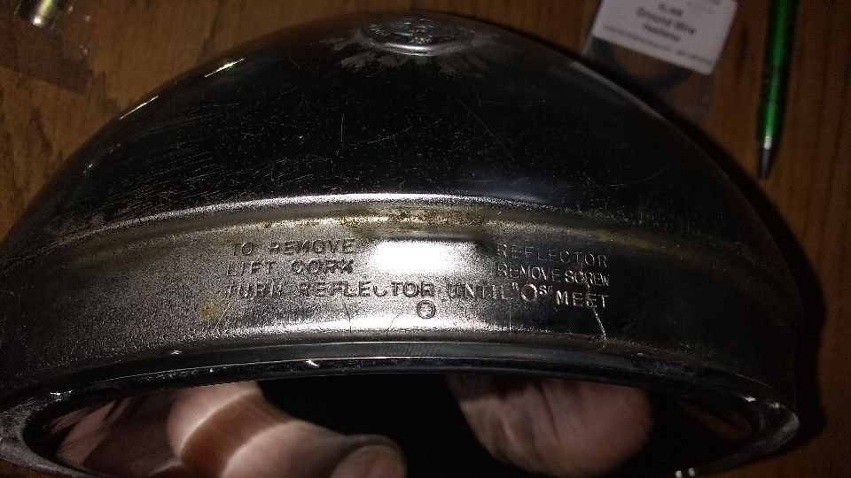

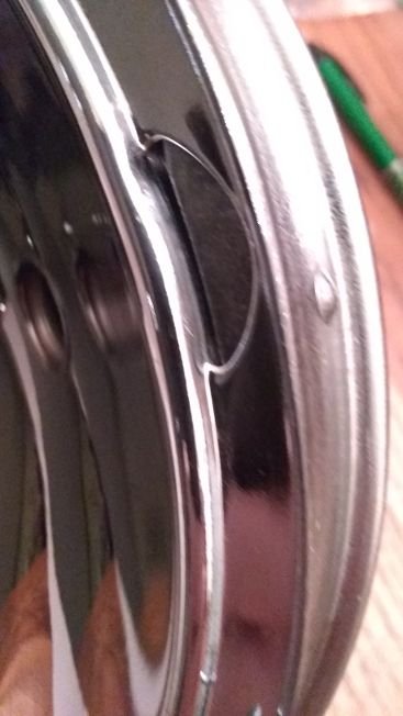

Post by Rob Reilly » Sun Dec 26, 2021 4:15 pm
Success, I very carefully bent down the tabs, and now they grip the edge of the buckets as they were supposed to.
I found that, though brass is flexible, chromium is brittle, it flaked and broke off at the bends of the tabs, but this won't show under the rims.
I think whoever removed these reflectors from their original buckets must have done it by bending the tabs back. He didn't read the instructions stamped in the buckets.
TO REMOVE REFLECTOR LIFT CORK REMOVE SCREW TURN REFLECTOR UNTIL "Os" MEET
There is a letter O stamped at 12 o'clock in the reflector and the bucket.
Now I can confidently take the buckets and rims to the plater.
Here is the correct orientation of the lens, like a letter U, not a croquet hoop.
There is a notch in the bottom of the lens to align with the chrome tab at the bottom of the rim.

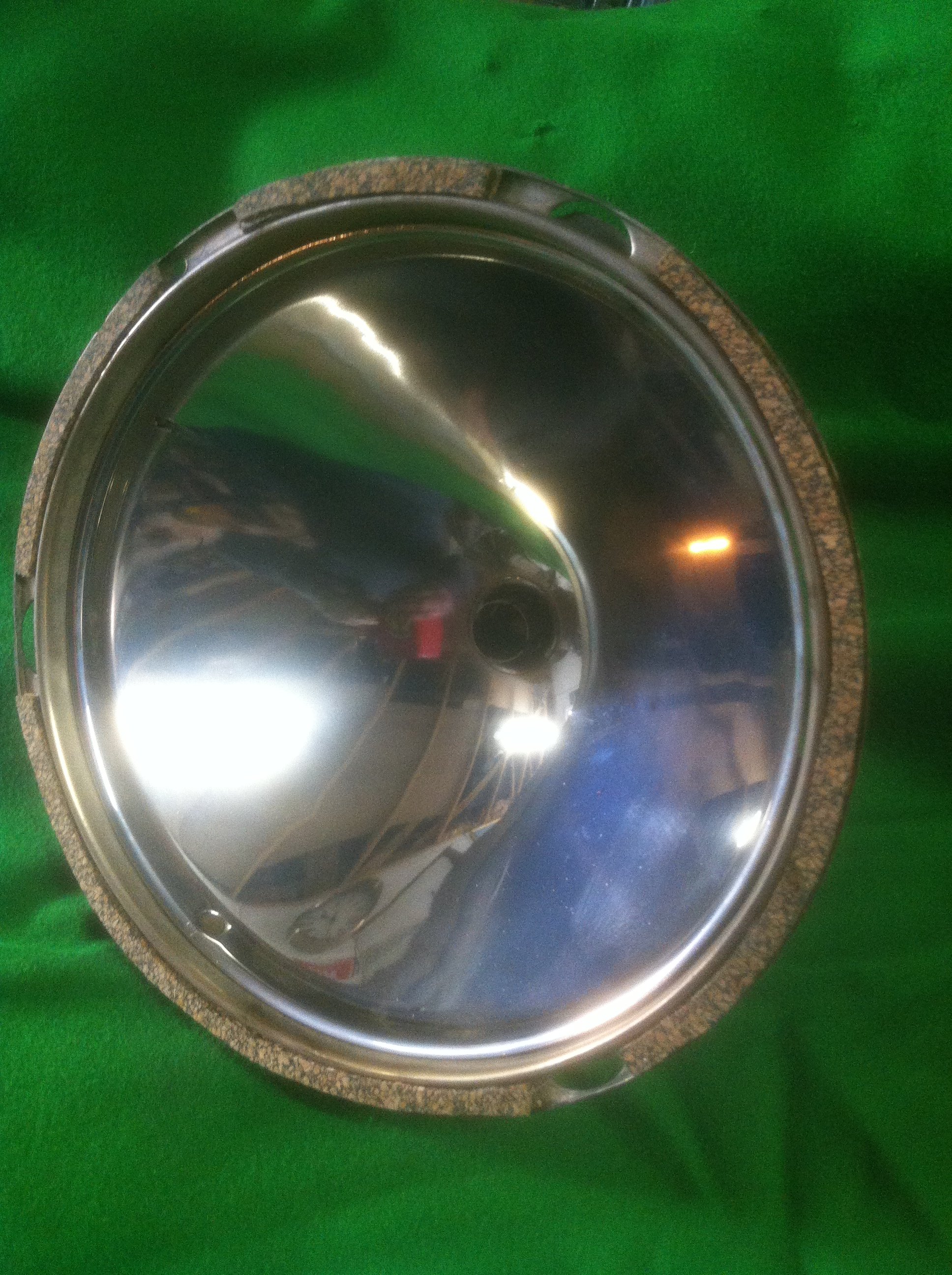

Post by bloodysalmon » Mon Dec 27, 2021 4:25 am
... don't forget to replace with new cork strips! I make mine from a flat piece of cork and cut them in cycles ...

Post by Rob Reilly » Mon Dec 27, 2021 2:58 pm
Yep, Frame Up included cork seals. I got to wondering if there should be a thin rubber seal between the reflector and bucket?
