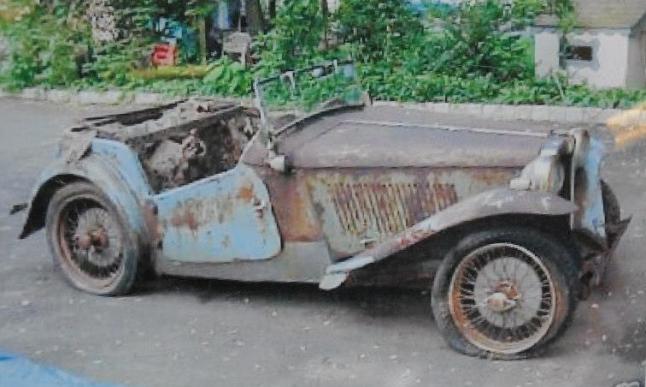

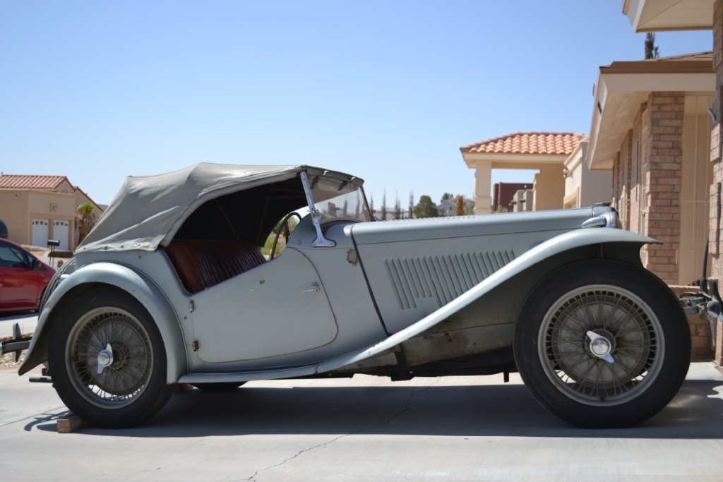

The disks behind the wheels on the TC is a very very rare aftermarket item referred to as the "BEER TRAY". This is the 3rd time I have seen beer trays on a TC in the past 2 months. Other sightings were a Rhode Island Car and California car. Yes it was a period item of the 50's & 60's and almost forgotten.
Jason Len reported that his disks were "Coors Beer Trays" See photos.
