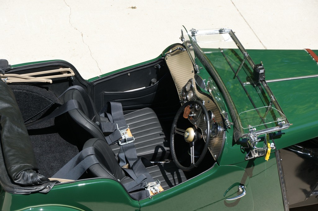

Pictures of my MG TD with Factory Five bucket seats

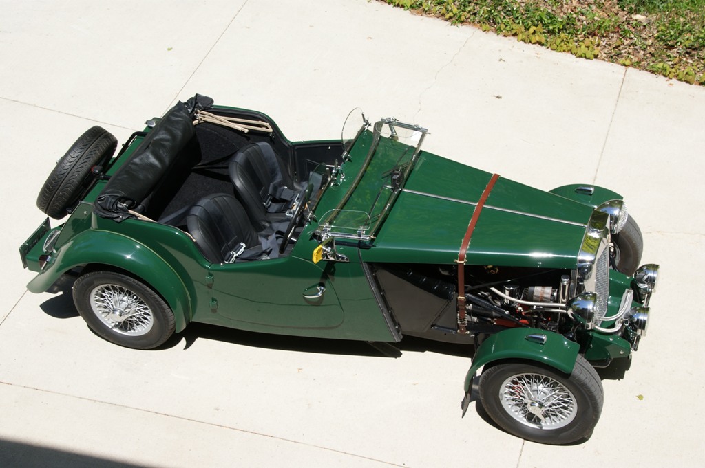

Another photo of the bucket seats

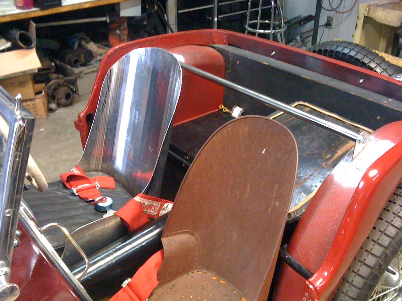

Normans pics of his TD seats show exactly the problem with the TC wheel arch we have been discussing as a problem. My pic 3 from top shows how I was able to cheat a good 3-4 inches out of the wheel arch with the curved back seat bases, and still have a good reclined driving position. Of course the TC wheel arch extends well past the step up for the cargo area behind the seats, while the TD, etc do not.

David- Nice. I have seen this sort of sided/unsided seats, and have been considering doing something similar. I've also seen in various early specials/racers a type of seat similar to these in that the back is rounded, but the aluminum frame has what appears to be a removable/replaceable sort of pad made from regular upholstery materials (and lightly padded) that goes onto the whole width of the shaped upright part of the seat back-- with no covering at all on the back part. And, the seat bottom appears more conventional; or like ours, with a bottom cushion that's removable from the frame (and with a plywood bottom), and when in place locks the seat into position (or where the sliders go.) In the red Lotus seat I show above (perhaps yours, too) the seat bottom plywood actually holds the seat in place with a t-bolt type arrangement going through holes through the floor. Those late '50's Lotus Sports Racers generally have adjustable pedals, but the seats also usually have three sets of holes: normal, close 4 short legs, and as far back as possible 4 very long legs.
