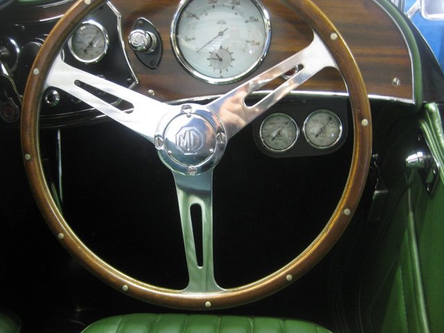

I have both water and oil Temp. gauges now fitted to my TC.
I didn't want to spoil the original dash so chose to mount them in a double accessory plate under the dash to the right of the tacho. ,they are quite visable and I am happy with the instalation.
The water gauge attaches to the radiator top tank at the factory fitting after removing the blanking cap.The oil gauge enters through a drilled sump plug.
Jeff Newey
TC0489
Australia
Jeff Newey
TC0489
Australia

Re: MG TC Water Temperature Gauge
Attached are photos of oil & temp. gauges and fitting into top radiator tank as on TC0489.
Jeff Newey
TC0489
Australia
Jeff Newey
TC0489
Australia

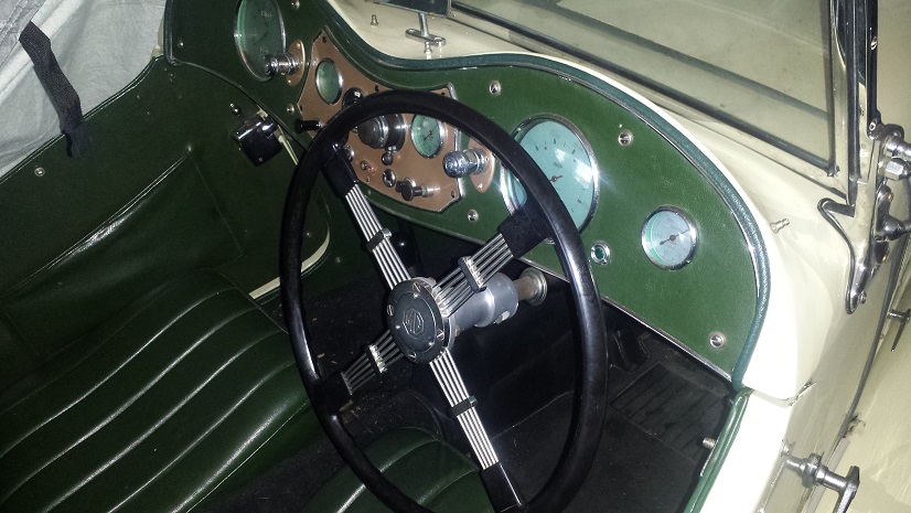

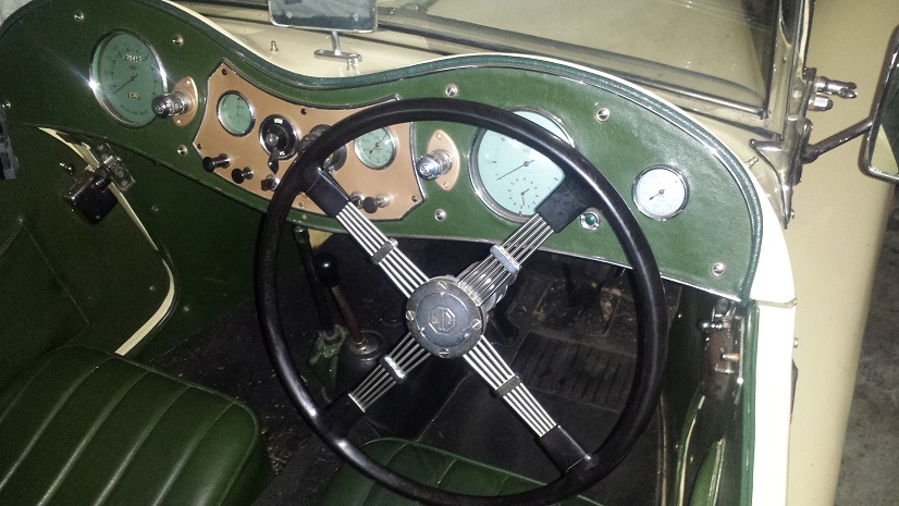

On myTC which is a late 49 model with vinyl dash I ran a straight edge between screws and fitted a guage mid way between screws and places guage at same height as oil guage. Is a green Jaegar type
Looks perfect. One day will wire up a dash light but like hand throttle ,never used. [Come from the Land down Under]
Ive just recieved a new works laptop so most pictures are stored on an external drive so will post one soon.
At least with a vinyl dash can be recovered but think mine looks as meant to be and dont like the thought of hanging under dash as was other black rusty Smiths one but would be a shame to drill into a nice walnut type.
The car is over 60 yrs old so anything done to it is it,s history just like wrinkles [crows feet in paint ]
Ive just fitted a fog lamp on the front now that is off a y type and except that it is 1/2 inch bigger no one can really tell and got it for a fraction of the price original size ones are selling for.
I suppose just depends how exact one wants to aim for but remember that lots of modifications were common after these cars were new.
Good luck and try and sleep easy Ian.
hi Ian,not sure if previous message actualy sent so here is a picture of dash just incase.
