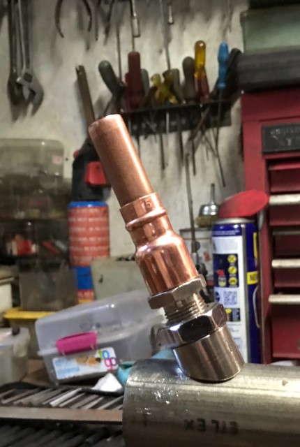

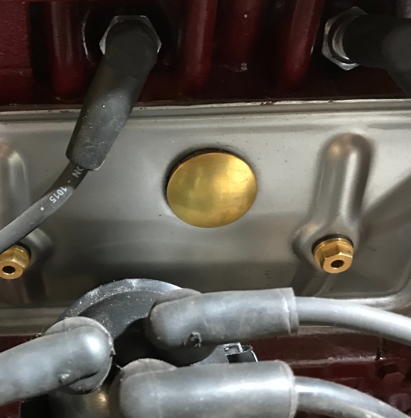

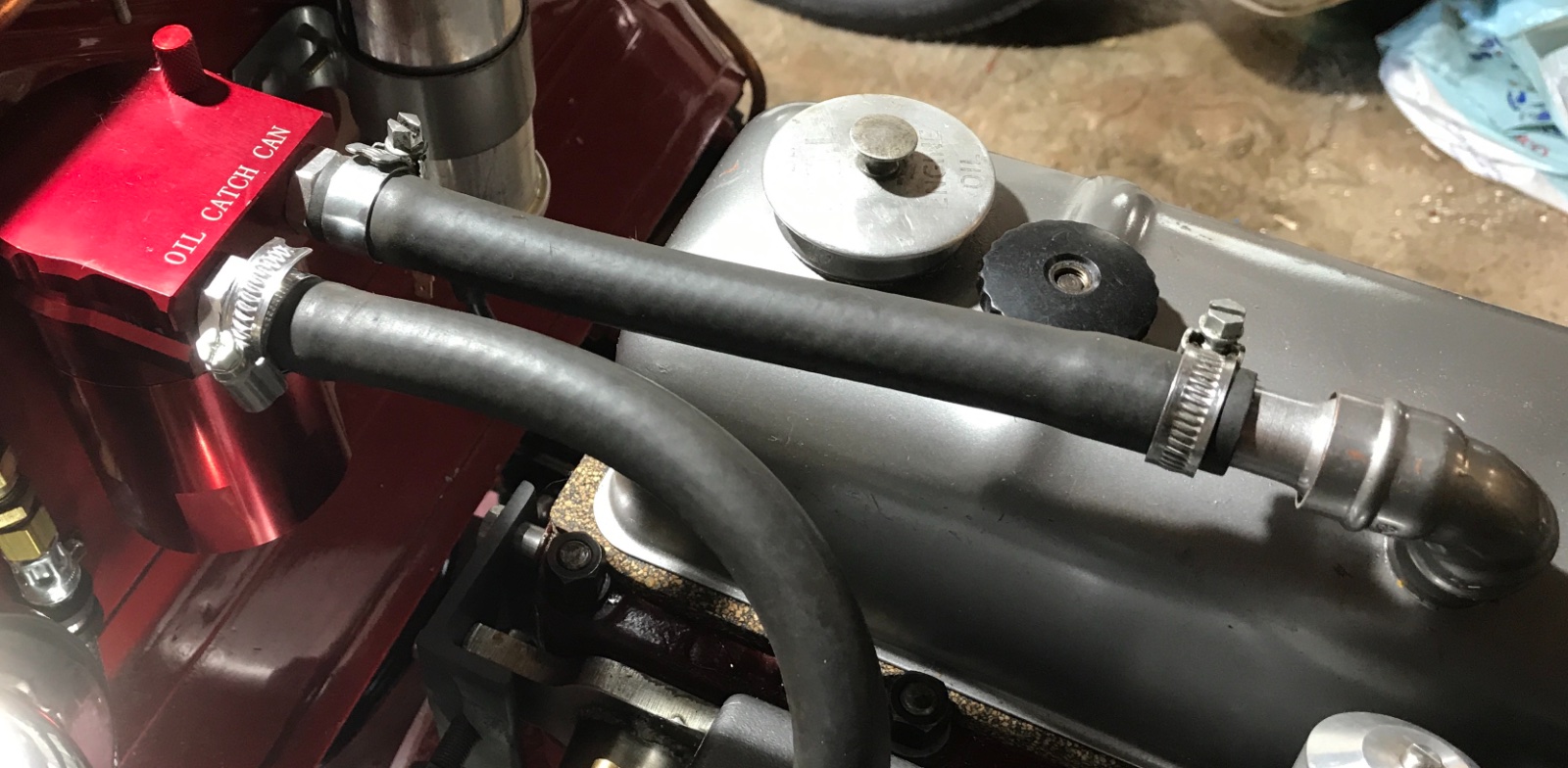

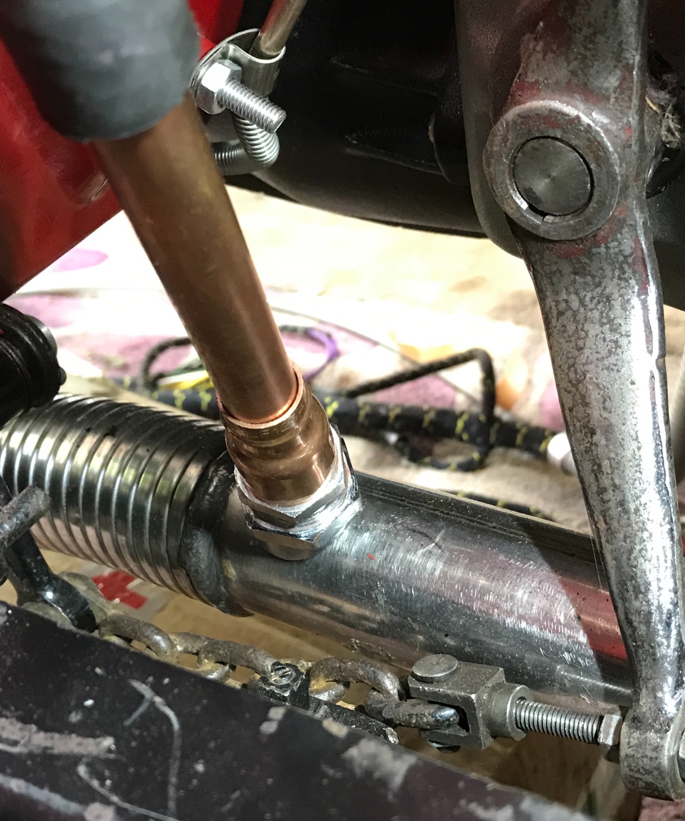

Thank you Lindi. I have also fitted an extractor manifold. It required a lot of fettling to get the supercharger and the exhaust manifold ports to line up.! The entire exhaust system is now stainless steel so I am aware that I could have heat and noise issues but I will cross that bridge when I come to it. I have numerous other refinements such as a shaped and ported cylinder head with TF valves and hardened seats.
One little extra item that I have fitted is an exhaust vacuum crankcase ventilation system. There is a scavenger unit fitted to the exhaust just ahead of the silencer. Any blow by exacerbated by the supercharger will be extracted via a pipe attached to the rocker cover vent. There is a catch can to collect and separate any oil from the fumes as they are drawn down to the exhaust via a non return valve. This system is hopefully an improvement on the original road draft tube - which has been removed. These modifications may add a little extra power...we shall see!
(This idea is similar to the modern pcv valve which does not work well with forced induction.)

Ray, Your setup sounds intriguing. I for one would appreciate some pictures if that is possible without to much of a problem.

Post by Ray White » Mon Aug 24, 2020 6:19 am
Posts: 629
Re: 5 Speed gearbox
Post by Ray White » Mon Aug 24, 2020 6:34 am
Posts: 629
Re: 5 Speed gearbox
Post by Ray White » Mon Aug 24, 2020 6:37 am
Posts: 629
Re: 5 Speed gearbox
Post by Ray White » Mon Aug 24, 2020 6:53 am
Photo 1 was taken at the experimental stage.
I had to considerably alter the scavenger unit to achieve the correct angle and make it secure. I just hope the theory works in practice. I believe it should pull about 4HG but until I am further on with the build I won't know for sure. I got the idea from another T type owner who fitted a similar set up to stop oil leaks from the crank case. In his case it worked and he has had no leaks since.
The catch can has a dip stick to keep an eye on any oil deposited. I have added an additional baffle to make it more efficient. There is a stainless steel one way valve in the line which is made from reinforced rubber tubing and the original draft tube has been replaced with a vent which can be gradually blocked off as required. The only other entry point is the filler cap and I have been assured that this will not be a problem - but if it is then I shall have to replace it with a cap containing a one way vent.
