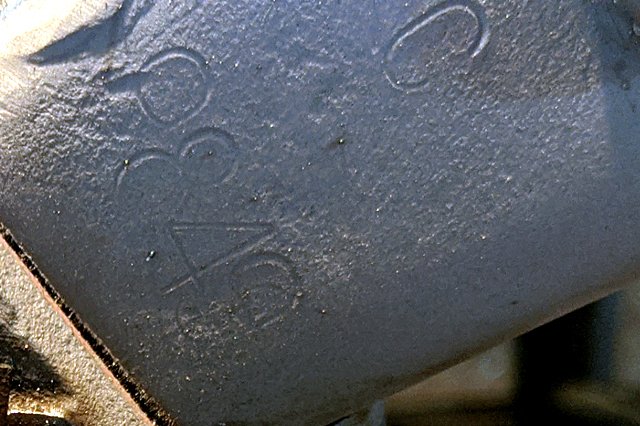

Hi Bob, congratulations on the TC purchase!
As you probably know, the frame number is stamped on the left front iron. They can be very hard to see sometimes, especially under thick paint or if they have been heavily sandblasted. If you plan to restore the whole car anyway, I would suggest stripping the paint in that area to search for the stamping. Unfortunately the body number cannot be used to determine chassis number that I'm aware of. If it has the original engine, you could cross reference that. But it would be tough to say if that was the original engine or not. You could verify if you have an early or late TC by the frame reinforcing gussets, but it wouldn't tell you the car number.
Here is what they will (should) look like when you get the paint off...
- TC Chassis Number
- chassis-numbers.jpg (71.43 KiB) Viewed 4822 times

I'm not aware of any replacement frames being made, so I bet it's just really faint. Maybe the new kid was doing it on a Friday and didn't hit the stamps with the hammer hard enough.
On the engine, the easiest way to spot a TD engine is by looking on the right side, forward of the starter. The water tap is just forward of the starter on a TC, and all the way at the front on a TD. Also there is a raised square section meant for the TD number plate in the same area, where the TC has nothing there. Sometimes the plate is moved to the bell housing on a TD engine to make it appear more TC, but the raised square is cast in and not removable without a die grinder.

After disassembly of the car I was able to find the serial number. It was hidden by a shock absorber that was bolted over it. It was a aftermarket shock that was modified to fit car. Number is TC 6344. Glad I found it Thanks all for your help
