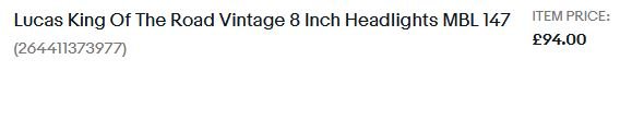

Post by Franz Tenbrock » Mon May 24, 2021 11:51 am
i love ebay, auction
in 2019 i got damaged headlamps with stoneguards
less 100 pound , a perfect deal for me
some work and all parts could be installed
i love it like this, here some pictures
viewtopic.php?f=2&t=928&start=120

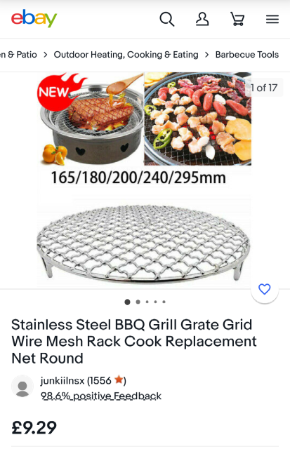

Post by Johnnym » Tue Apr 19, 2022 8:39 am
I know this thread is nearly a year old, but this was my solution. They are exactly the right size and all I have to do now is create attachments. https://www.ebay.co.uk/itm/-/363587607577
1946 MG TC, south coast UK
Posts: 2783
Re: TC headlight stone guards
Post by Steve Simmons » Tue Apr 19, 2022 8:47 am
That right there, is the most creative solution I've ever seen. Well done!
