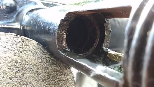

I had been thinking this spring mounting shaft might be a solid bar with a counterbored end, but looking at the round bearing surface it looked too smooth to be counterbored, so I concluded it must be a separate piece. And if a separate piece, the only reason to make it a press fit would be to prevent grease getting in there. But it's a small space relative to the large space around the spring leaf, so I concluded it was not a press fit, just stuck with rust.

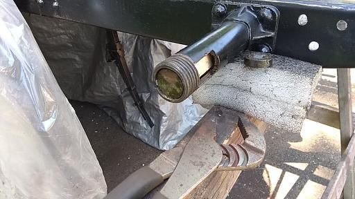

There was about 1/16" sticking out, just enough that I could get the tips of some channel locks on it. I squirted some penetrating oil in there, wiggled it with the channel locks, and after a little while got one out.
The cross tube is hollow all the way through, looks like probably all one piece, with a couple of small pins sticking up inside that are probably to locate the inboard rivet flanges for brazing. I stuck a long piece of wood through and knocked out the other end plug with a few taps of the hammer.

- View of counterbored step.
- IMG_20210604_140315702.jpg (36.27 KiB) Viewed 2070 times
- The channel locks and wood plug poker.
- IMG_20210604_140253039.jpg (36.77 KiB) Viewed 2070 times
