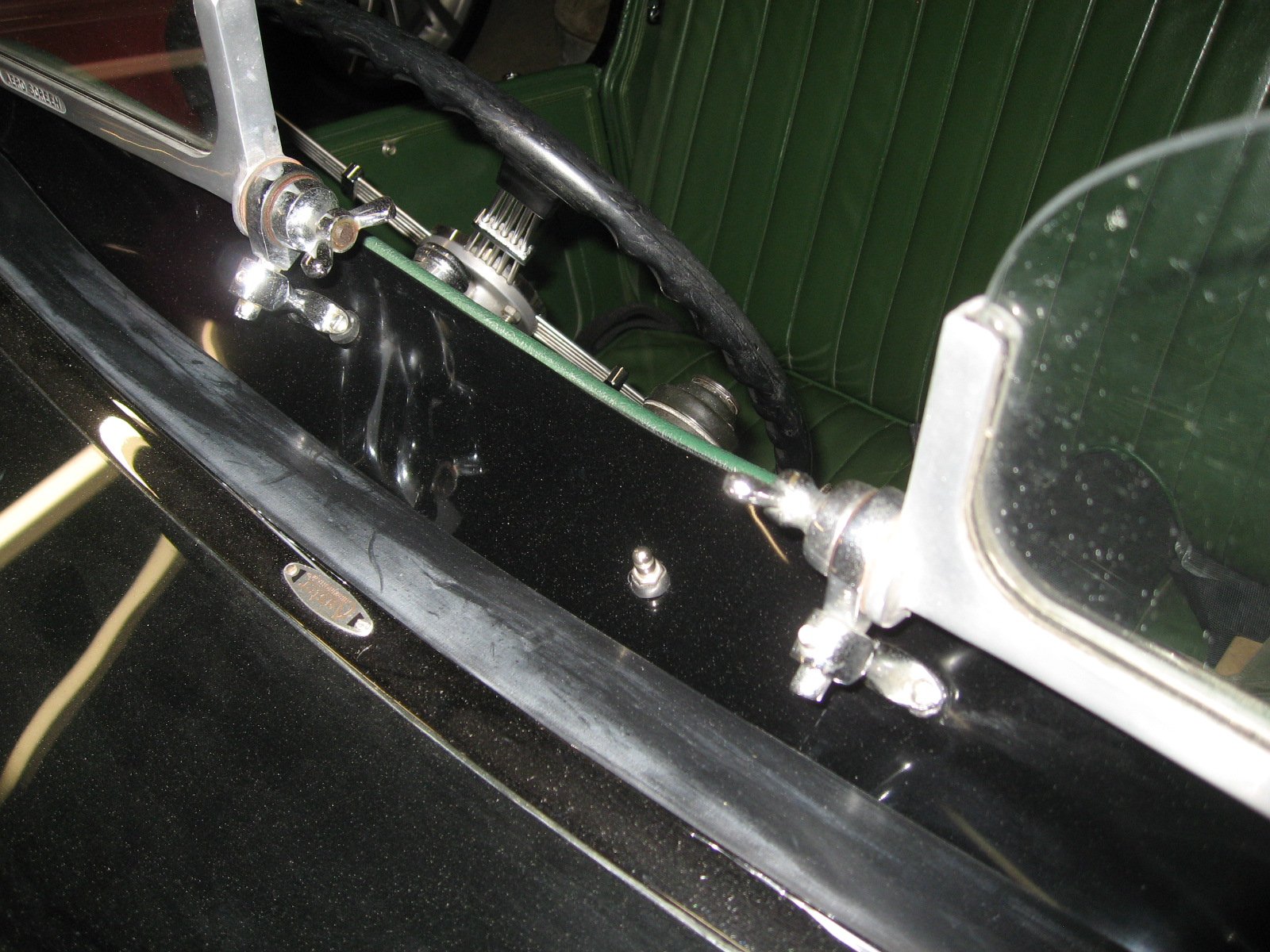

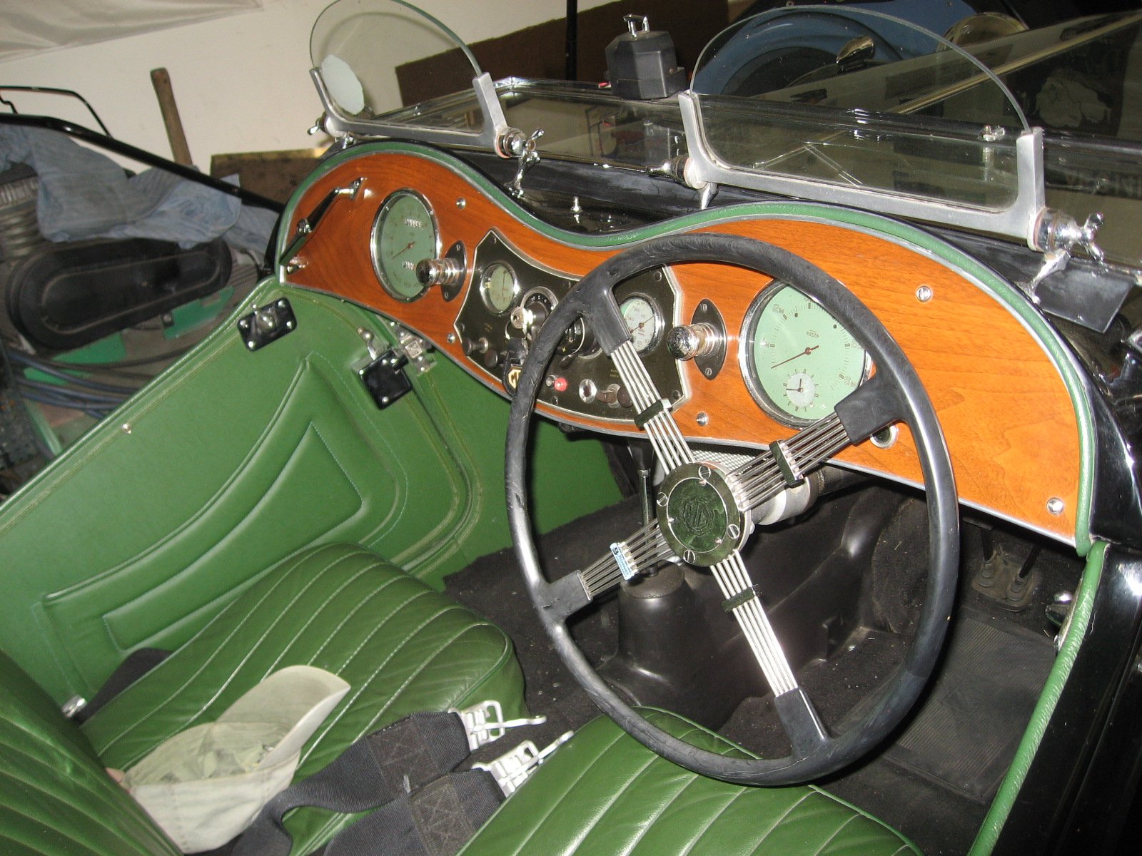

Re: Brooklands screens
Post by stephen stierman » Sun Jun 06, 2021 2:05 am
The screens are easily mounted to the cowl without problem and look proper. Why would you do it any other way??

Post by Ray White » Sun Jun 06, 2021 7:28 am
I see you also have a Brooklands steering wheel. The two things compliment each other nicely.
Post by stephen stierman » Sun Jun 06, 2021 10:14 am
Thanks, I love those screens, the only time the windshield is up is when to top is up!
Post by stephen stierman » Wed Jun 09, 2021 4:20 pm
Mine say AERO SCREEN on them and I bought them used on eBay. Alloy frame and chromed fittings they are very adjustable and when mounted properly the windscreen can be raised without interference. I only raise the screen when the top goes up and don't mind looking through two pieces of glass. The passenger side screen needs to be tilted inward a bit to clear the wiper motor.
