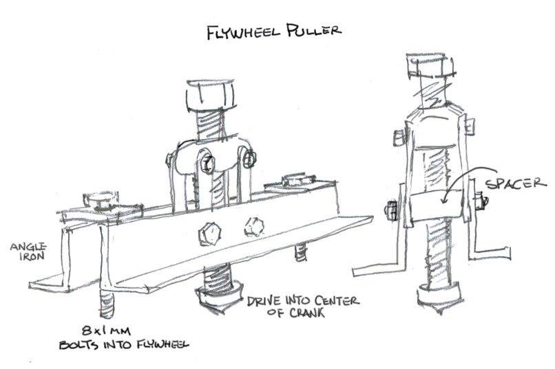

My MPJG flywheel didn’t want to come off either. I can’t remember exactly, but I may have had the spigot bearing removed when I used a puller. I fashioned it from two pieces of angle iron, a couple of spacers (copper pipe) and a re-configured puller from a Harbor Freight set. I used a copper hammer on the end of the puller-bolt often to help it release.
If you can’t remove the spigot bearing then use something inside it to build it out so the puller has something pressing against the flywheel.
This is assuming you have already removed the 4 flywheel bolts. My aligning pins came out easily enough, still stuck in the flywheel, using that puller.
