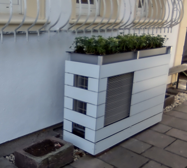

last october i got a heat pump for our house
not a really good looking thing
a colour i don t like
got a dibond plate for a really good price
one side white the other silver.
some alu tube from the web and some screws
some epoxy bond and 2 days from my holiday
my cellar is full of mechanica tools so i made a cover for it
white dibond and behind the silver dibond side
above some plants
my wife was so happy for it so she asked me to make a cover for our trash
so i have to buy some more dibond, also i will make a cover for my work table in my MG garage
if it is clean in the garage i can make better work

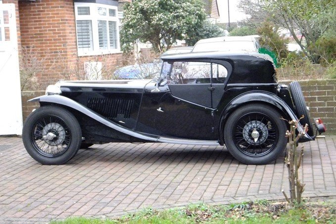

Hello
you know i am crazy
sitting on vacation at the north sea i was surfing around looking for Mg Tcs pictures
i found this one
https://ttypes.org/a-summer-and-winter-td-redux/
this is the only one i like
the style looks perfect on the car
the only thing that could be better is the side window in the back, it should be possible to slide it back in the hardtop
made a surfboard out of epoxy GRP 40 years ago
infected with this idea
you like it too ??

yes,
I like it toooooooooo

Your opinion is soooooooo important to me
I hope you know that
i have a friend with a lot of experience in making gfk things
i will ask him to help me, have an idea how i can make it,
some wood some styropor for a template ...

I too think it looks great. Really suits the styling of the TC!Franz Tenbrock wrote: ↑Sun Oct 01, 2023 11:29 pmHello

Whilst I too think that the TC with the hardtop looks great I wonder if the owner/driver is quite short. Driving hood down makes entry and exit so much easier for a 6 foot oldy. I wonder how attachment at the rear was arranged?

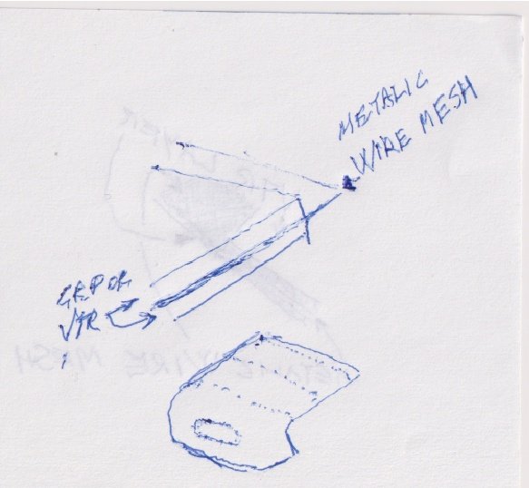

A lot of years ago one of My friends built a car body with VTR and WIRE MESH with good resultsFranz Tenbrock wrote: ↑Sun Oct 01, 2023 11:29 pmHello

I do not know the duration in the time !!
you need also one WOOD 1 to 1 model of the Hard Top (NOT easy to do)where you place the Wire Mesh
NOTE it must be covered by a NOT ADHESIVE protective paint If you have built a surf table sure know this particular
then you must cover it with VTR -GRP2 components plaster (min 6 mm THICK) when all is dray and solid must be reversed
and the same operation must be made to the interior-probably less thickness
and I presume that the interior must be reinforced by wood
at the perimeter and rear window + 2 or 3 centine or traverse
A lot of work will be needed to level and sand the surfaces for the successive painting

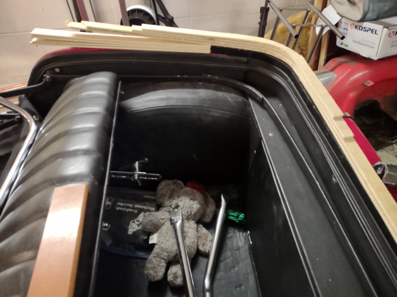

Re: MG TA1932 in Germany - Blog - all problems and ...
Hello
at the moment I am busy with the home electrics and smart home as it rains often outside
i will not make a form, because i don't want to start a production
i will wrap the car with foil to protect it
then I will make the mold for my hardtop with styrodur and wood, on top of it I will apply foil and release agent again, on top of it I will process the fiberglass with epoxy
and then hopefully I can separate everything again.
but that will only work when my son finally gets his Ur Mini out of the basement garage, which had some rust and on my small lifting platform he could work better there
but since he has just got engaged, there is probably not enough time.
End of November he must be out, the Ta then needs the space

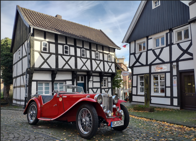

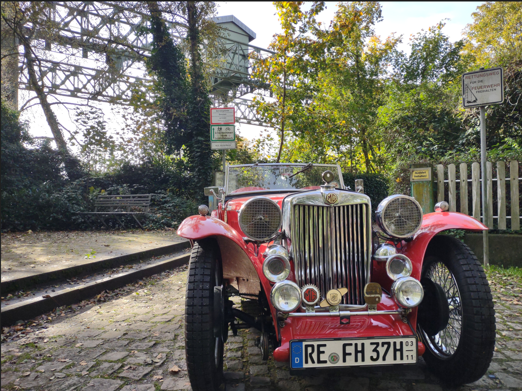

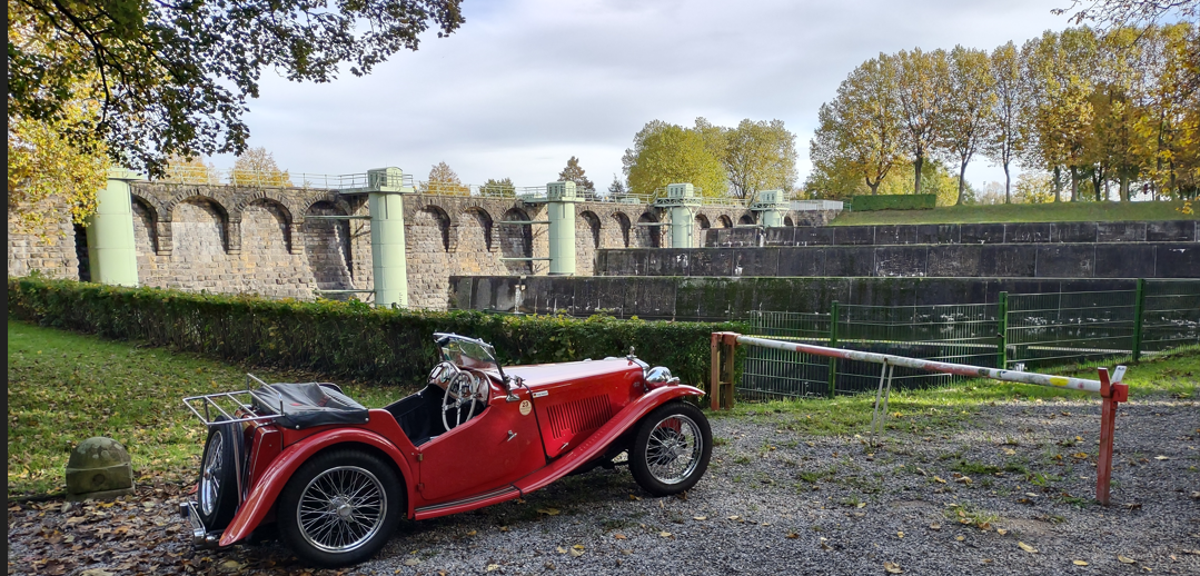

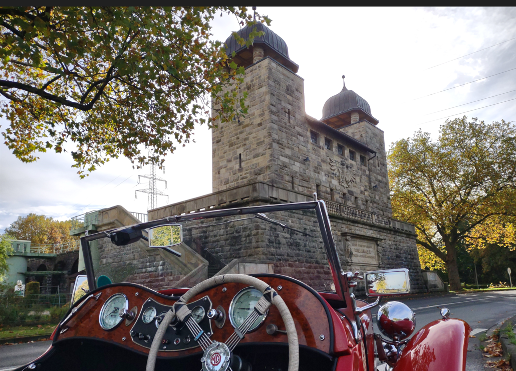

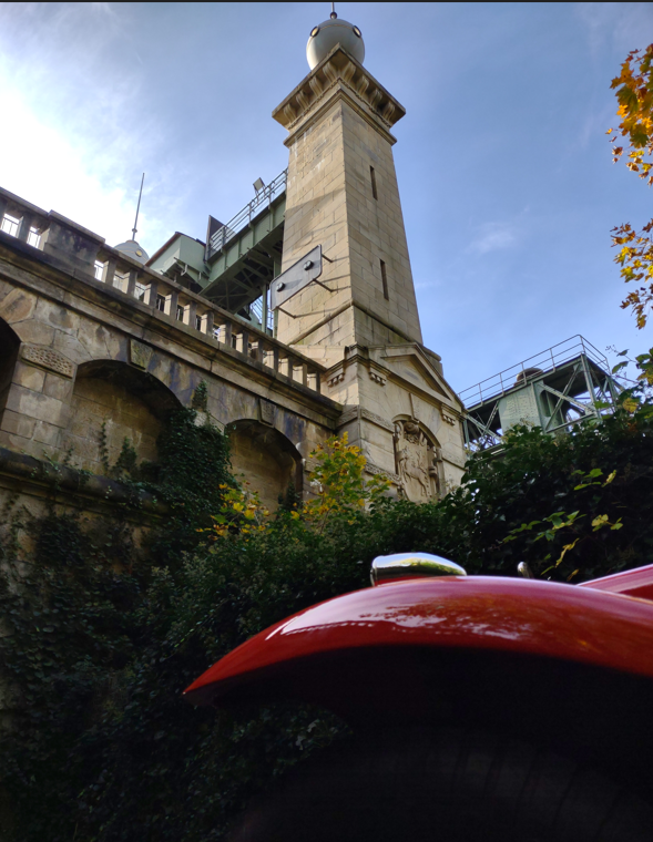

perfect weather today
12 Grad outside, no rain
took the car vor a 90 min drive aroud the town
making a little picture session
what you like most ?
the car is running perfect, starts with the first pull, runs straight forward, brakes as it should and so on
realy happy with the car now

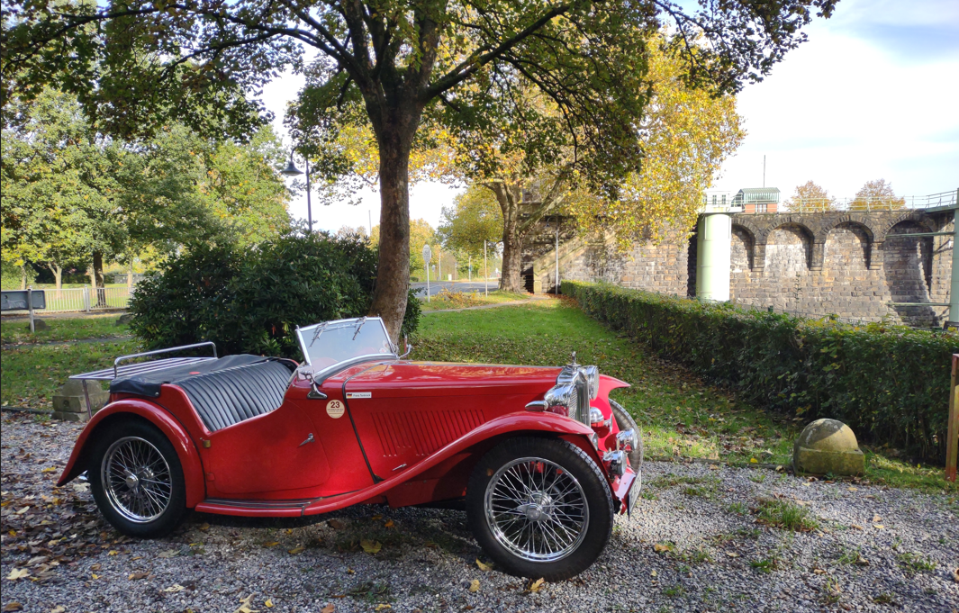

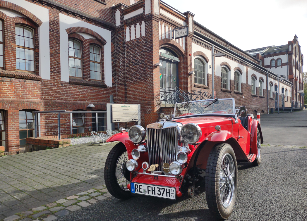

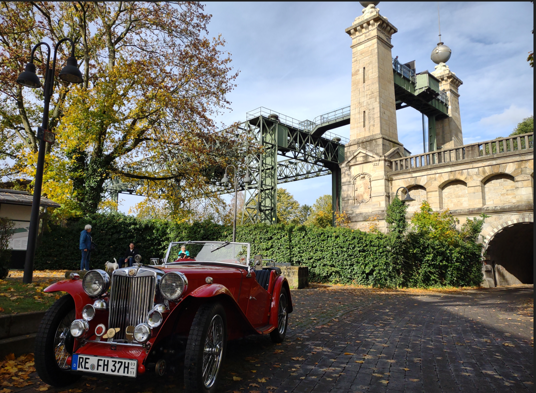

and some more
last pictures before i start with the hardtop in December

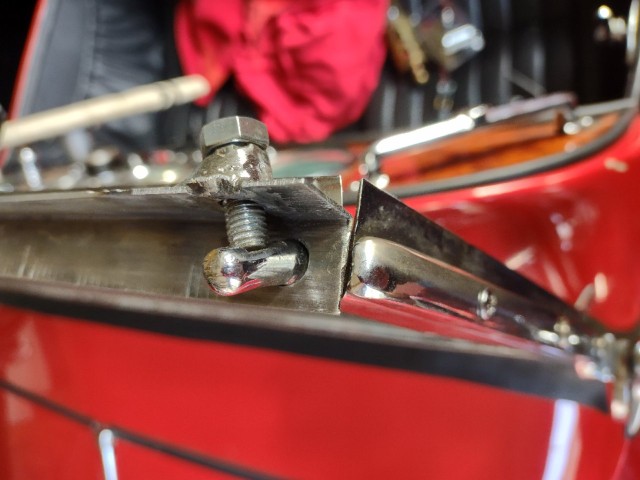

since it is constantly raining here, I decided to start building my hardtop today
it will be a new challenge for me
i can't get the wood i wanted to buy
so i changed a little bit
first i made a metal part
on both sides i have welded a nut on the metal bracket, about 80 degrees to the middle
so I can later attach the hardtop here to the windshield frame, just like the fabric roof.
with a roller tool that I got as a gift years ago, I was able to machine the metal bracket so that it follows the curvature of the windshield frame.
With the shrinker and strechter i had to make some little changes because the roller twisted the part

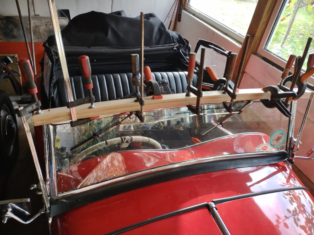

The next step is to make a wooden part at the top of the windshield
at first I wanted to make it from one piece
bend it with hot steam
but I couldn't find the right material here
so I took beech 40 x 9 mm
three parts glued together with waterproof wood glue
at the end I will fix it with 4 wood screws
I will glue the metal part to the wooden part with epoxy and secure it with wood screws
have to think about it what i will take in the back

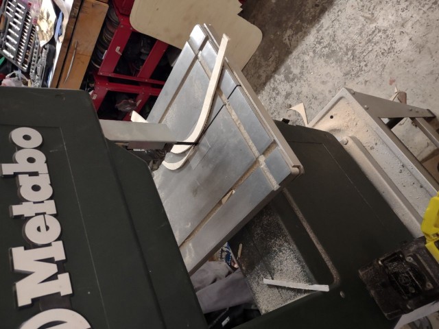

after thinking a bit i decided to glue some plywood together
as you see its curved and not straight
so 5 pices glued together with some funny weight to press it
first try
with my bandsaw i cut some more parts, will glue them also together tomorrow when the first part is dry
first try
