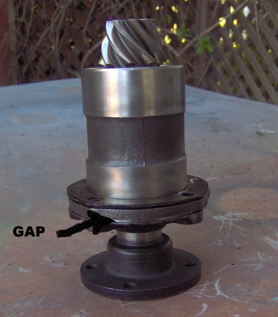

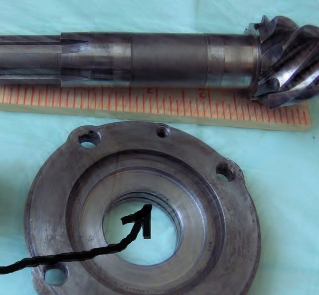

#34 should be screws. The carrier all comes out as a unit. Cannot just replace cap/seal without removing the whole unit.
The pinion bearings are a maintenance item, and when using the original scroll seal cap one of the first symptoms of worn bearings would be notable leaking past the cap "seal."
A pic of the carrier ready to go back in, and a pic of the 74 year old scroll seal still in good condition, because the bearings never got bad enough to cause the rotating parts to wipe out the scrolls.

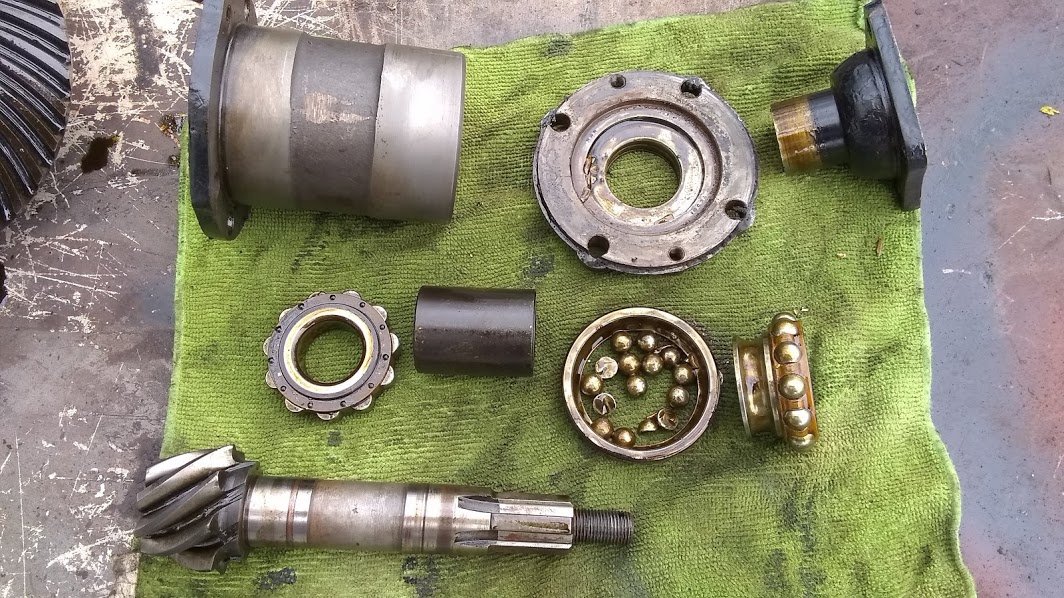

My TA diff also has screws to jack it apart.
Unfortunately not so lucky on the ball bearings. Cage destroyed and a couple of the balls split in halves.
Re: guide pins for Moss dif pinion cap
Post by Steve Simmons » Sun Nov 12, 2023 10:19 am
Looks like bronze bearing cages, as was original. They are known to do that when they get old. My last project TC came with the same issue, and unfortunately it had blown the diff apart. The gears and central housing were all wrecked.
