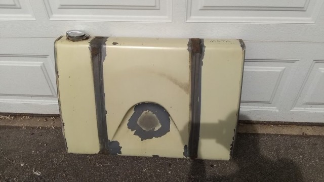

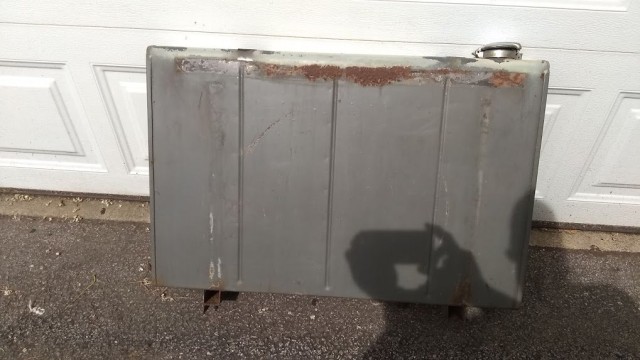

Re: ‘48 MG TC
Post by Rob Reilly » Sat Dec 16, 2023 12:30 pm
A more revealing answer might be found with some of the body panels.
Like this gas tank. Resprayed cream, but original gray in the hidden places.
One of the British T-Type registries can maybe tell you the original color.
