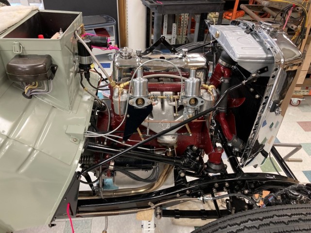

I'm now restoring my SU carbs. For some reason, the fuel overflow pipes have been cut very short. What are the correct lengths of these pipes please and does anyone have a picture of the original routing as there seems to be a lot of variation.

Hi Steve, good to see you are sorting your carbs. Note that the replacement pipes from the Octagon are 30" long. There may have been a specific route originally, but you may wish to consider it may not have been the best route! After all, they can expel petrol right onto the exhaust pipe, which to me seems somewhat risky. So i take the thought to try avoid it dripping anywhere near the pipe. Saying that, its not that easy to choose an alternative route and exit point other than to the front l/h of the engine mounting area! There's perhaps a safer option to try to get the end of the pipe to exit further outboard :?

The routing is down, then forward to meet the front pipe, then both continue down the front face of the engine plate where they are secured by a clip. Escaping fuel ends up on the ground in front of the engine.
The length doesn't really matter so long as it reaches below the bottom of that plate.
Edit: Tom's photo below is so much better than my description!

Here's how overflow pipes were done originally on TCs. This is on TC0279, one of mine.

Mine run similarly, discharging in the region of the front engine mount.......

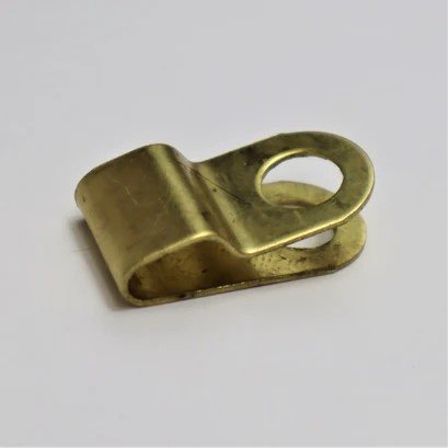

I've wondered if there should be a clip attaching to some part of the engine anchoring the ends of the pipe to stop them flapping about? At the moment mine are clamped together with a cable tie.

Clip on the front engine mounting plate, held in place by one of the bolts attaching the plate to the block, on the carb side, lower area, holds the carb overflow pipe ends in place.
Part number CL070 at From the Frame Up. The clip offered at Moss Motors is incorrect.
