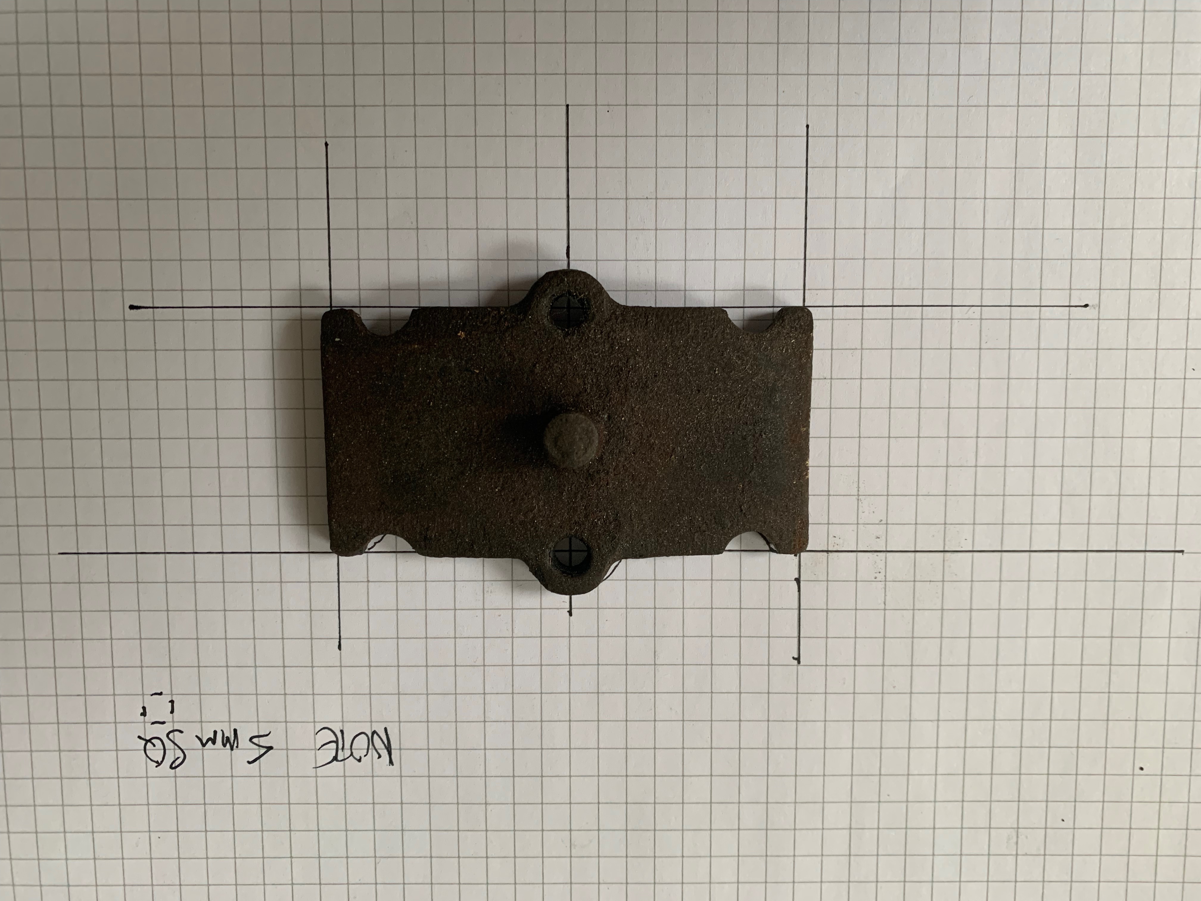

Hi hope this helps it’s off my 1937 TA , I thought I had one with the studs in but can’t find it ,
1/4” looks about right there’s a slight chamfer looking down the length !
Sorry hopeless with modern technology
The pen lines are actually the real size !
5MM SQUARES!!!!

Thanks to all those who replied. Yes the bottom plate is a good template and I had guessed at 1/4 inch so now I can proceed. I'll drill the center recessed hole all the way thru and turn a button with stud on it for the centering device.
