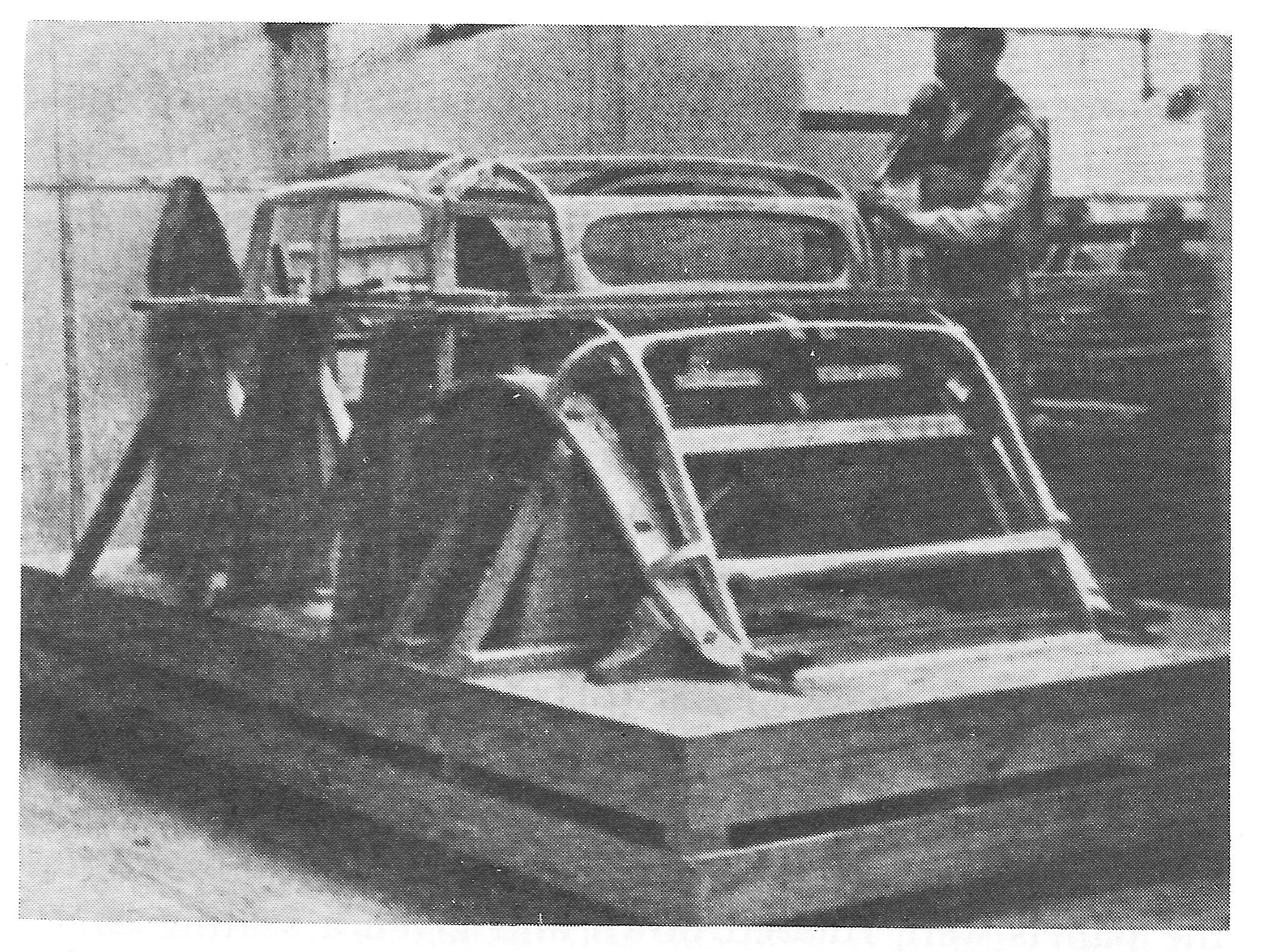

Be sure all the timber parts you buy are really for the right model. Four of the parts I bought from FTFU for TA turned out to be for TC; they were not marked in any way, just slightly different so a stockpicker can't tell them apart, but sure wouldn't fit together.
Today I discovered a defect with the hinge pillars from Hutson. They are pre-notched for the door hinges, the exact width to fit the hinge, but one side the spacing from top to top of the notches is 7-7/16" where the other side is 7-9/16". The doors are both 7-9/16".
Seems like you have to trial fit every piece with a lot of clamps before screwing anything together.
I bet the factory guys at Morris Bodies had some sort of assembly jig with clamps everywhere.
Like this one at SS Cars.
Re: Best Timber Parts
Now that's a jig!

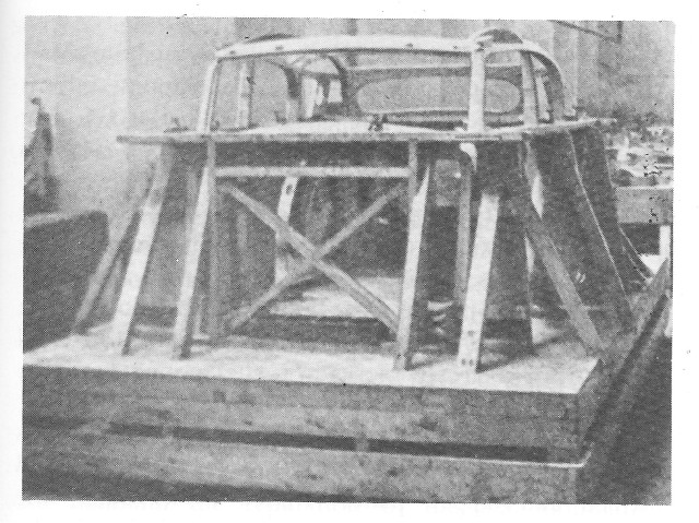

Here is another shot of that body jig at SS Cars circa 1936. SS Cars was formerly Swallow Coachbuilding, putting stylish bodies on other people's chassis such as Austin and Standard but never MG. Here they are building a "coachbuilt" 4 door saloon, their first model to carry the model name Jaguar.
