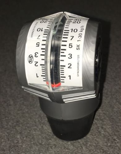

I've found the Uni-Syn to be a little flaky / finicky sometimes. I prefer the "snail" type. It's very accurate and no adjustments are ever necessary. Mine is similar to the one below.

I haven't seen erratic readings because of the type of tool, but I've had some of them where the disc couldn't be adjusted properly, and I had a couple where the plastic tube cracked when it got old. The other type is easier to use and more accurate in my experience.

Hmmm, not sure really but they do essentially the same thing just with a different reading. The snail type, or at least the one I have, has a bit of damping to it so the reading changes just a little slower than the Unisyn. That might be a disadvantage for the test you describe.

Yeah that's what I mean, the other tool I have reacts slowly, so if the airflow was erratic then it might not show up as well as on the Unisyn, which reacts very quickly.
