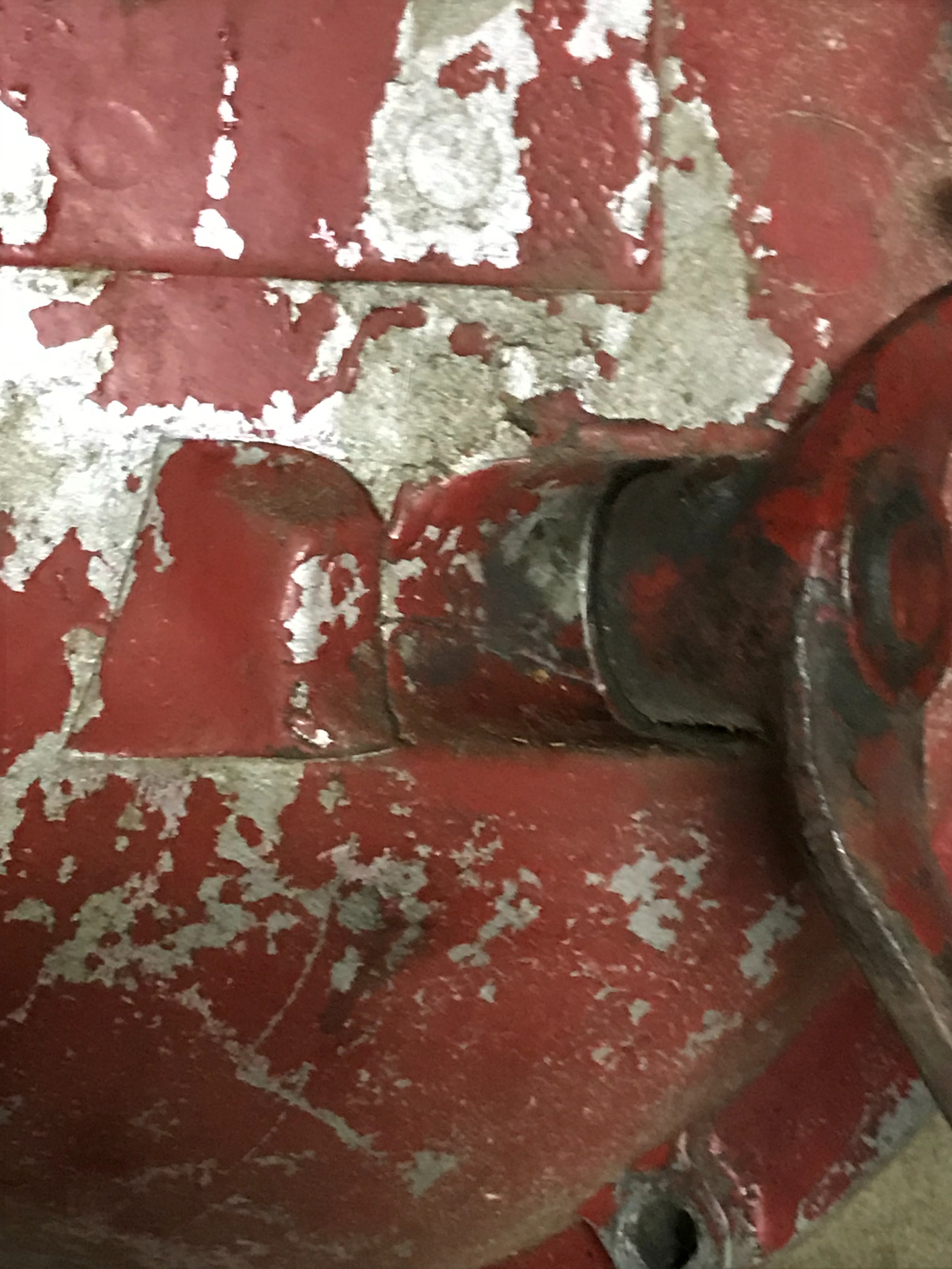

Just curious. One image shows a TC bell housing as I remember most, with a hollow behind the clutch shaft. The other shows a much stronger casting behind the shaft. It is the only one I can remember seeing like that. Was that stronger style standard on late TCs or was it an improved replacement part, modified due to a slight weakness in the original design? Any ideas?

Your upper picture shows a TC bell housing and the lower a later TD/TF unit. Certainly the clutch cross shaft boss on the TC was a notorious weak spot with many of them cracking in service - as the one in your picture appears to have done. Mine suffered the same fate and was subsequently repaired and beefed up with weld.
I don't know if the later design was intended to overcome this weakness, but it would certainly have helped.

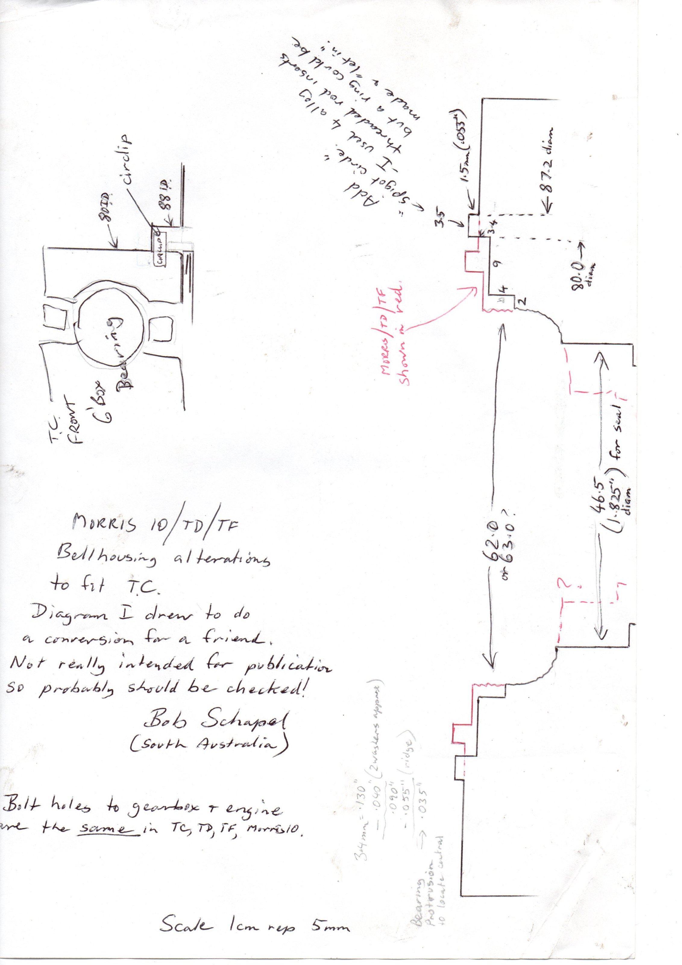

Yes, TC and TD housings are different because the machining to match the gearbox is different. However, a TD/TF/Y housing can be altered to suit a TC. I have altered two Morris 10 housings (same as early TD/Y) myself, but not the one in question.
For interest, I have attached the (rough) drawing I made when I modified one for a friend, whose TC housing had been horribly hacked.

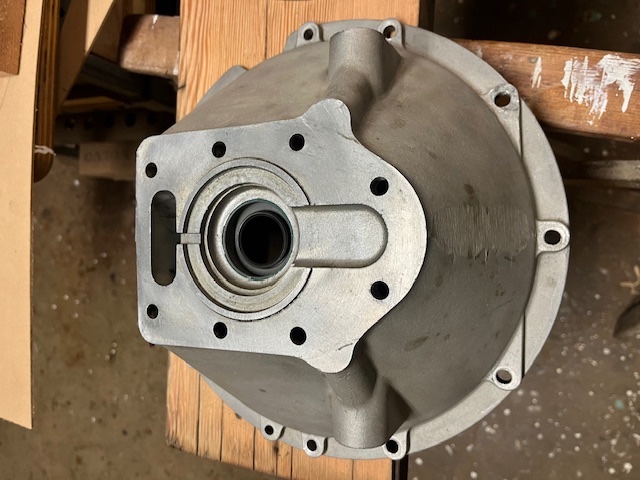

Post by Simon Sadubin » Fri May 17, 2024 12:36 am
Hi Bob,
I recently purchased a spare bell housing for my MGTC - because the original was cracked in the usual place where the clutch fork bush passes through the side. It was also cracked around the edge of the oil seal recess.
When the replacement turned up I was concerned that it was the wrong part because at first glance it looked identical to the later TD/TF reinforced bell housing. But I've measured it up and sure enough it has the right size cutouts and retaining ring for the TC input shaft bearings and has clearly been made this way not modified so it was manufactured for a TC.
I think that you are right that these bell housings may have been made as replacements after the TC production finished using the later improved and strengthened TD pattern as a basis but machined for the TC gearbox at the factory.

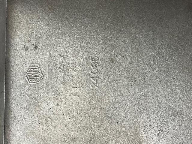

The part number cast on the side is 24085 the brand marking is PBM in a hexagon. I wonder if the TD/TF bell housings are the same brand but have a different part numbers ?
