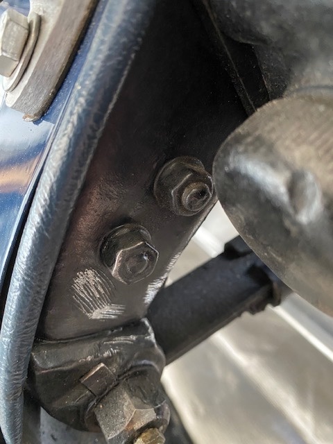

Below see a picture of the near-side dumb iron on my 1949 MG TC. Please ignore my horrible initial (and impatient) attempts today to remove the paint to try to see if there was a ID stamp. Turns out a wire brush in a cordless drill is a terrible idea, especially on POR-15 paint. All I did is scratch/gouge everything up.
I need to take another picture of the inside of the frame to better inform all of you regarding my question, but it seems that the eyelet castings on my car have two bolts attaching them to the side of the frame, in addition to the rivet from top to bottom. I looked underneath the car this afternoon to confirm, but forgot to take a second picture.
I was looking at a picture posted in another thread of TC 0273, and it seems to me that I have much less "room" along the frame rail between the closest eyelet bolt and the eyelet casting (which is why I was trying to see if there was a ID stamp below the closer bolt hole). However the eyelet bolt that is closest to the shock appears to be in approximately the same position as the single bolt on TC 0273. Thoughts?
The left front frame was repaired on this car in the UK over 25 years ago, and we believe there may not be a ID stamp at all (unfortunately). I am going to do some careful masking/disassembly of some of the nearby painted parts (i.e., the front apron, etc.) and then get some good paint remover and see what we can find.
But the eyelet castings seem different on my car?

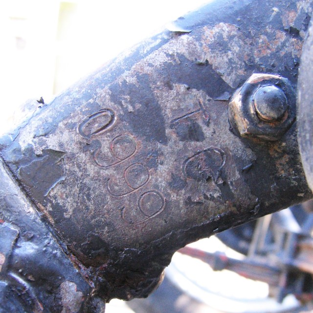

This is my TC chasssis and ID if that helps
1946 TC0999 / XPAG 1638

Tim:
Looks like only one bolt through the side of the eyelet castings on your chassis?
Rick
Rick

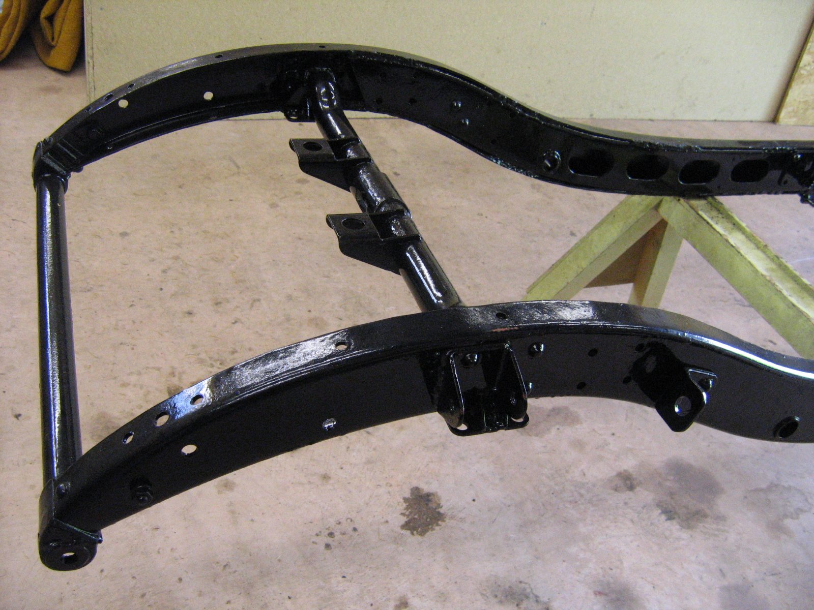

One bolt per side is correct. Here's TC 9849.
- frame1.jpg (40.3 KiB) Viewed 6107 times
- frame2.jpg (47.93 KiB) Viewed 6107 times
Re: MG TC Dumb Iron/Eyelet Casting
I just finished mine and one bolt is correct. I had to ever so slightly push my frame open to get the cross pipe to slide in, then the pin bolts for the spring pulled it all together.
Bryan.
Bryan.

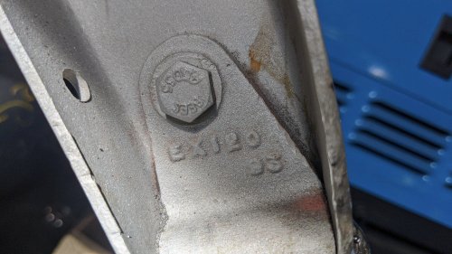

I'm not really sure about that, but the casting number should say EX120.

Steve: Is the number under the "EX 120" a "93"? I am going to look at my own car again next week.

Sure looks like it.rstarkweather wrote: ↑Sat Jun 29, 2024 4:29 pmSteve: Is the number under the "EX 120" a "93"? I am going to look at my own car again next week.
- ex120.jpg (93.38 KiB) Viewed 5982 times

To add to this discussion, attached is a picture of the offside eyelet casting on my TC. Casting number is the same ("EX 120"), but the subtext looks like "92" instead of "93"?
I have 92 on the driver side and 93 on the other side. Make sense to avoid confusion on the assembly line.
If you look at the last picture posted you can see a relief cast in to accommodate the one split lock washer and nut. The mystery bolt has no such relief cast in for it, so the holes were added later. Not sure why anyone would think that is a likely piece to break?
