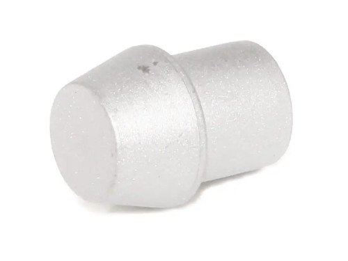

They sold a matching peg but I don't know where to get one now. The easiest thing would probably be to have a machinist make one. I don't have the exact angle for the peg, but it's a very simple piece. A photo from Moss Motors is attached.

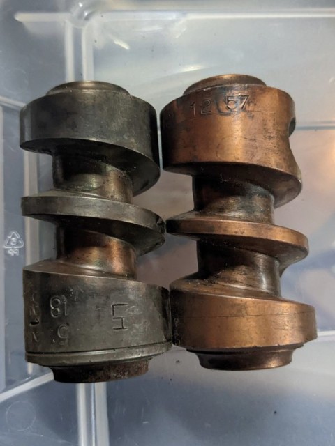

I'll send you an email. Here is a comparison for anyone interested, of an original NOS worm gear and the aftermarket ones with a slightly different angle. You can't see the difference by eye. Although I don't recommend it, I've seen people run the stock peg on these worms without issue.
