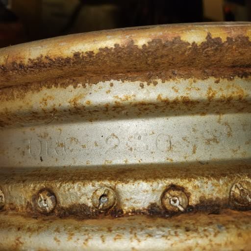

the rims on my tc measure 4" outside. i wanted to order new tires from blockley but they
indicate the rim width max should be 3.25 for the 4,00 x 19 tires. do i have non standard rims?
cheers
stu
Re: tc wheel dims
Post by Rob Reilly » Fri Aug 16, 2024 10:06 am
Rim width is measured on the inside. Yours should be 2.5" same as mine.
They are stamped DRC 250 19

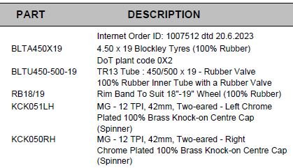

mws order.JPG (34.2 KiB) Viewed 2784 times
Same size as mine, 2 1/2"
I ordered my Blockleys from Motor Wheel Service. They had good prices on spinners so I ordered a full set of those as well.
4.50 x 19 Blockley Tyres (100% Rubber)
DoT plant code 0X2
TR13 Tube : 450/500 x 19 - Rubber Valve
100% Rubber Inner Tube with a Rubber Valve
Rim Band To Suit 18"-19" Wheel (100% Rubber)
Go with the Blockley inner tubes, they are very thick.
