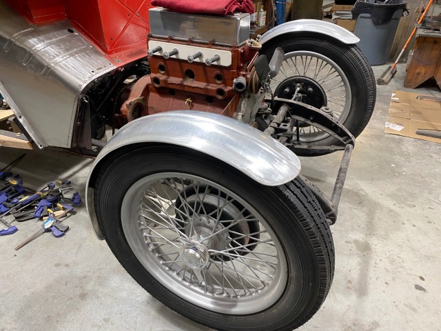

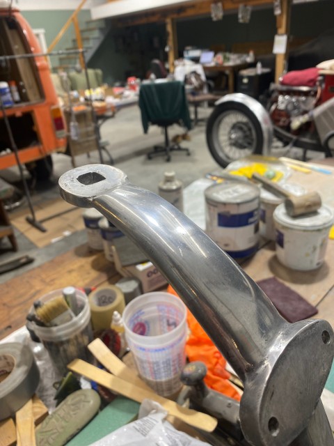

I obtained a set of aluminum cycle fender brackets from a collector in AU. They're pretty neat with a nice airfoil shape.
I was contemplating have more than one set cast and selling a few to recover some of the cost. But I'm not sure if there is interest.
Anyway, what I really need at this point is information on the rubber bushing and bolts that attach the fender to the bracket. Most photos I see they all look the same so I figure it's some sort of stock item for some model.

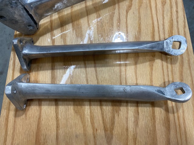

They are frame mount and install where the original bracket was located. First off, does anyone recognize them, as to year/model? I was told they were off a TA, but I'm not so sure.
I did finally get a pair of fenders but the brackets are not perfect by any means. One of the rear brackets is shorter than the other and I think it's a 2nd Gen. casting as it's almost exactly 20% short, normal shrinkage for castings.
My plan is to make sure at least one side will fit and work, then have the "good side" scanned. From that a pattern will be 3-D printed, then reversed for left and right, giving the 4 patterns, for left/right, front/rear, then castings made.I was contemplating have more than one set cast and selling a few to recover some of the cost. But I'm not sure if there is interest.

Franz,
I got a lead on a guy in Virginia that does scanning, modeling and casting. Not sure if I would get possession of the file or not. It's going to be a little tricky as I'll probably end up with only one good side, but once scanned I can't see why it couldn't be reversed to make the pattern for the other side.
Wonder if there's a market? Was thinking of having a few sets cast and selling them to help defray the cost which is probably going to be noteworthy...

Let me know if you need some close-up photos of the fender attachment points. I have very similar brackets on my TC and they were also sourced from AU.

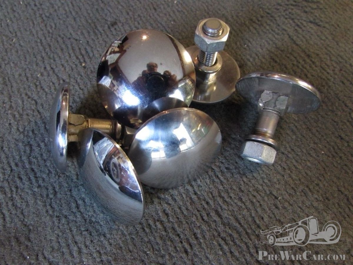

Re: TC Cycle Fender Bushings and Bolts
Success!
Luigi on MG Experience sent me a link for Pre-War.com. They have the bolts I was looking for alone with the rubber bushes.
https://www.prewarcar.com/310429-mg-chr ... xing-bolts
They responded to me in a timely manner and the bolts and rubber bushes are ordered.
robj

Just curious, do you have a spacer between the fender stay and the headlamp bracket? My set doesn't look as thick there. Or is that also a spacer? It looks like your fenders are a little flatter in profile, [and wider] Are you running 15" rims?
***Note; on closer examination, I don't think they are/were the same brckets I was hoping to buy. Looks like they were specifically designed for a flatter profile fender.
And a big thank you for the photos, they are a great help to me.
