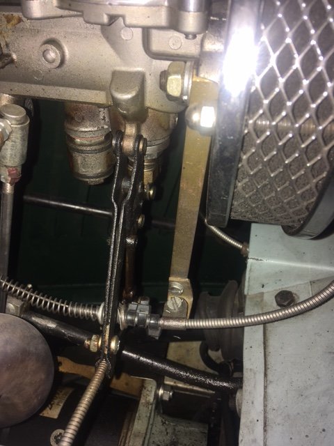

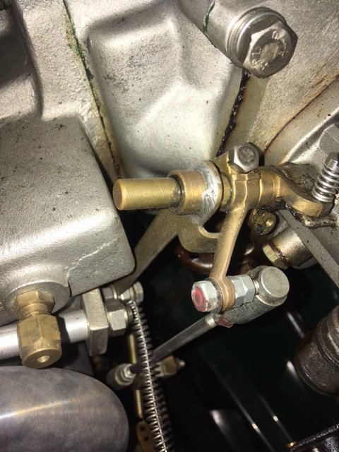

here is the lever. Placed on the carb shaft, pushes up with his bent end the carb control rod and opens the throttle. The Pics have to be turned 90° to the left.

The outer part of the slow running cable is fixed at this part made also of brass and fixed at the air cleaner.
Stop arm for cable
Stop arm for cable
Slow running device is very important. I wouldn't like to go without it !
If you need other pictures, let me know.
Cheers
Lindi

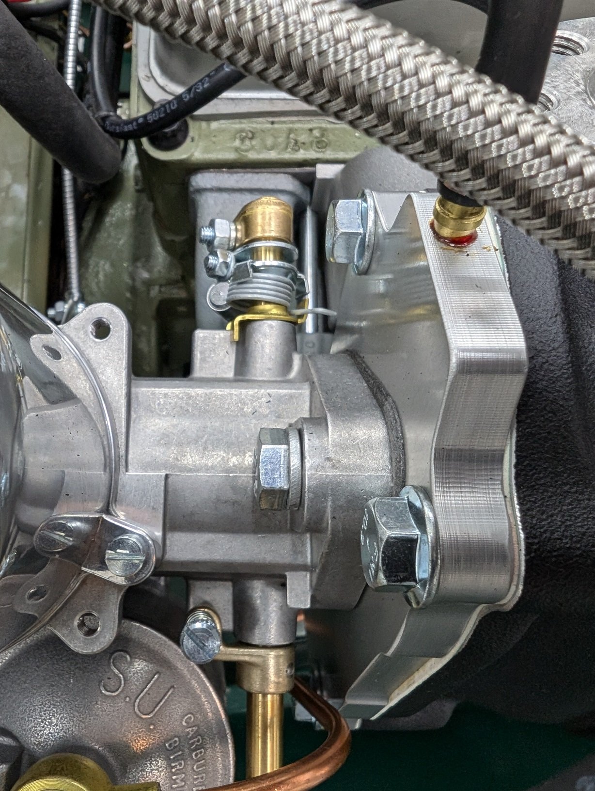

Post by DaveAhrendt » Wed Sep 18, 2024 2:45 pm
Thanks Lindi,
Looks like a good working setup. The stock Moss installation doesn't leave much room on the inner side of the carb.
I've got an idea of something that may work. I'll try it tomorrow. I've attached a picture of the current Moss arrangement.
Since they used basically an MGA H4 carb they could have equipped it with the A's fast idle mechanism.
Dave

Post by lindi » Thu Sep 19, 2024 11:20 am
Hi Dave,
indeed there is not much room. Can you move the bits from one side to the other ? Maybe I had to do the same, but I just don't remember. Too much time passed, too much things done since then, sorry.
Saluti
Lindi

Hi Dave,
i you have a proper return spring on the accelerator lever you don´t need the little
return spring on the carb shaft - so you have much room for a idle lever,
cheers Carl

Post by DaveAhrendt » Tue Sep 24, 2024 11:23 am
Thanks for the suggestion, Carl. After a very interesting experience in an MGA many years ago I think I'll leave the
secondary spring in place. If I could add 3 or 4 more return springs I might do it.
But it may come down to replacing the shaft spring with something else.
Dave
