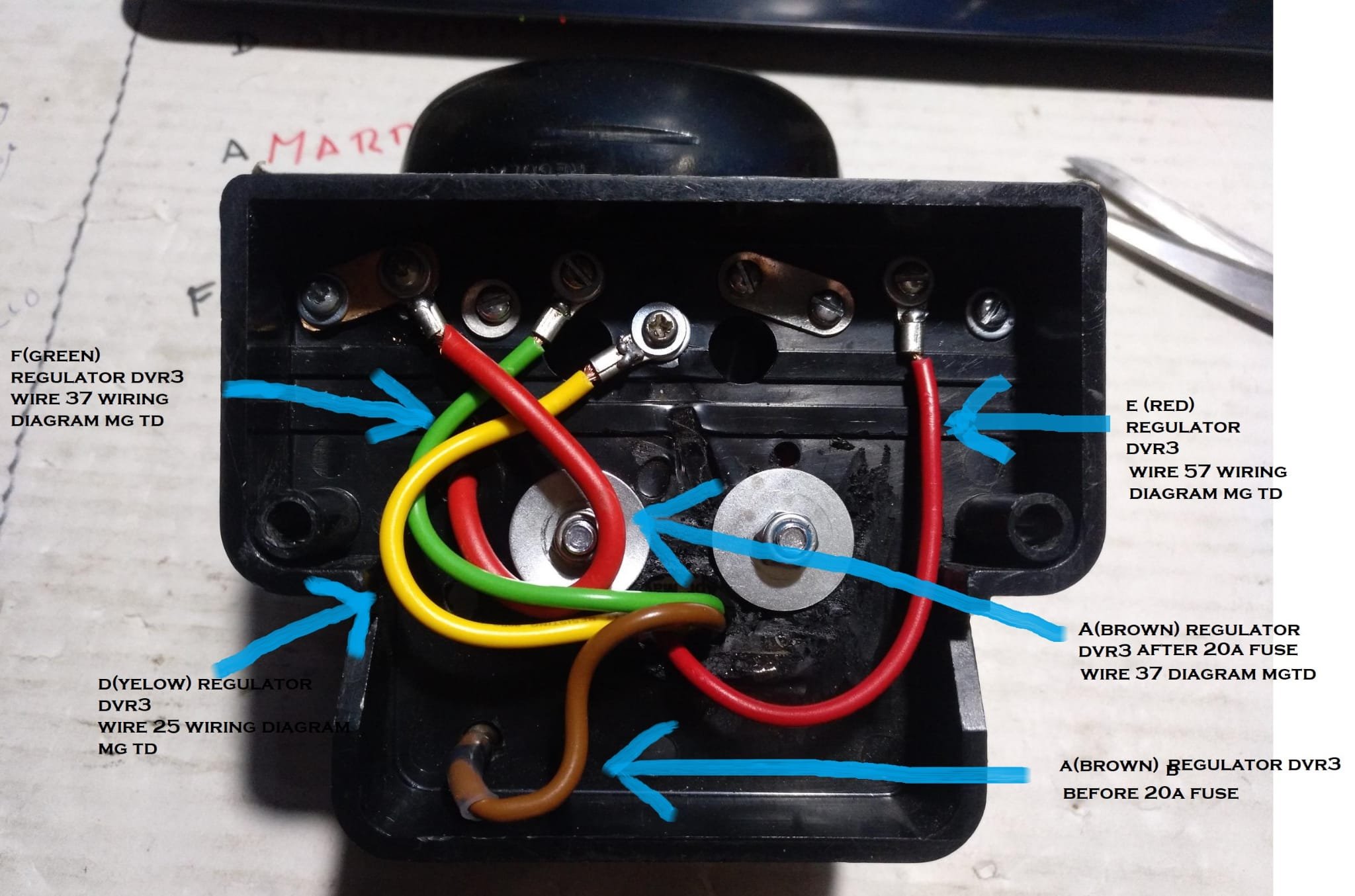

Hi fitted several electronic regulator in a original housing,
all work well
cheers Carl
all work well
cheers Carl

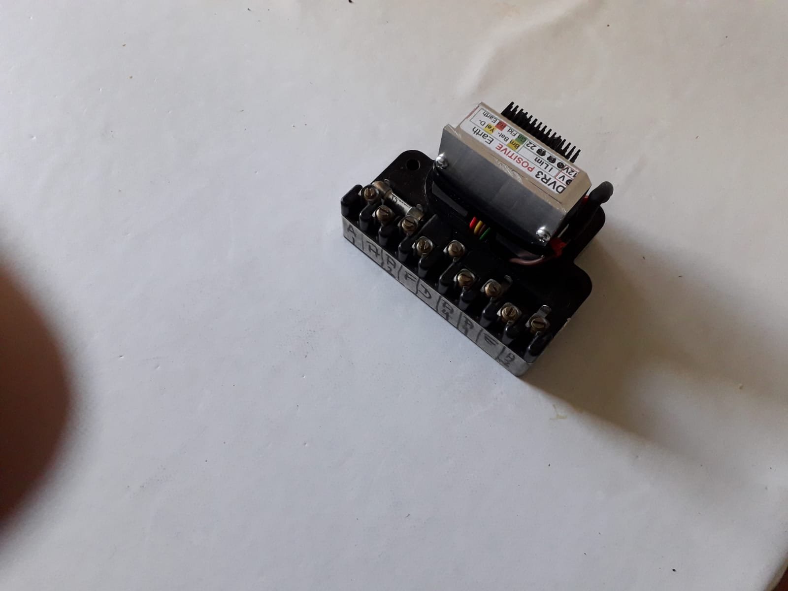

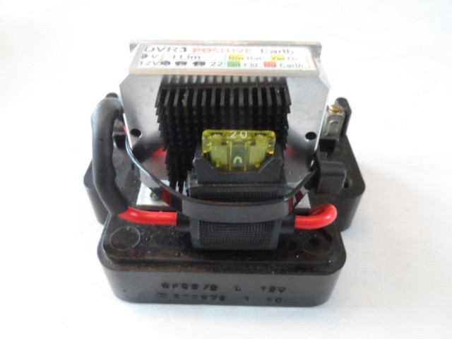

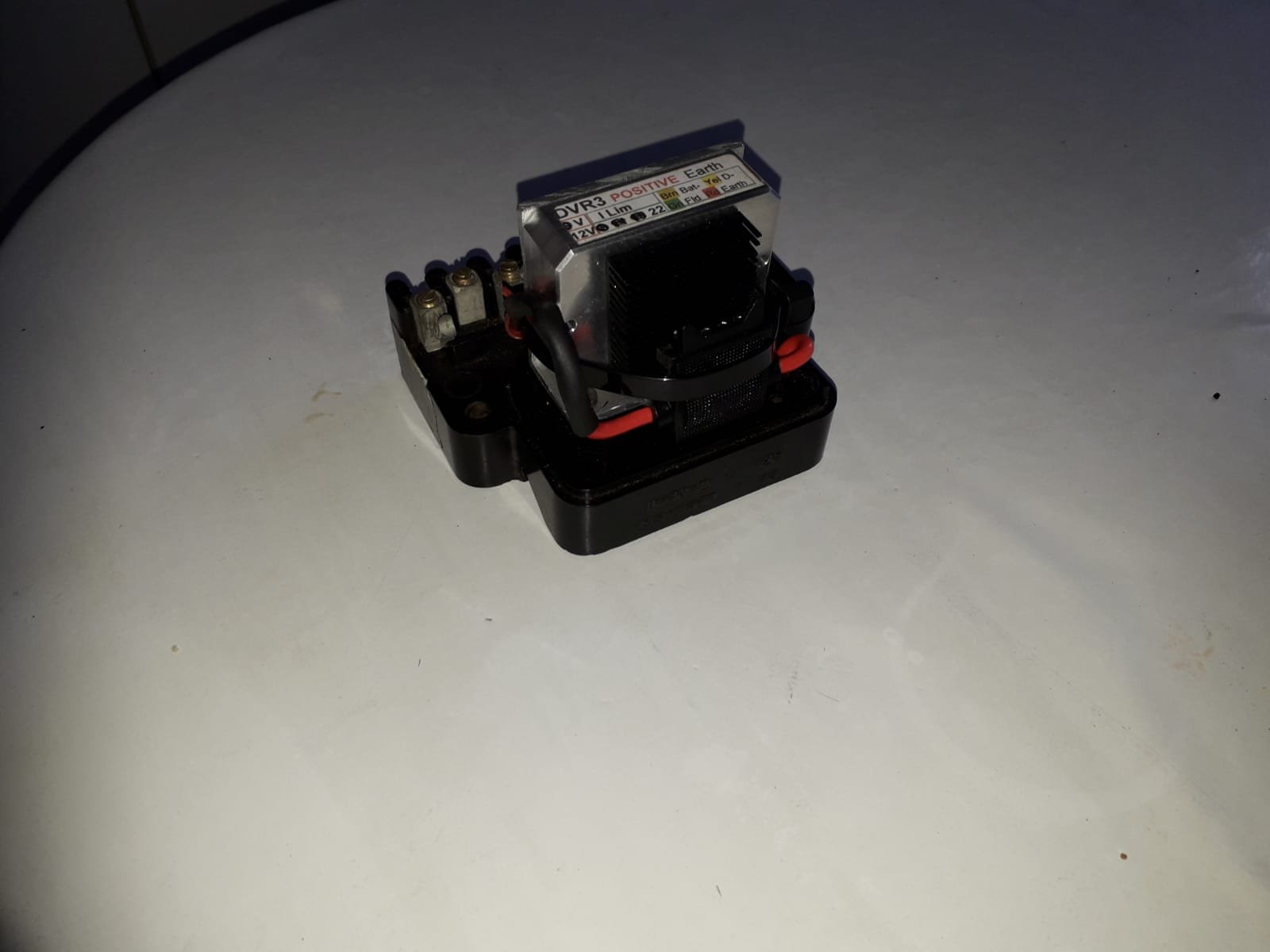

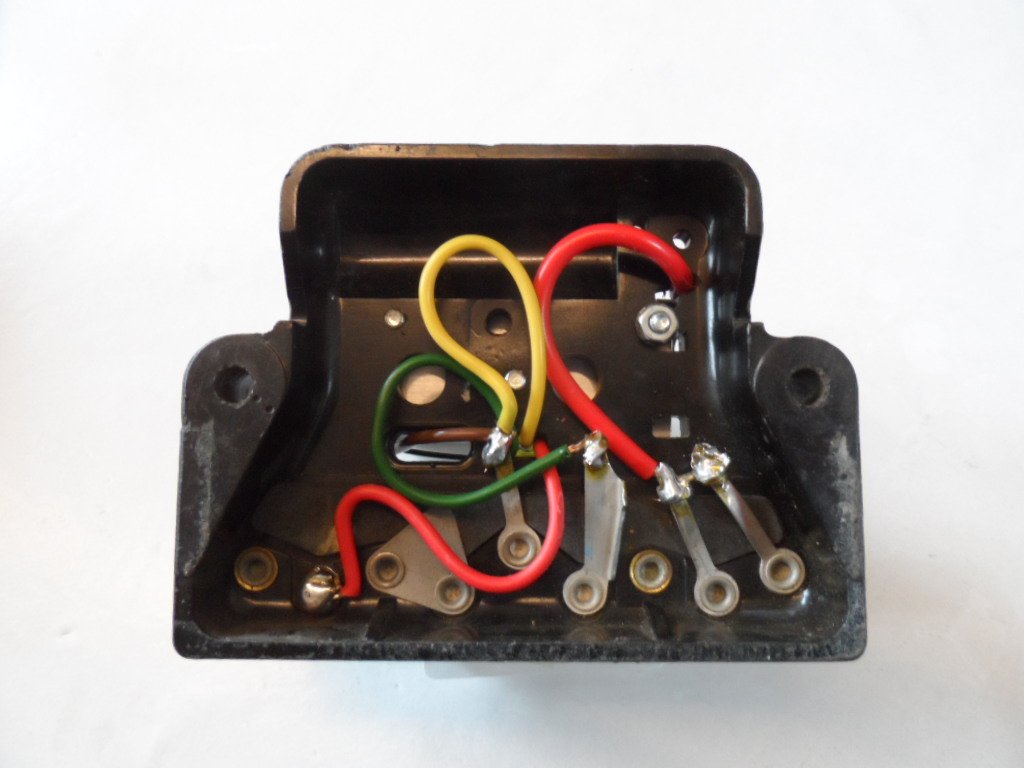

here one more
