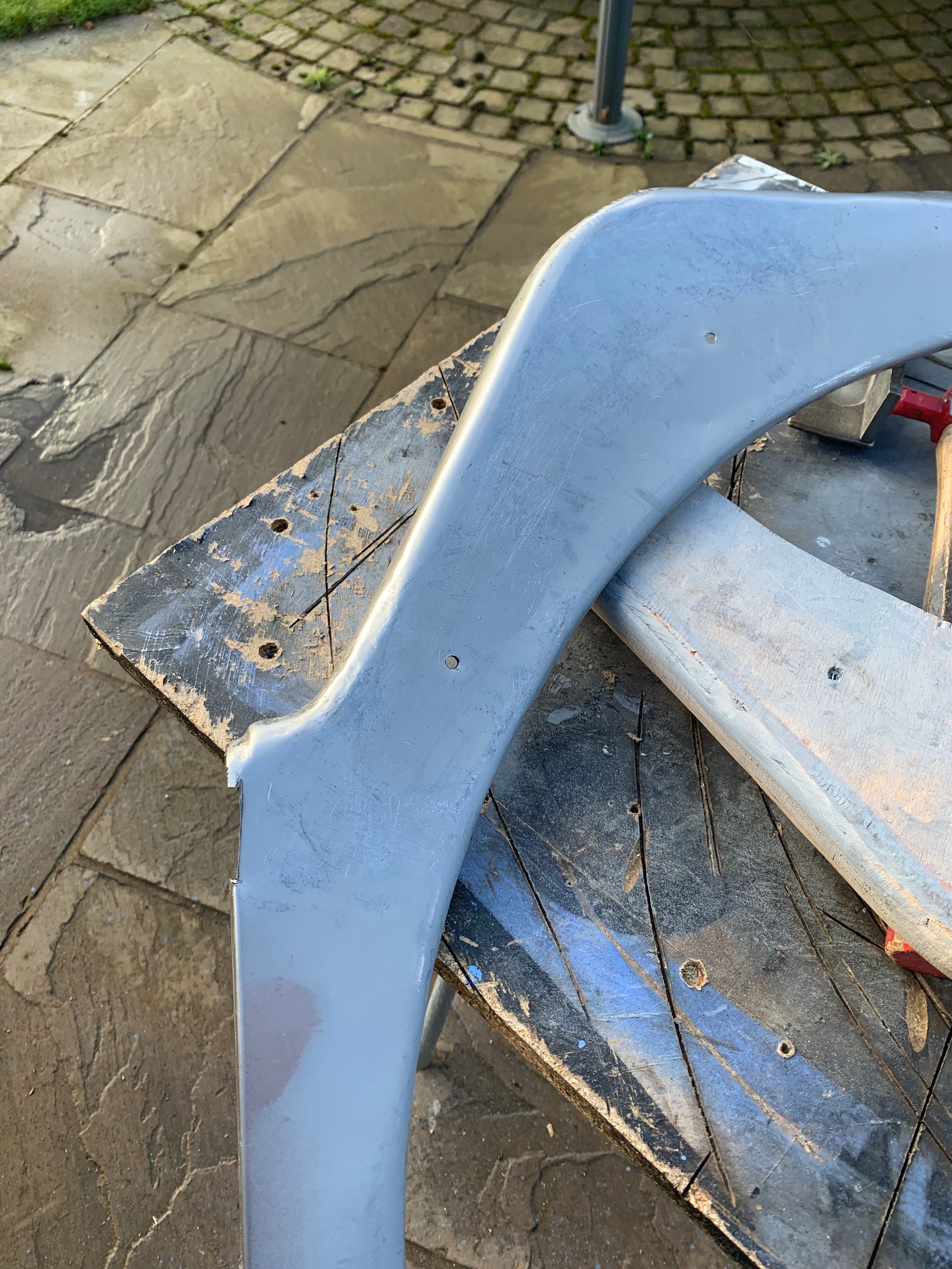

the section at the top has a compound curve on it see picture where it meets the “scuttle “this was hard to achieve as this is where the windscreen brackets fit and you’ll find a lot of messy around to get it right , once all was well I sent the bottom under door section over , the bottom also has a curve!
Also just keep an eye on the panel as it goes up to the scuttle, I have also fitted my rear quarter panels and used a temporary buck I shall post I a few days

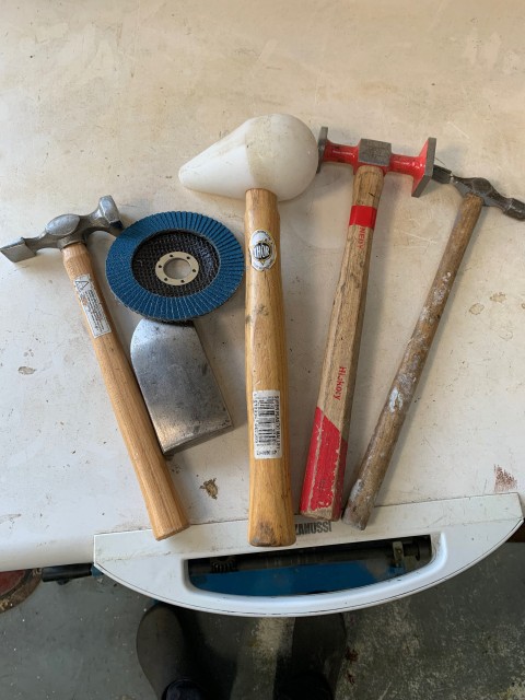

Hi Rob

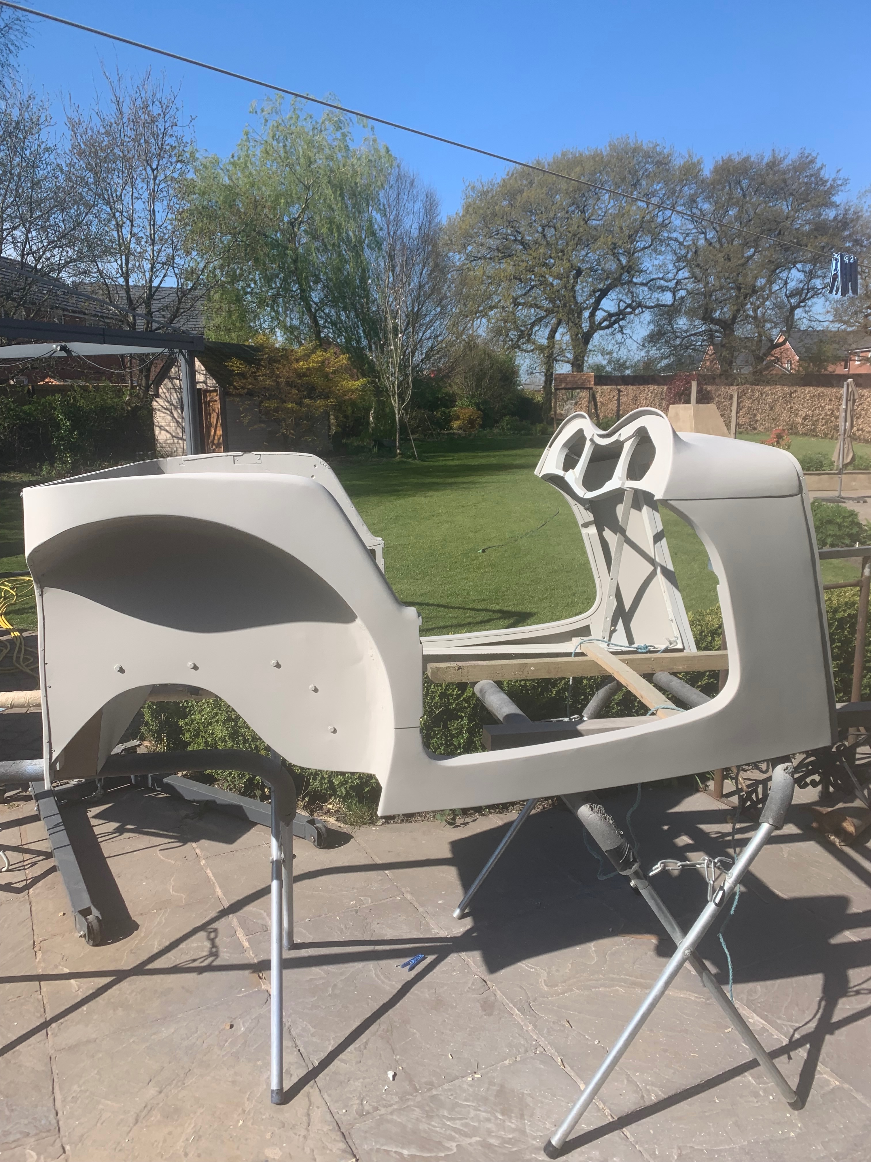

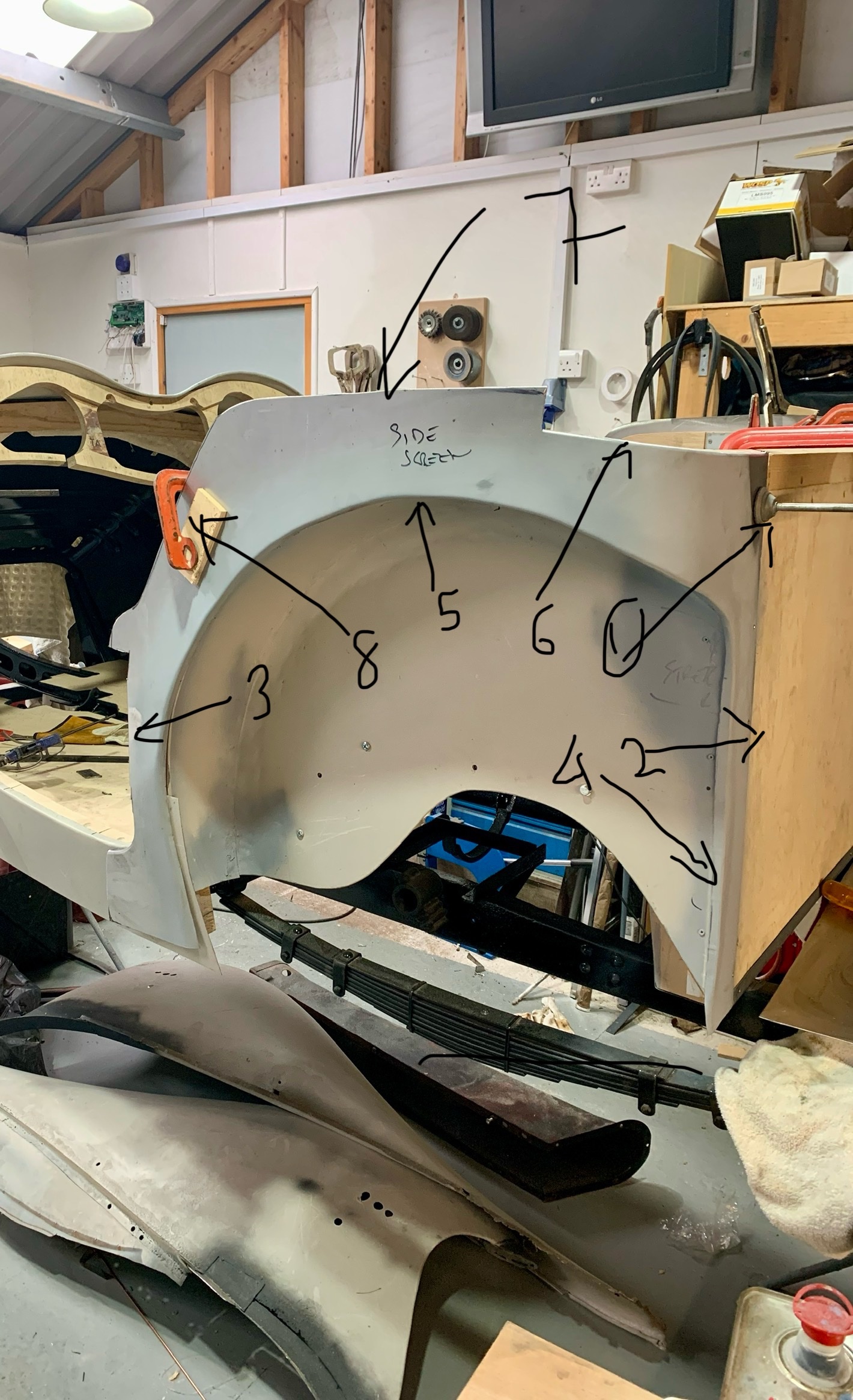

Just thought I would post this just incase there’s more then 3 maniacs in the world totally rebuilding a TA (R R and R J that’s you guys ha ha )
So I started by making a paper template of the area , making sure you leave enough material over the top of the wheel arch and the section down to the hinge pillar,this nearly caught me out and just managed to get it !
#1 istarted off by doing the first fold at the back of the tub the little slot on the back board, this was done on the bench and the panel was then placed back and clamped tight , use blocks of wood to protect the panel. I used a level and marked a line vertical so i could trim the bottom section, I used a couple of small screws to hold it in place.bend the panel around the rear quarter by hand keeping it tight and clamping as you go along.clamp to the hinge pillar and mark the panel on the inside with a sharpie between the 2 hinges, remove panel and fold this section over, I cut the sections out for the hinges prior to doing this fold replace the panel and clamp.#3
I then turned the steel at rear of arch over from the bottom onto where the curve starts using a dolly and hammer.#4
I did a test piece to see if I could turn the wheel arch over with the dolly but had to mark inside rear of arch remove and put a crease in with my cheap bead roller , I then sent this over using a dolly and blocking hammer.#5 . I use 1mm … 0.8 would be easier
I then sent the section #6 over with hammer and dolly this went over fine . Make sure your side screen brackets are flush with the top of the body otherwise you’ll end up with an ugly curve in this section.
I then made a buck out of 2 pieces on 1/2 ply stuck together see picture I scribed it in tight to the wheel arch on the inside of the body and then formed it with a sanding disc. Basically another wheel arch , mark in a way you can clamp on your panel when removed for car , keeping everything tight, you can now work with it on the bench,
I used a blocking hammer to send the internal curve over just above the top hinge , slow and steady, I used a hammer and dolly to send the straight, ish section up to the top curve and from the side screen bracket forward to the front curve#7&8 still on the buck
The curve at the top I could not get it over even with the Shrinker and ended up cutting with a small hacksaw and tiging . There’s the tight little rebate bit just above the hinge I sent over with a cheap chisel ended hammer , take your time I also found a little tack hammer useful. You will end up with a small piece at the top of the door hinge pillar I made a piece for this and tiged in …. Just like the original, you can now once happy send the final fold over to the inside of the body. I used polytop nails with the heads off and drilled small pilot holes to assist fixing. I hope this makes sense, and finally all you professional body guys out there i hope after reading this and fell on the floor crying with laughter you haven’t hurt yourselves
Mick bibby
Posts: 42
Joined: Sat Oct 28, 2023 5:33 am
Location: West LANCS England
Re: TA Body Tub Timber Construction Pictures
Post by Mick bibby » Wed Apr 23, 2025 7:08 am
Sorry Bob I’ve posted this here to give continuation I hope you don’t mind , I am sure Steve could move it if needed
Mick bibby
Posts: 42
Post by Mick bibby » Wed Apr 23, 2025 7:12 am
Sorry finished tub no body filler,,,,,,, yet

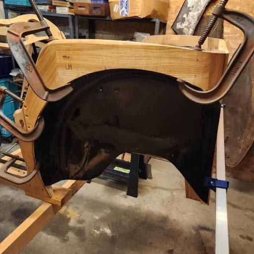

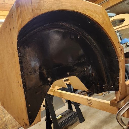

Well, I had forgotten that I started this topic and I should have just continued on it instead of starting another.
Anyway, I realized I should put on the inner rear fenders before any other panels, so I did today, using the 1/4-20 x 3/4 flat head (or countersunk) screws specified and provided by Doug at From the Frame Up.
Now I can see where to cut notches in the timber for clearance on the caged nuts.

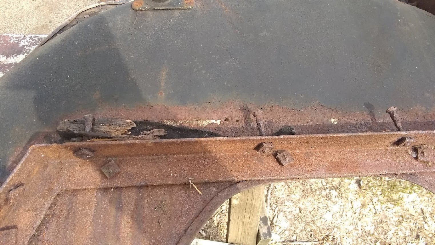

Then I thought, why flat heads? Why not round heads? Well I found a picture from when I took the old body apart, and it has flat heads with square nuts. Its because with the 1/8" felt padding in there, the flat heads will put a dimple in the panel and not protrude like a round head would.
Here are pictures of the right rear inner fender as was and as is.

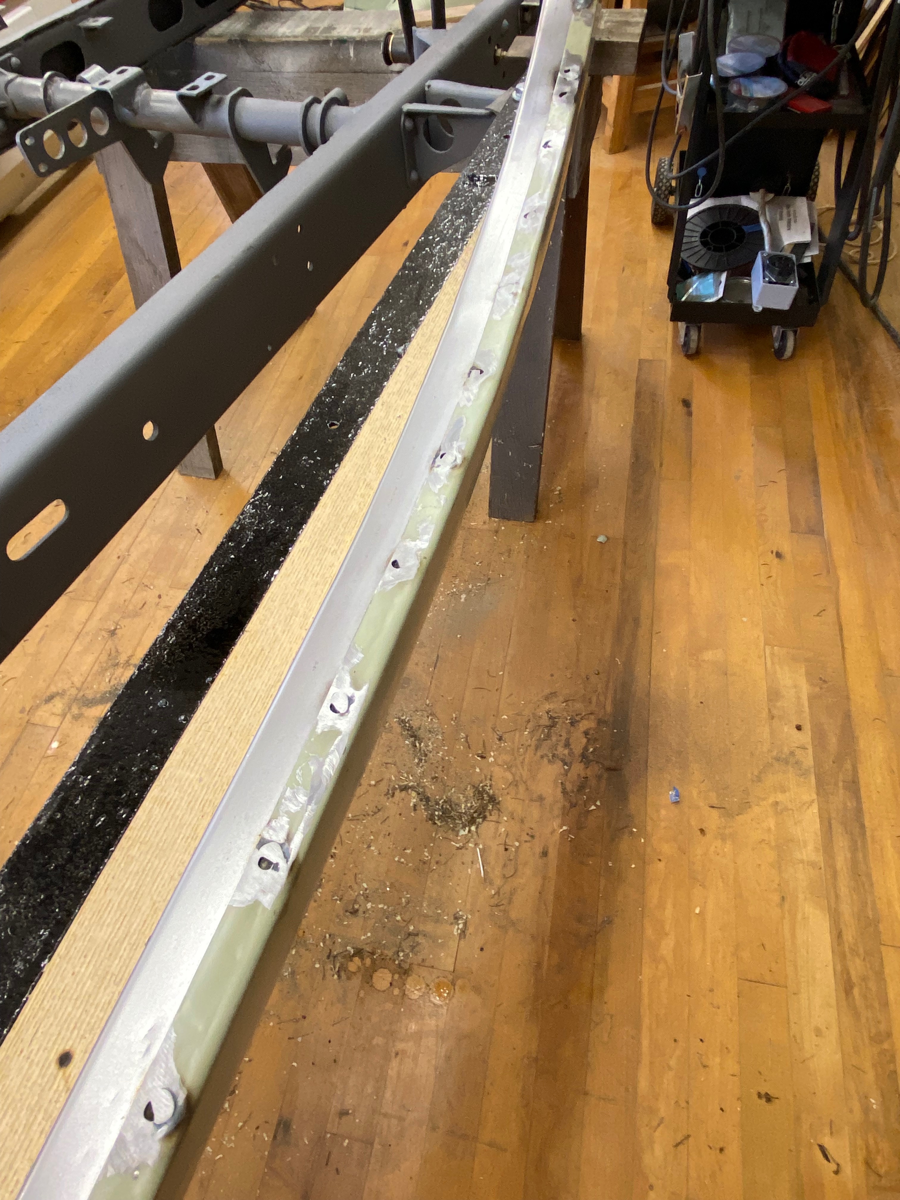

Here's few photos which might help. The key thing is that there are 4 small rail pieces of metal which sit on the ash rails surrounding the door opening. You will spot weld the side pane to these as you fit around the door. The pictures are more helpful than a lot of words. You might have to cut a couple of darts in the side panel metal which would bend over to account for the slight curve in the panel.
It's a good precaution to test fit the doors a few times to make sure you have clearance.
You can see the need to have accurate curves on you ash have on the wooden frame.
Good Luck and work slowly, Bryan.

"my frame had existing countersunk dimples."
That's interesting. Mine did not in the rear inner fender region, although it did have some countersunk holes farther forward. Probably they were considered an improvement.

The left inner fender is nailed in.
Here is my method.
Get a lot of C-clamps and a long bar clamp, and fit the fender in so the rear edge is lined up with the back plywood panel, and the upper edge is more or less in place. See if the 5 screw holes line up. If they're close, put a round screwdriver or something in them to hold them, and then tighten all the C-clamps.
There should be a screw hole near the bottom of the rear edge. Put a #10 x 5/8" screw in there.
Now run a 1/4" drill through the 5 screw holes and put the 1/4" x 3/4" screws in with nuts and lock washers.
At this point I could see my clearance notches for the caged nuts needed to be a little larger.
I decided to add two more 1/4" screws at the lower front corner through the steel frame.
Then you find out how good your nail driving skills are. I only bent one a little bit when I tried to just drive it through the steel. I started at the lower rear and worked my way around, using a sharp punch to start nail holes and then drilling them with a 1/16" drill bit set to only go 1/8" deep, moving the bar clamp and C-clamps around as I needed.
A nice feeling that I accomplished something.

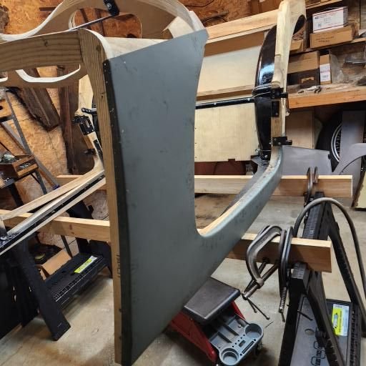

Post by Rob Reilly » Sun Apr 27, 2025 5:19 pm
Checking the fit of the new lower side panels.
I have to cut a notch at the rear to clear the lower door hinge to bring the panel forward an inch.
I also checked the clearance to the timber around my doors to make sure they would still close with the additional thickness of the metal folded over the edges.
I found no guidance about nail hole spacing in the books, so I decided on 1 inch, and pre-drilled the side panels around 3 sides and the door opening, 1/16" diameter about 3/16" off the edges.
Got it aligned and clamped super tight, and hammered over the rear edge, a couple of nails, then went to the front edge and did the same on a few. Looks good, aligned all around, though not perfect, the amount of overlap is 1/8" less at the upper front compared to the lower front, so perhaps my timber joints are not perfect, or the panel is made for a TC.
It seems that coachbuilding is a little like music, open to interpretation; the composer had an idea of what he wanted, but the performer interprets it to work better.
Finished the front and rear edges.
The way to do a long 90 degree fold in the metal with a body hammer is to go a little at a time, and work it all slowly all along, a few degrees at a time. The nails brought it down tight.
Then I rolled the body over on one side so I could do the bottom edge.
Bottom edge all finished.
Back level and did the door opening. I found there was way too much overlap at the rear corner, again possibly this is a TC panel? I couldn't stretch the metal to form in that tight corner, so I had to trim some off with a die grinder, leaving about 1/4" of overlap.
Door opening finished.
