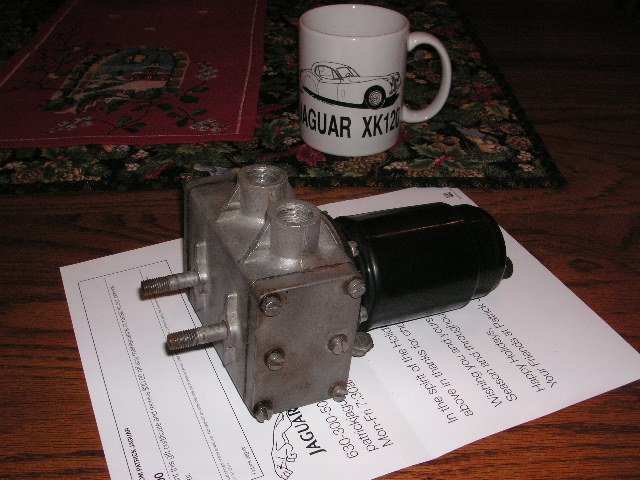

I don't have any experience with superchargers, but your situation sounds similar to what SS Jaguar faced when they increased their engine size from 2-1/2 Liters to 3-1/2 Liters. One type AUA25 fuel pump was still fine for the 2-1/2 Liter, but couldn't keep up with the demand at high speed on the 3-1/2 Liter. So they put on two AUA25 pumps in parallel. Note there are 2 tees in the fuel pipes. All their 3-1/2 Liter models had this arrangement from 1938 to 1948.
Later on SU came up with a new pump called the LCS for Large Capacity Single, and Jaguar used this one on all models from 1949 on until about 1969 when the V12 came along.

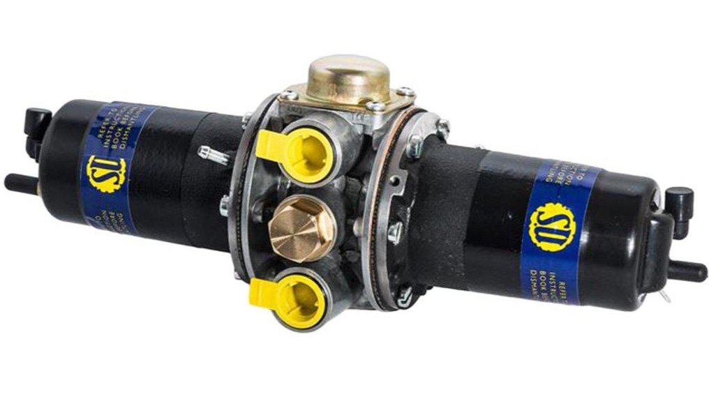

In addition to Rob's example above, there was also a double-ended SU pump used on some cars, as seen below.

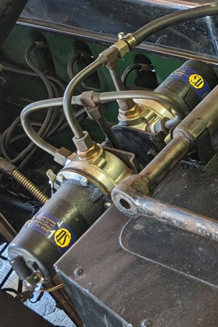

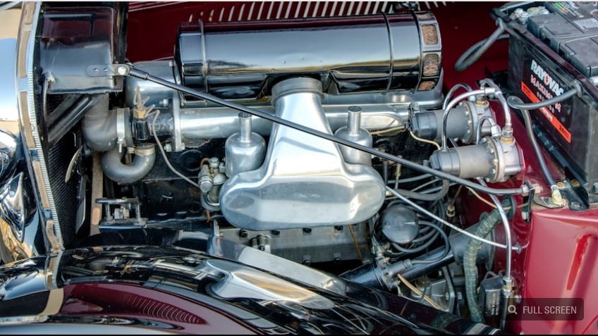

Some pre-war MGs also used dual SU pumps. The photo below is my MG SA. The incoming fuel is split to the two inlets and the two outputs have a T into a single line to the carbs.
