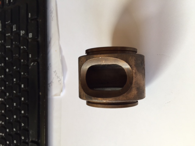

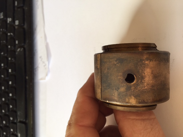

in the interest in sharing, i am posting a few pictures of the TA center CAM bearing
i have searched everywhere for these with almost no luck,
Martin at Abingdon Spares found some in the end,
they are marked as
"22082 17 MF" and "22085 16 MF"
it is a bronze or brass bearing housing with white metal on the inside, comes apart, and looks like it is held together with a wire tie?
if anyone wants measurements to have one made let me know ok
now i just need to find push rods and a small timing gear.. which i can buy new in England if necessary, 1 arm, 1 leg
thanks Justin
