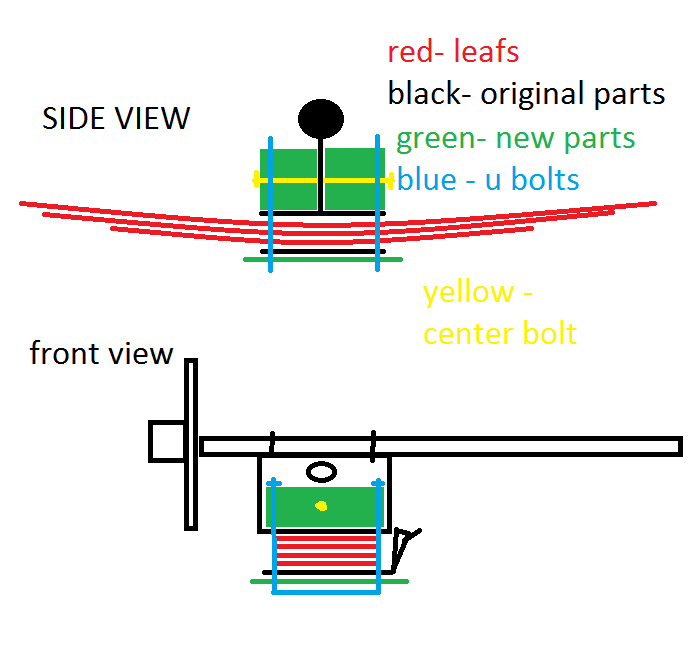

My two ideas thus far are this
1- run a tap into the existing 1/4 inch holes - possibly a 5/16 or something slightly larger in order to restore the ability to get a bolt snugged into the tapped holes, and enlarge the holes on the lower plate
2- do the same as above, but replace the lower bracket to acommodate the larger center bolts
3- do the same as number one, with the enlarging of the holes, but install an extra plate below the first plate that is slightly wider to ensure that the enlarged holes provide enough strength.
OR
Barring re-installation of the center taps, I was thinking that I could have a set of four square U-bolts made custom to fit around the rear leaf spring, with a considerable extra length to them, and I could make some blocks that fit into the bracket that drops down from the axle such that the effective area the bolts go through - both on the top and the bottom - is thicker and the ability of these things to wobble is thus quite significantly reduced.
Understanding that there are already holes in the welded bracket dropping down from the axle it seems quite possible that a third bolt could be put between these blocks to hold them tightly to the bracket, making it impossible for this to move.
For ease of understanding, I drew this idea up (poorly!)
Maybe I am over thinking it?

I cannot help you with the two locating bolts on each spring mount, as mine were fine, so I would just be speculating. The other 4 bolts get tightened down good and tight. They also get banged up, it seems. To add to Julien's advice above, the typical replacement is with 5/16 bolts of the right length, and double nutted. Jam nuts might be considered if you think the length is an issue (sticking down) when double nutted. Do be sure and use good hardened bolts and nuts, like grade 8, or if using metric, grade 12.9. And whenever something on a TC requires "tight" nuts and bolts, beware of the unknown PO's. Or in this case, check the mounts for any cracks. Bolts like this with leaf springs are sometimes called "spring center bolts" which is some general term, I think, for hardened bolts.
As for overthinking on this general original design, I think the MG engineers already did that, and what they came up with is as good as it gets. The double nut process is: tighten down the nut to how tight you want things, then hold that nut with a wrench so it will not turn, then add the second nut and tighten it down good onto the 1st nut with another wrench.

Yes- I have double nutted things before. I will try and tap out those holes to 5/16 american and see how it goes.
