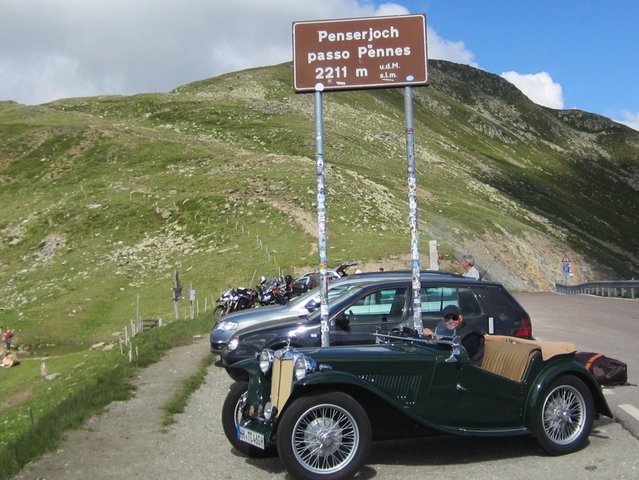

Here is one photo from that segment, with two weeks worth of luggage behind the seat!

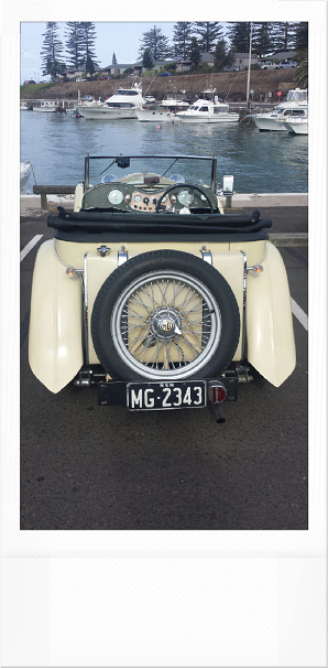

The good thing about a TC is it,s simplicity
Make sure fuel hoses are in good condition [internally ]
My hoses looked ok and moved them to remove air filter to paint. Turned key on and fuel sprayed everywhere as hose inside had snapped like a carrot even though outer braid looked new so check them.
Once replaced would not expect a problem but I made a temporary one while waiting for new ones so have chucked in Tool box but not really sure if would ever need it.
Have you got spare keys ?? I am the worst offender when riding on my motor bikes and have lost count how many times have lost one and had to hot wire to get home.
Have a great adventure
As for hot weather my car runs average 75 deg when out side averages 25-30 C and goes up by slightly above that so expect to runs close to 80-on the open road if 35-40 [100f] but at that temperature outside only mad dogs and English men venture .
If for some reason had to venture in that type of heat would put hood up to prevent getting sun burnt ,trust me ,it,s no fun in that type of heat but then again I live on the coast so usually cop a North westerly when those temperatures happen or 100 % humidity if in the mid 30,s. Then Leather seats are a must
If your lucky enough to have a spare dizzy then I suppose chuck one In as plenty of space under bonnet tool box But when ever I decide to go on a longer run I just make sure fuel pump and distributor have new points or clean ones .
Would be a good idea to check fuel filter at bottom of SU pump as have had one get clogged but rarely had one give up entirely.
My TC is my Motor bike on 4 wheels [Has mudguards and wire wheels so half qualifies ] so gets treated like when when I go away on my bikes
Roll of tape and wire cutters and tools in small pouch.
Credit card in the pocket and a pair of jeans [not entirely ]
As for oils etc there is always a servo somewhere but agree that if you have some from home chuck some in.
Importantly !!!!! take upper cylinder lubricant as unleaded can be unkind to valves on prolonged runs and they can stick. Has not happened on My TC But a 21/2 ltr Riley I owned for 30 yrs was plagued with that problem
I purchase in 1 litre bottles as too expensive for those individual little 100 ml bottles at the fuel stations.
At the end of the day chuck what you think will give you trouble but Murphys law is it will be something else that will fail. You know your self what is new and less likely to give you trouble hopefully

All you need is luck! For years I have been taking along enough spares to almost rebuilt half a TC and now just take a spare tube und an umbrella with me. In Europa the breakdown services are good, and I have a homebringing insurance so in the worst case the car comes home on a trailer. Never happened before and a good maintained car should do the trick. But....you never know, but you than may find out, that you just have packed the wrong spare part!!!
- dirk w dondorp
- Posts: 164
- Joined: Mon Jan 07, 2013 12:51 pm
- Location: Hamburg ( Dutch nationality)
Re: Long distance touring
most important part; the umbrella!
at over 6' 4" can hardly drive with the hood down:-(

I love that picture Dirk!
