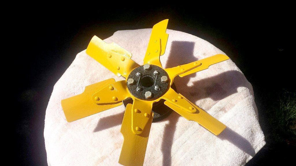

I have modified the MGB 6-bladed metal fan (1968 thru early 1973) to fit the T-Series water pump pulley. It requires some machining skills or access to machining sources. It is neither complicated nor expensive. Does not invade the open space between the fan and radiator core any more than the original hokey two blade units did. Looks good and arguably gives 33% more air flow than the original fan ass'y. It does not flex as I've read some plastic fan adaptations have and have caused resulting damage to the rad. It doesn't require a shorter Morris fan hub pulley to regain the lost space between the fan and rad core. In my opinion, the later plastic fan does not belong on a TC any more than a Weber carb setup does! It doesn't look right and can cause problems from what I've read on other blogs. But hey, your car, your choice. my car, my choice! For any of you who may be interested, I can provide modification details.
Marv TC5141
[img] [/img]
Marv TC5141
[img] [/img]
