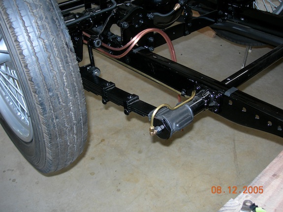

Does anyone know the correct pipe routing out to the fitting on the rear trunion? I’ve seen it run along the top and bend down, or along the back and bend forward, but would like to know what the correct way should be.
Craig
TA 2962
Craig
TA 2962
Re: TA/TB lubrication system parts
Sorry - I don't know the correct way to do this - and I have not checked with 'Original MG T-Types' book, but I found this picture online - could be correct and could be wrong...
