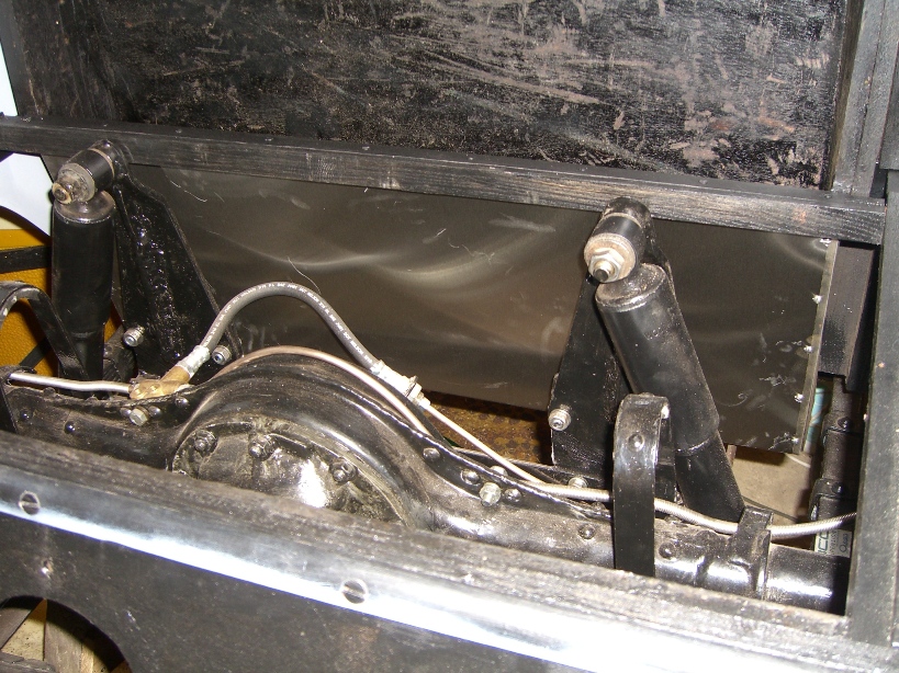

Ian do you mean you are missing the sidescreen box metal panel, as shown on page 172 of TCs Forever?
I made up a new metal panel to the dimensions shown in Sherrell, which I found pretty accurate. The new bottom rail dimensions are given at the bottom of page 171. The back end of the body is clamped to the chassis through this bottom rail.

It's looking good Ian, I like the turnbuckles on the door straps and I will do the same when I have found the ones that I have temporarily misplaced. I don't know where you are based but NTG services in UK list both of the Sherrell books, pricey but invaluable. I made my sidescreen box metal panel by ordering a cut to size sheet of stainless steel from ebay and then took it to a sheet metal shop with Sherrell's drawing to get bent up, total cost £40.

Thanks for picture.
It looks like I can make and fit later and seems like only there to assist should wood/ ply fall apart.

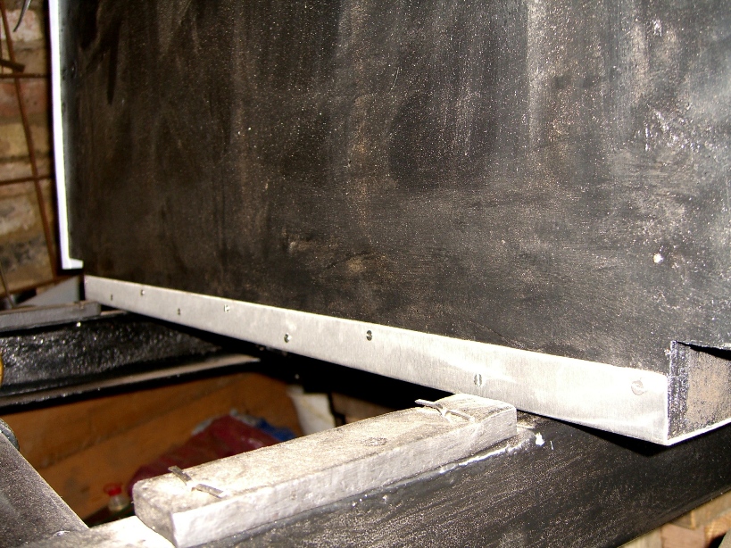

The metal at the bottom of my original sidescreen box had rotted away at some time and been repaired with a riveted section so I am surprised that a ply box would last.
As for fitting metal at a later stage the top edge of the box wraps around the back axle cover frame. The metal actually passes between the frame and the tub back, so you may need to modify the metal design to suite.
