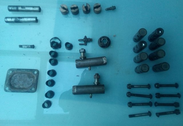

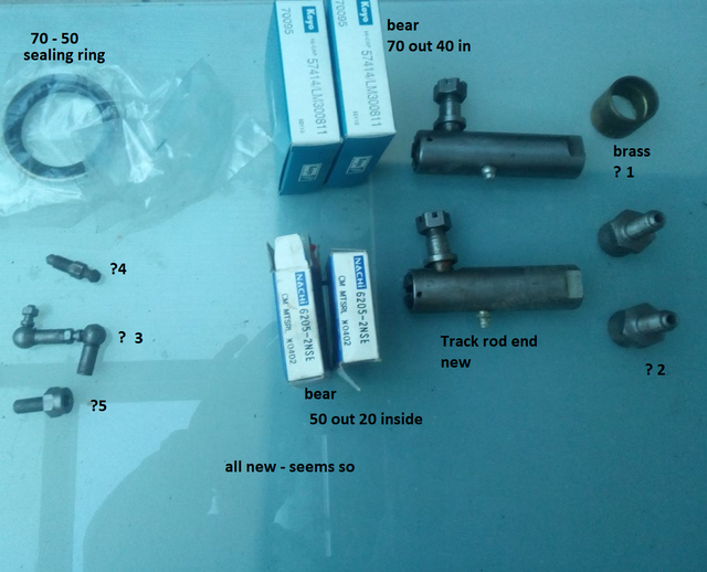

Re: TC Steering box
when i got the car i got a big box with parts,
today i take a look to it
and i found two track road ends,
they seems to be new, but how can i test it ?
i think somebody has took a look to it , and think : the old one are ok ..
otherwise i have perhaps some new one
perhaps save some money
it was wonderful wehather today, but not enough time, shit
i have to paint my new garden door
i need some place for my hobby
garage 8x4m
garage 8x4m
Re: TC Steering box
Hallo
today i make some picture of parts i get with the car,
kingpins?! , Bear ( but wich one ) ...
some looks new some old and used,
some used but good condition, so it seems...
so someone has worked at the front some day....
but i don t know all parts i have
would be great to help me, easy for someone has done it,
i will help other people too when i know it
i will write all together i find of steering ...

Hi Franz
on track roads end the balls are the critical point- sferic surface must be controlled, if good -then must be controlled the 8 holes and the springs
the box can be the front hubs bearing ..are new or the oldest after the substitution?
easy to control if you find the SFK or Timken code equivalence
My opinion are that PO makes the works and changes, and this are the old pieces (in good or usable conditions) precautionary stored -- I have adopted the same strategy

Sorry this morning first no time, just take the pictures
no some text to it
the old track road ends are 1 mm or, 1,5 mm more in diameter than the new one, seems to be new ...
different suppliers ??
both the new and old one don t wiggle, and seems to work goor when i take the little arm
the thread also seems to be unused.
some old parts no idea what they are, some parts from the engine, all 8x
the old cover of the engine perhaps.
a new seal for the valve caver and the cover on the side
so some parts to save noney ?!
