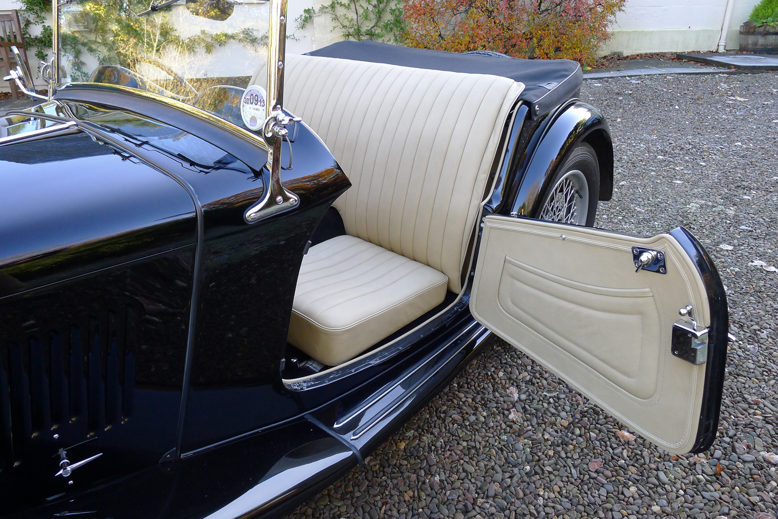

Ian, TCs Forever is not the book for trim IMHO. I made all my own upholstery and I mainly just Googled for trim photos on the internet. You will find lots of them, particularly from cars for sale. But look at quite a few as not all are correct.
Yes, at the rear of the door the piping abuts hard against the piping on the tub. At the front, the piping around the dash comes down inboard of that on the door.

You are talking about the trim that goes around the outer edge of the TC door cards? It sticks out from under the card everywhere but the bottom and back (rear) edge. At the rear edge it is completely under the card. On mine anyways, and it is original interior. Makes for a perfect fit on mine, when the door is shut.

Thanks for the excellent photos
Its exactly how I have fitted cutting piping off at top edge of door at the rear
I hope to push rope cord in a bit at end and glue piping together not that its really noticeable
