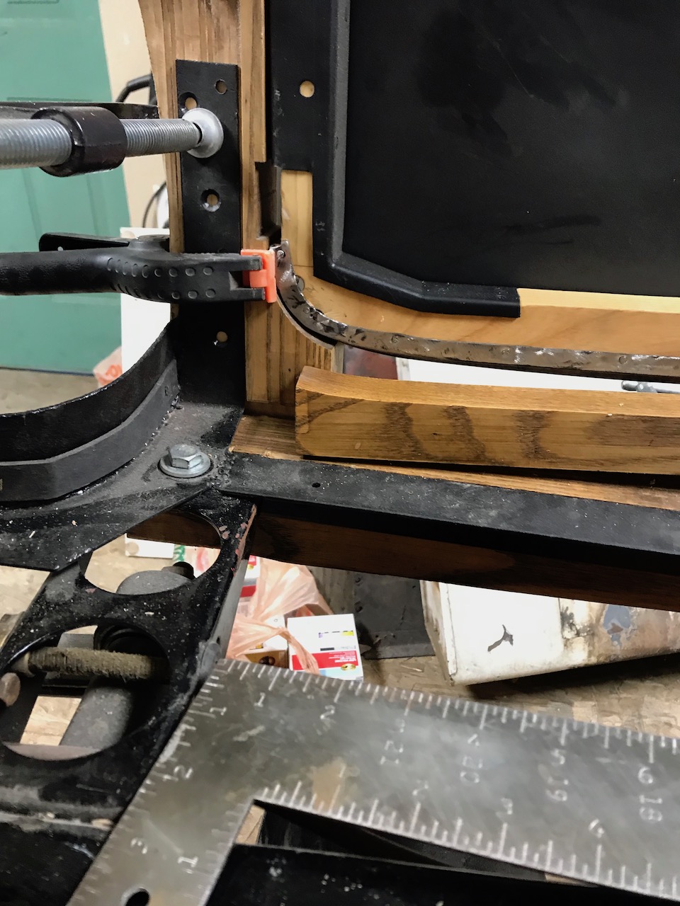

Here is a pic of the outrigger extending into the wheel well.
I can make the wood and sheetmetal work if I extend the bottom main rail to match up with the outrigger.
Has this been done to deal with the problem?
Then if I drop the hinge pillar down to 13 3/4" instead of 14 1/2" and move it back to 29 inches from the back board instead of 30 1/2" the door works, the top rail matches up to the back board and the sheetmetal fits.

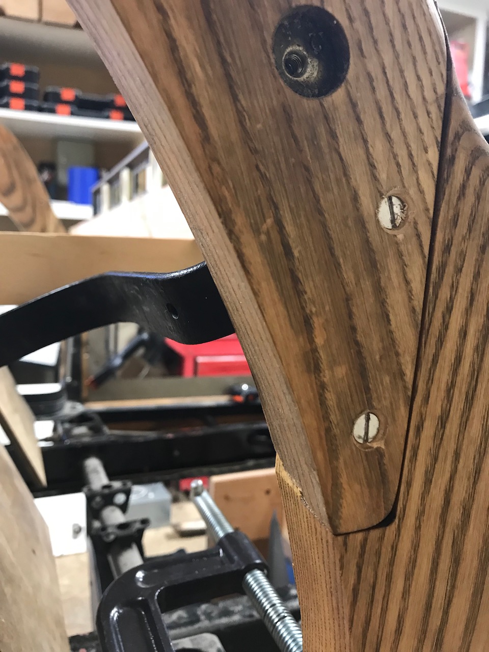

Mike,
I built a new timber frame a number of years ago for TC2911 using timbers from Moss, some flat panels that I made up myself, and some still good original bits in conjunction with the measurements from the MS book as a rough reference. I have also built and repaired a number of Morgan timber frames over the years. I had a chance to visit Craig's shop a few years ago as we don't live too far away and found him to be an interesting and cordial character. Bet you didn't know he is a VW guy too, but I digress.
When restoring the above cars it is usually necessary to either make up new panels or repair old panels. If you are trying to fit old panels to new timbers or vice versa there is always going to be some trimming or shaving needed to get things to fit and this is the beauty of the two mediums you are working in as well as the type of vehicle you are working with. I made up new front and rear quarter panels to fit my timbers so fitting was not really a problem. The fit up of these cars is almost infinitely adjustable but the most important part of the project is door fit up. If the dimensions are a touch off as yours are but you have achieved good door fit you should not despair, the appearance and function are what is important. I will confide in you that there have been a number of times when I have taken my MIG welder and added a bit of metal where it was needed. Will also tell you that is a darn good idea to set the tub on the chassis that is on wheels with the running gear in situ as that makes a difference when dealing with a fairly flexible chassis. These cars were built to a price and none of them were quite the same and given time and dampness and miles they are even less the same. Not sure if this has helped, but what you have found is not unusual and you just have to realize that some approximation will be in order.

I too built a body from bits. It appears that your tub is sitting too far forward. The rear of the outrigger should be just forward of the wheel arch (as you have guessed). What is determining the fore/aft location of the tub?
As was discussed in a recent post, I found - as had the poster - that when I fitted my front guards and the running boards I had a gap of about 1 - 1.5 inches between the rear end of the running boards and the fronts of the rear guards. Your location would probably avoid this problem but creates a far more difficult one.

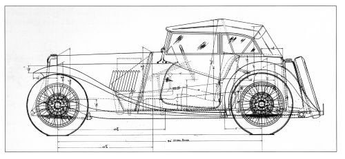

There is something of a mystery. Here is a very poor copy of a drawing that exists somewhere. About the only thing clear is that the outrigger is just in front of the rear arch.

Good catch. When building these things it is almost mandatory to use existing reference points. I left my firewall in place and used some of the existing cowl timbers to locate the thing from front to back. Timbers above the "water line" are almost always still useable and with works holes already drilled provide an exact location to build from.

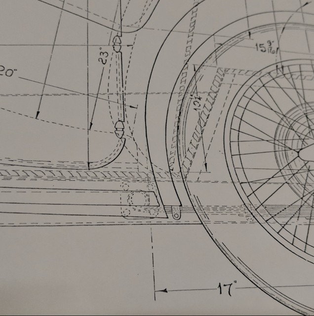

Here is a better view of the area in question on the drawing.
- dimensions.jpg (83.87 KiB) Viewed 9387 times

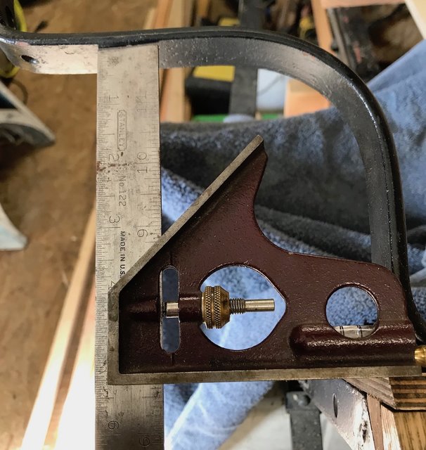

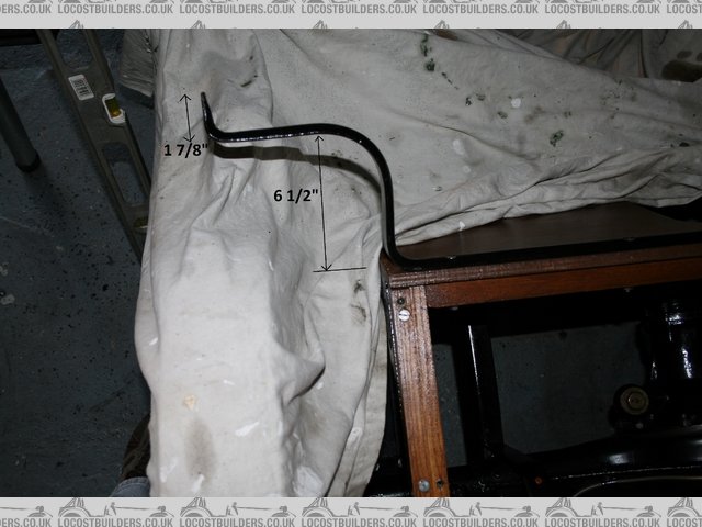

I found a picture on the internet depicting the dumb iron stiffener and measurements. I compared it to what I have and there is a big difference...... It shows the distance from the diff cover to the top of the curve to be 6 1/2" and mine is 5 3/16" ...... !?!?!? Yeah.... Ok I am so open to ideas and thoughts.
pictures as soon as I figure out how to post them.
- 2IMG_7264.jpg (54.9 KiB) Viewed 9111 times
Re: Old topic on tub construction but new for me
That's a picture of my bulls horn that I took for someone on here a couple of years ago. Its probably also in a discussion thread on here somewhere. In practice, you have a bit of flexibility with the dimensions as there is a bit of padding between the bulls horn and the inner wing. Having now fitted one of my inner wings, I could have gotten away with slightly less than 6 1/2" (but probably not 5 3/16"). That said, looking at my original old and rusty inner wings, it looks as though they underwent a fair bit of metal tapping to get the profile to fit both the bulls horn and the curve of the wheel arch as defined by the wood frame.

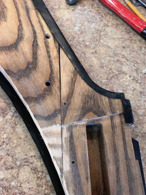

Ok, here is what I have.
In my 2nd picture above it shows the bullhorn in where the wheel well is.
