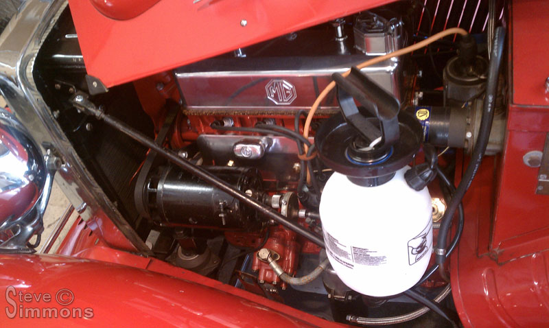

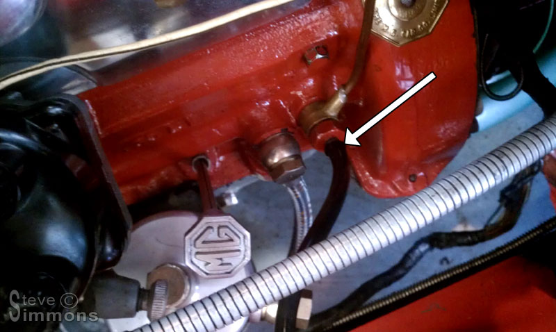

I didn't have to prime my pump when I replaced the lines. I would just crank it over without starting and see what happens. If you do have to prime the pump, there are two ways I have done it.
First is to remove the pump cap and pack some Vaseline in the vanes. The other way is to buy a pressurized garden sprayer and fill it with oil. Connect the hose to the lower banjo fitting, where the oil pressure line goes. Pump up pressure and when you see oil come out of the rocker arms, you should be good to go.
