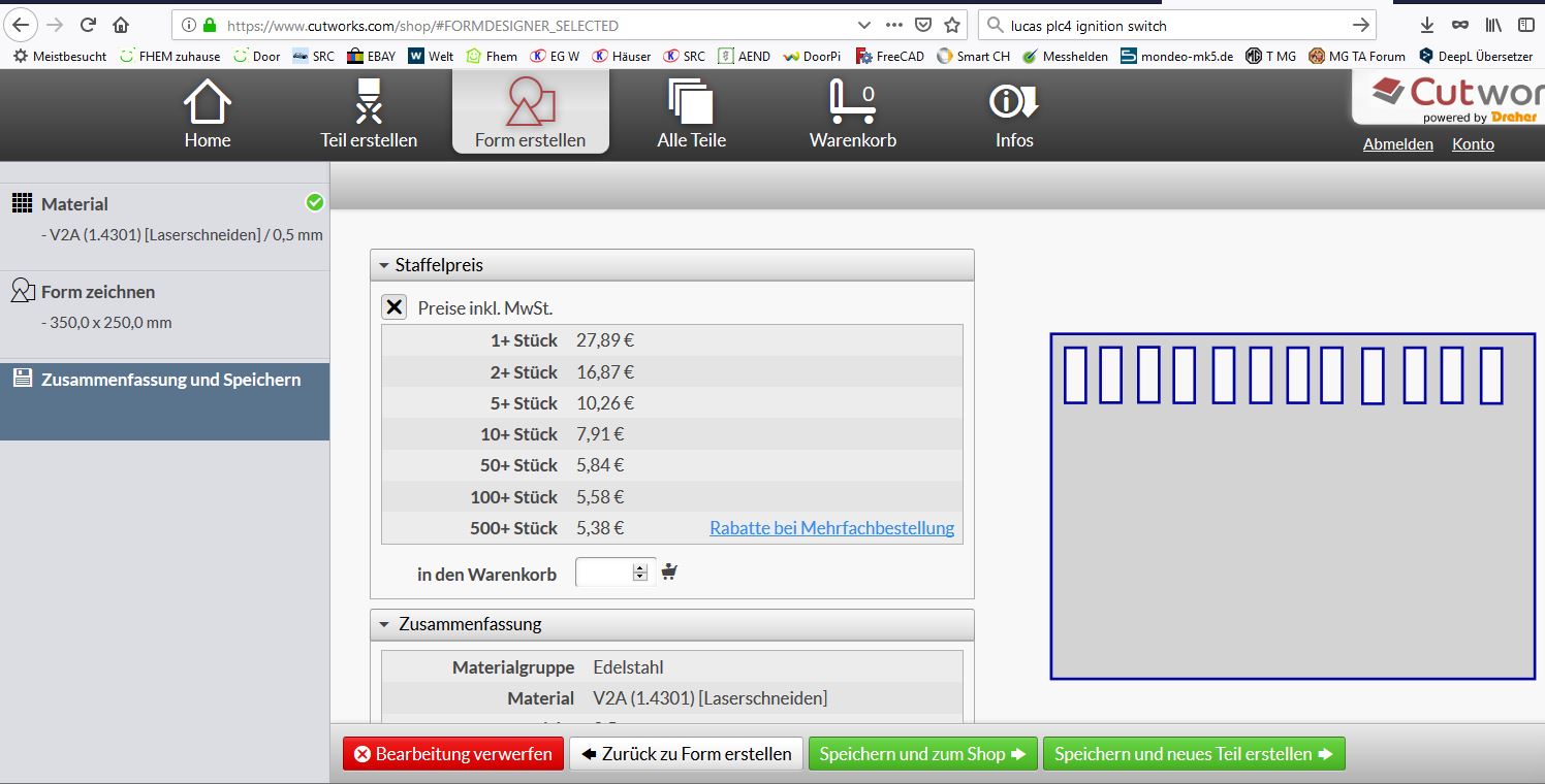

so i cleande the airbox, one previour owner has spray the hole box also the filter inside,
1 hour fuel in out and so on
so i thougt about a new one with a modern inlay
i had ordern 3 years ago a laser cut part
so i just looked what it would cost to make it from stainless steel 0,5mm
weelding at the back the rest id on tknow in the moment.
i want a original like one too, but modern funktion inside like my cjr3 case with lucas 340 ;-)
welding stainless steel no problem
i know someone who has a machine to make something like a can
