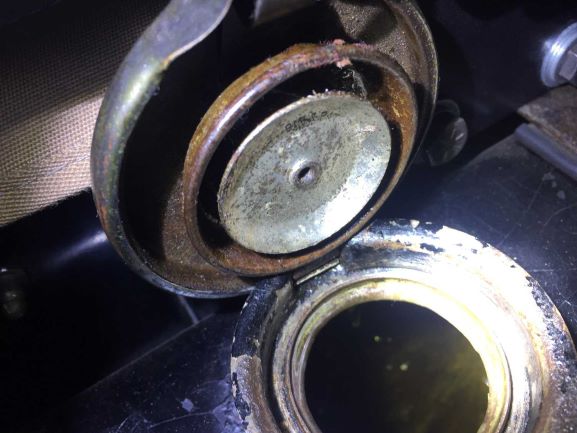

Re: Petrol Cap
Post by Duncan M » Fri Sep 27, 2019 9:31 pm
Doug is a great source of parts, and his "tech tips" are full of useful info. He will not mind if I take issue with how he has assembled the cap. The "cup" just beneath the bronze nut and above the cork seal in his CR182 pic http://www.chicagolandmgclub.com/techti ... sembly.pdf appears to be upside down. In my pic the cup is the nickel colored disc. My pic is of my preservation '49 TC's cap as put together by the factory. Missing is the cork, no doubt turned to dust long ago. I drive the car often and have never seen a drop of spilled fuel, but I seldom fill the tank much above half full.
TT_CR182_Gas_Cap_Assembly.pdf
(104.22 KiB) Downloaded 192 times
