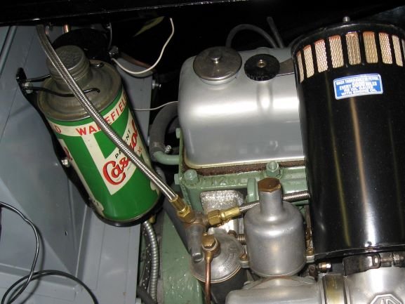

Post by TC9800 » Thu Jun 18, 2020 12:51 am
Bracket shown in attached image. I found drilling the front of the battery box is most easily done with the engine removed.
