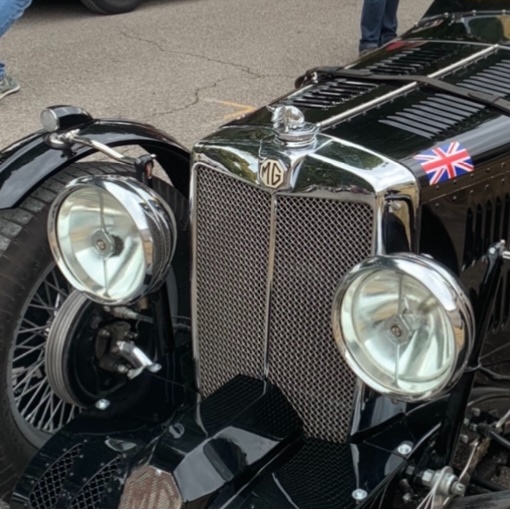

This 8“ tripod reflectors are looking great.
Where can I get them? What company produce this? I saw some cars by GP Nuvolari in Italy, they had in the middle from the tripod a MG logo
Franz
Franz
Re: 8 inch Headlights
The owner told me that this great car was made by Steve baker. There had been 2 there

The MG logo lamps were standard on some pre-war cars.

Franz shows the Bi-Flex spider in the pic above. Lucas made those lights in 8 & 9 inch, and it was done to throw light further down the road. Many Pre War MG's came with those Bi-flex spiders. The tripod style was never used by the factory on any pre-war MG or the TC.

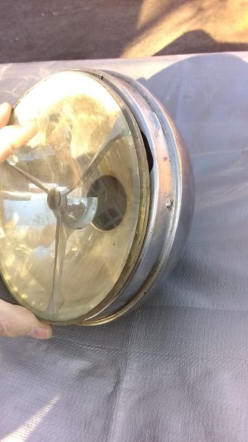

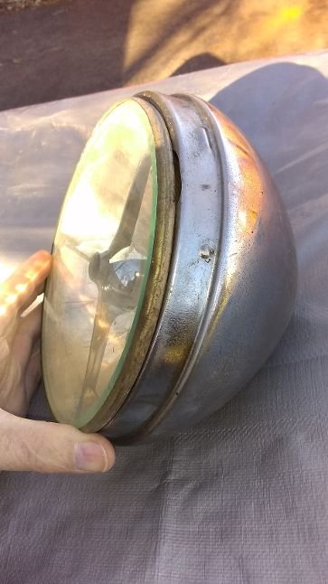

Here is my L140 headlamp bucket with a PF770 headlight inside.
It's the same size as the rim, but hard to hold in place with one hand while getting the picture with the other hand.
It really doesn't look like a viable solution.

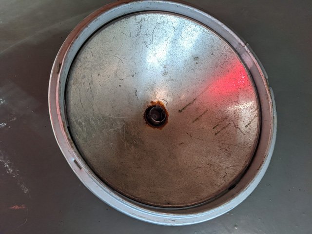

I'm still looking for my spare reflectors, but In the meantime is this the type you're after?
- dipping-reflector-1.jpg (55.32 KiB) Viewed 4821 times
- dipping-reflector-2.jpg (57.59 KiB) Viewed 4821 times
I suppose that must be the correct one for the left side.
Not quite sure how it would attach to this support ring. For the right side I believe it does not dip, just goes off when the left one dips.

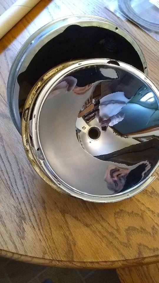

Today I received a pair of EL644c reflectors from Frame Up, @ $600.
I don't understand how they are supposed to be attached to the L140 buckets.
Am I still missing some kind of clips or something?

Am i right in thinking there's a few wires wrong in the responses to the questions?
The W shaped spring clips don't hold the reflector in at all; spring clips hold lens into to the rear of chromed rim ... often 3 for 7" and 4 for the 8"+ rims.
The reflectors are inserted into the bowl by aligning the reflector tabs/ears then twisted approx 1"left or right so to align the hole where 2x 2ba screws secure the reflector to the bowl.
The options used by MG for pre-war and post-war MG's was different, so like the TA being pre-war used a different designed Lucas L140 to the ones used on the post-war TC; also the TA L140 had different lens and fittings to the P-type, J-type, F-types etc

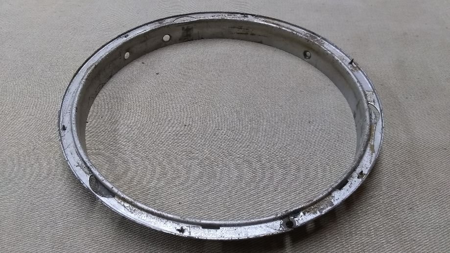

Ok thanks Chris, I think I get it now.
I don't need W wire clips in these.
Looking at my buckets, I have four spots where the edge is scalloped in, at 2 o'clock, 6, 8 and 10 o'clock.
There are also tiny screw holes at 11 o'clock and 1 o'clock in the edge of the buckets.
The reflectors have tabs sort of punched down at 2, 6 and 10, which I think are intended to be inserted in the scallops.
There is also a hole in one reflector at 12 o'clock. The other reflector has a notch there.
But the tabs don't grip the bucket, there is a 1/16" gap, so they slip around loose. That is what confused me.
These reflectors appear to be restored old items, not new. That is why there is a notch, it used to be a hole but got torn out. The tabs are bent out too much.
I think I need to bend the tabs down so they grip the bucket when I rotate the reflectors. Sort of like the screw top of a jar. Then I can rotate the reflectors to either 11 or 1 o'clock and get a screw in there.
Studying these further: The old inner rings I have are probably both designed for mounting the solenoid operated dipping type reflector, and the scallop at 8 o'clock may have been for clearance in inserting the solenoid, though perhaps one reflector had no solenoid and didn't swivel. The screw holes at 11 and 1 o'clock may be to allow for dipping left or dipping right.
BTW I have W wire clips holding the glass lenses into the outer rims, 4 in one and 3 in the other. The rust from the clips has soaked into the glass a bit, didn't come off with dish soap, hope I can scrub it out.
There are remnants of something on the rearward edge of the glass lenses, probably some sort of seal. Frame Up included cork seals with the reflectors. I see little sharp points on the edge of the reflectors, which I suppose are intended to grip the cork seals. I'll put them in with Permatex.
