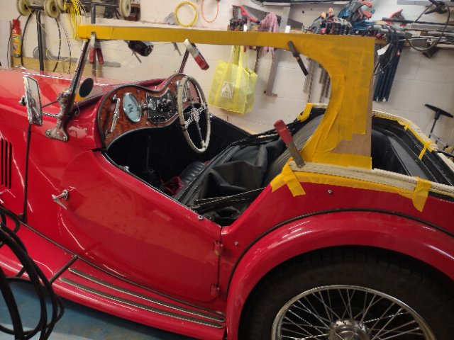

Re: MG TA1932 in Germany - Blog - all problems and ...
Hello, in mgexp I got an answer
The angle of the tip is not OK
The reason was that the front wheels were 6 cm higher than the rear wheels.
Now the templates are absolutely 4 cm lower than before
Now the roof line follows the overall line of hood and body
So step by step Forward
Should i Take Polyester or epoxy
I think epoxy
Have some PU plates in my cellar to make a sandwich from it at the side and around the window in the back
I think epoxy

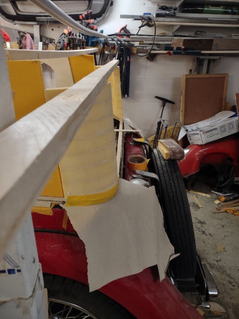

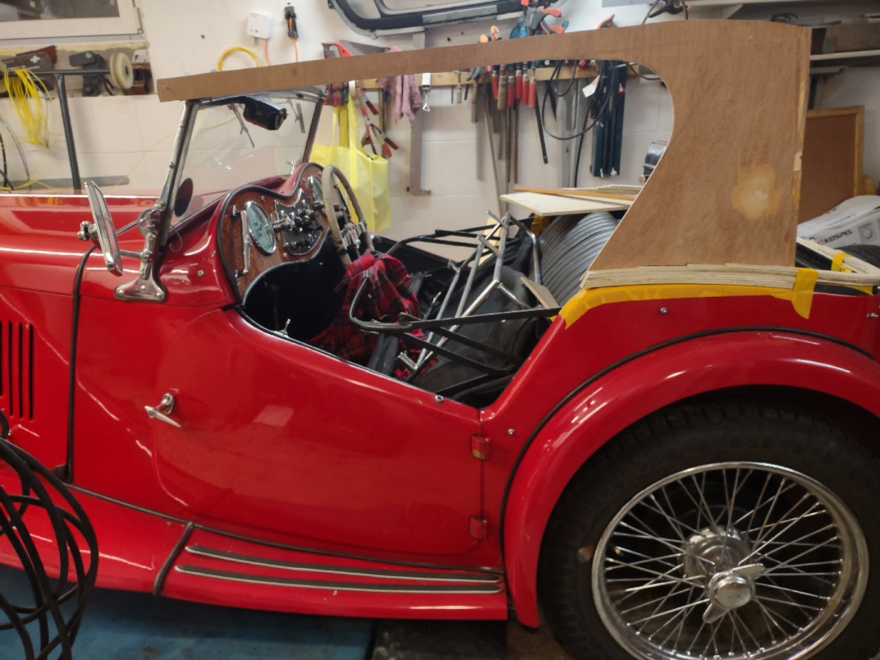

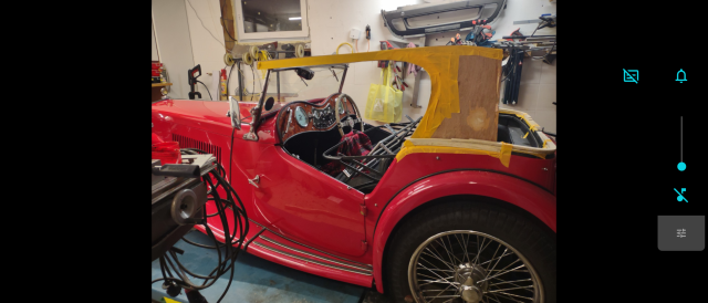

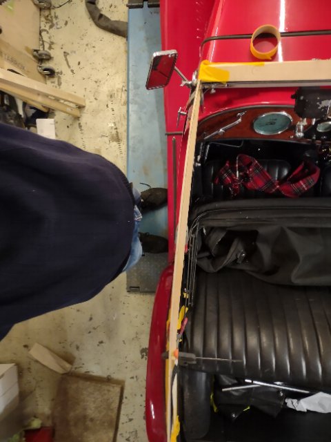

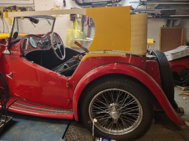

Today
I went to a store and bought some plywood for the next steps
then I made some changes to the part I made yesterday,
now it is approx. + 1 cm from the front of the A pillar to the end of the b Pillar
so it almost follows the shape of the body,
I tried to get into the car and tested whether I could sit in it
i can
I will make a sandwich on the B-pillar, 6mm plywood inside xps 20 mm and 3mm plywood outside
and make a mounting point there
so i will have a good strenght of the hardtop in this position
I will use the seat adjustment to hold the hardtop in the middle
in the front i will use the screw that you have to loosen to fold the windshield forward
this can also be opened and closed very quickly and you will hardly be able to see it
understood ???
also i made a part to bend the wood between A and b pillar
now it follows the shape of the body
i can
understood ???
- IMG_20231128_201240804_MP.jpg (52.63 KiB) Viewed 52785 times
- IMG_20231128_201323262_MP.jpg (66.28 KiB) Viewed 52785 times
- b pillar.jpg (35.34 KiB) Viewed 52783 times
- IMG_20231128_201234797_MP.jpg (70.97 KiB) Viewed 52783 times

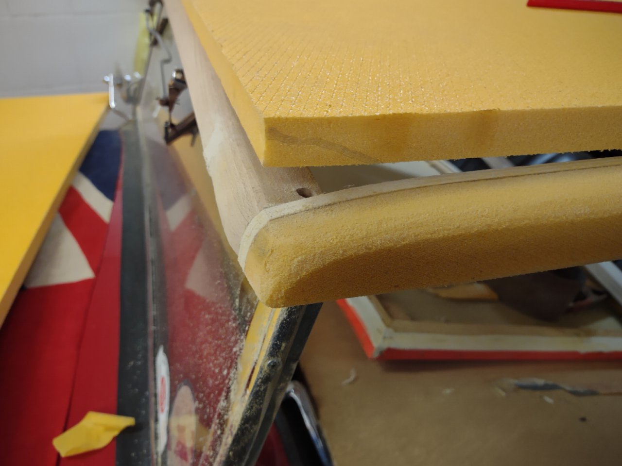

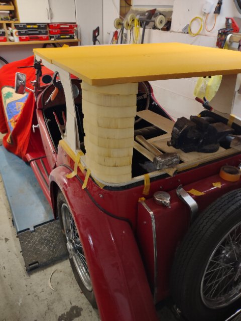

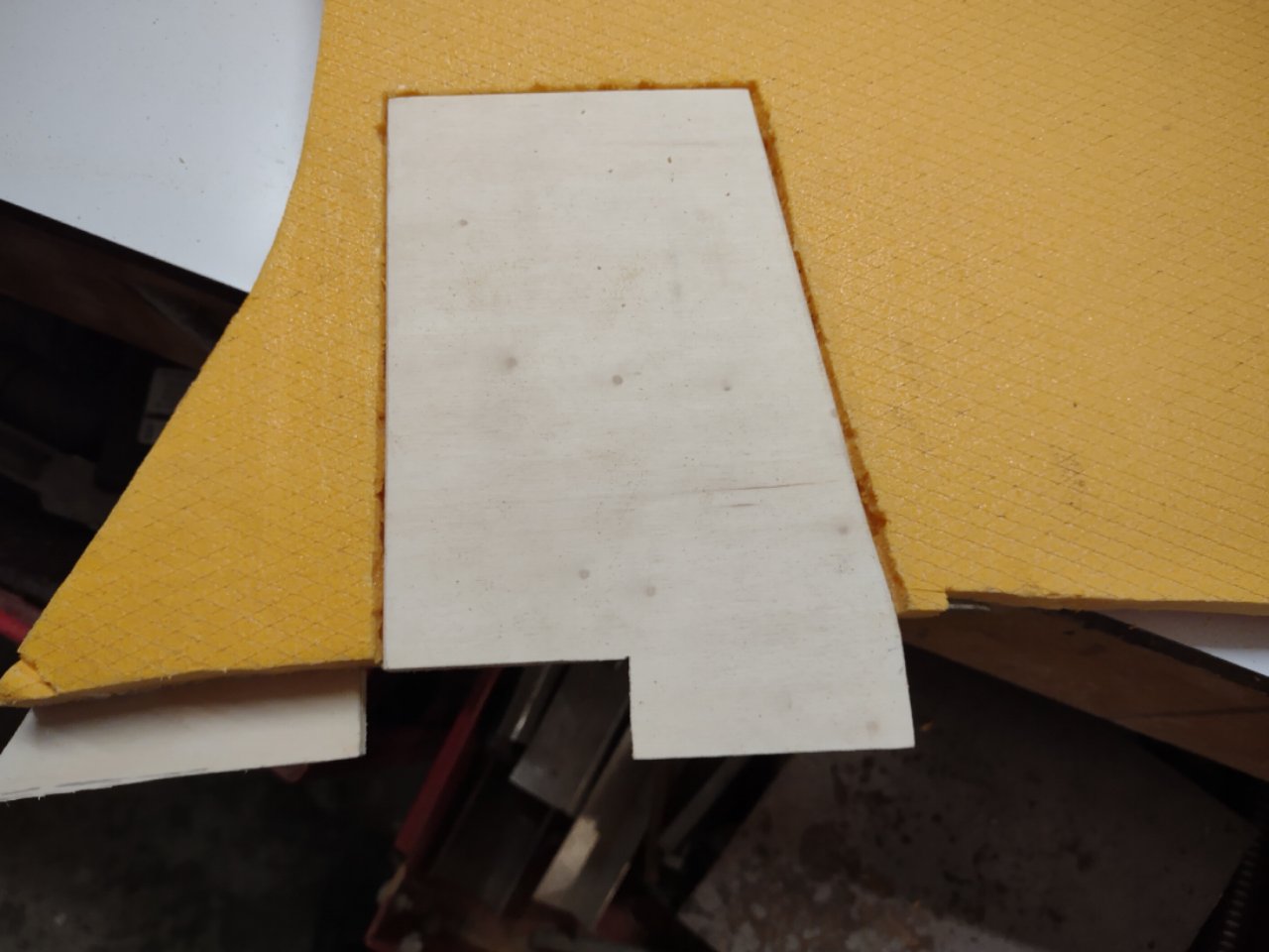

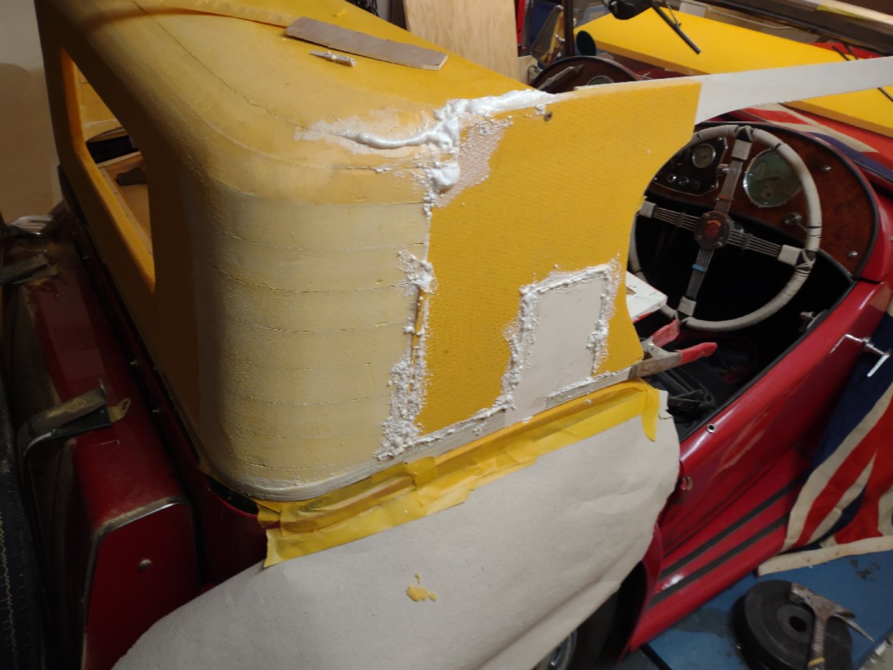

next step done
i had cut out the wooden parts for the b pillar
there i will make a sandwich as you can see in the pictures
also i cut parts for the cornerr in the back
will glue them together with pu
then i can grind them
here only to see how it could bee
got 10m2 carbon in the bay in an auction
i think someone is angry now ;-)
i give my order in the last second
- IMG_20231129_184905250_MP.jpg (46.72 KiB) Viewed 52764 times
- IMG_20231129_184911667_MP.jpg (47.7 KiB) Viewed 52764 times
- IMG_20231129_193304050_MP.jpg (57.65 KiB) Viewed 52764 times
- IMG_20231129_193315014_MP.jpg (59.45 KiB) Viewed 52764 times

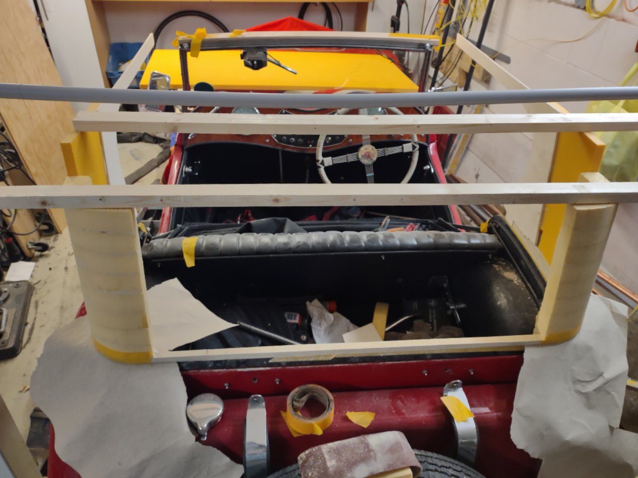

today my wife wants to go to a restaurant
so less time :-)
but

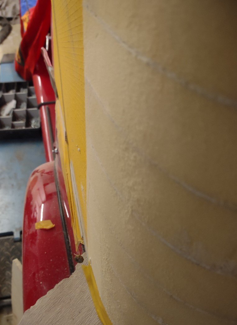

i glued some parts together with pu
will make some pictures tomorrow ( no - later ;-)
under the shower this evening i had good ideas for the next steps
you will see it
difficult to grind the xps when it is on the car so i will grind it before i will glue the next parts together.
had a good dinner and a fine beer ;-)
and when I got home, I went into my garage
there the parts I had glued together were perfectly put together
I sanded them for a few minutes and put everything together, not glued yet, but the way it should be in the future
so the path I have taken is the right one so far
i hope it will go on like this

- IMG_20231130_202323930_MP.jpg (57.76 KiB) Viewed 52743 times
- IMG_20231130_202334064_MP.jpg (44.71 KiB) Viewed 52743 times
- IMG_20231130_202446802_MP.jpg (49.8 KiB) Viewed 52743 times
- IMG_20231130_202556152_MP.jpg (61.99 KiB) Viewed 52743 times

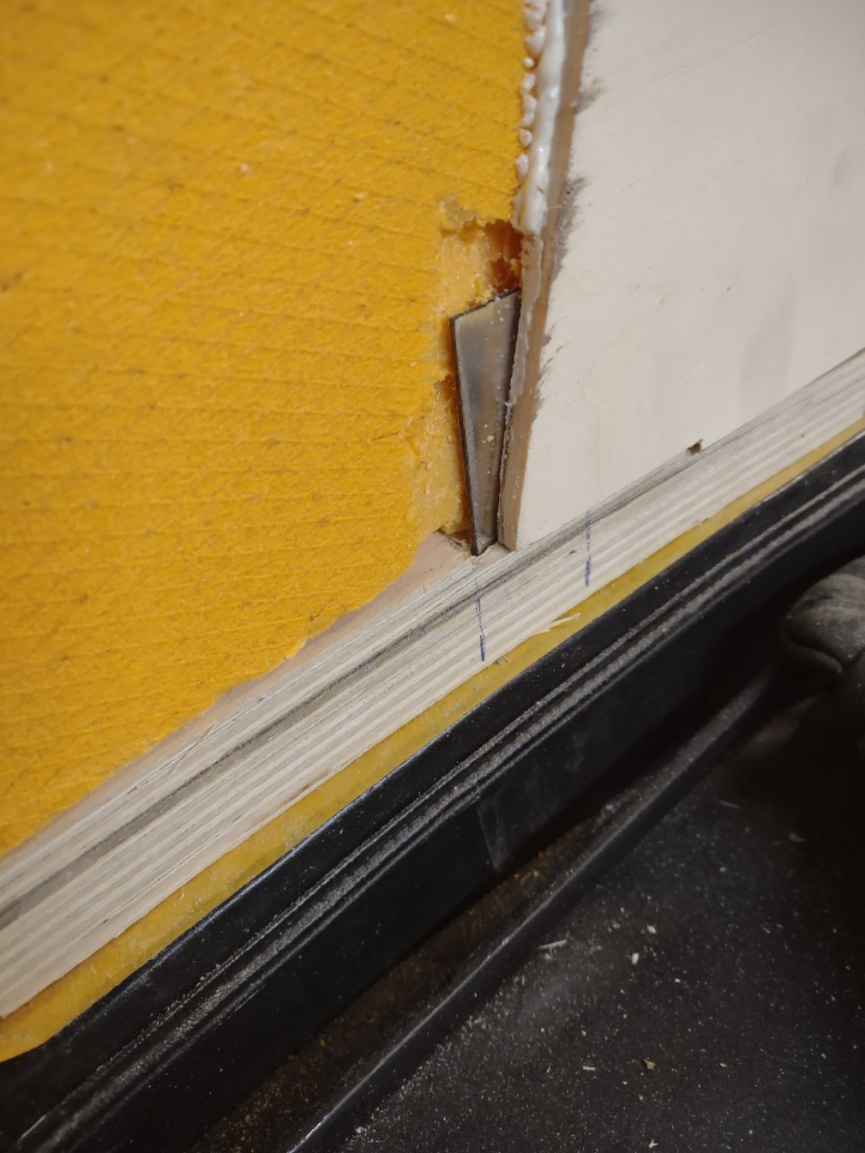

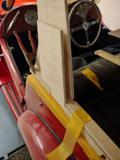

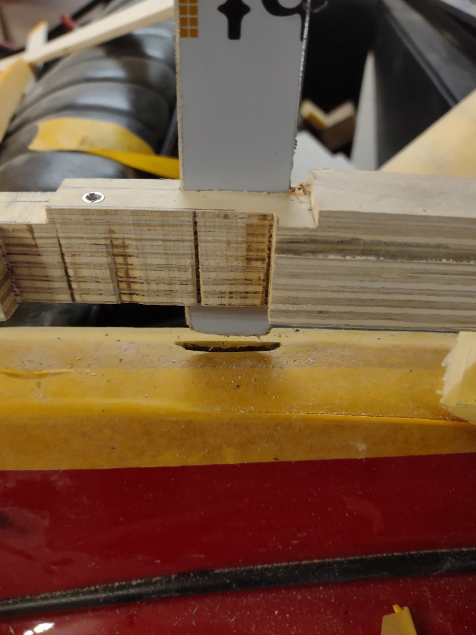

Hi
first i made the holes for the fixing points at the b pillar
as you see in the pictures the steel sits perfect in the wood
will glue them with epoxy
in the back i checked if the car stands right

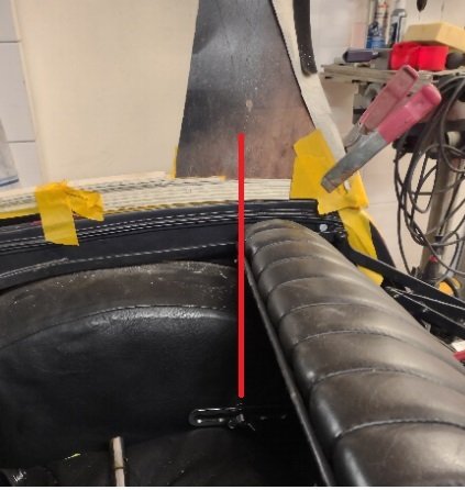

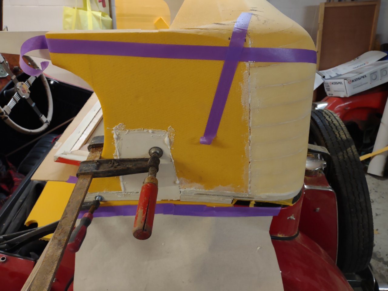

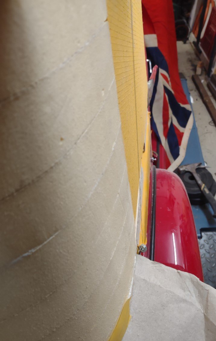

next step
I glued the corners to the wood
I checked the positions with a plumb line as you can see
about 1.5 cm inwards on both sides
this is now one of the most important steps
have to check everything if it is hard, hope everything is ok
if not I have to cut away one side

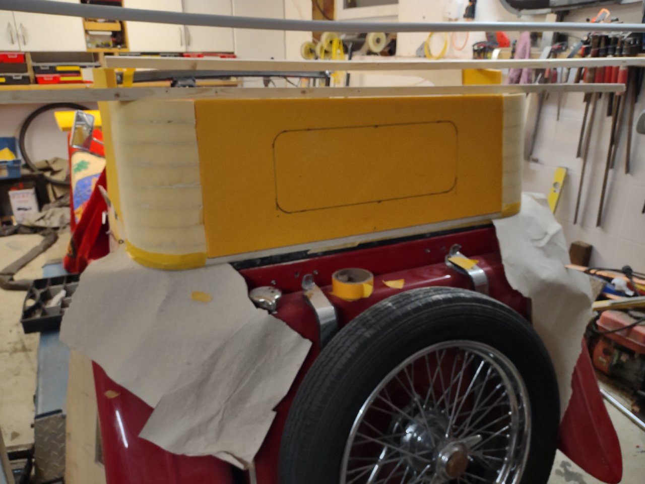

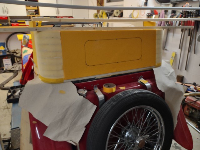

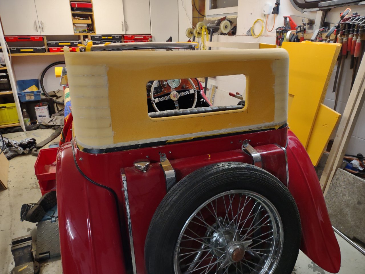

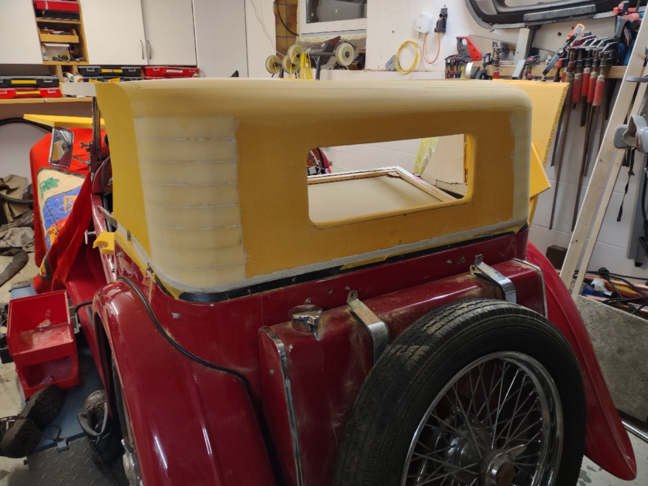

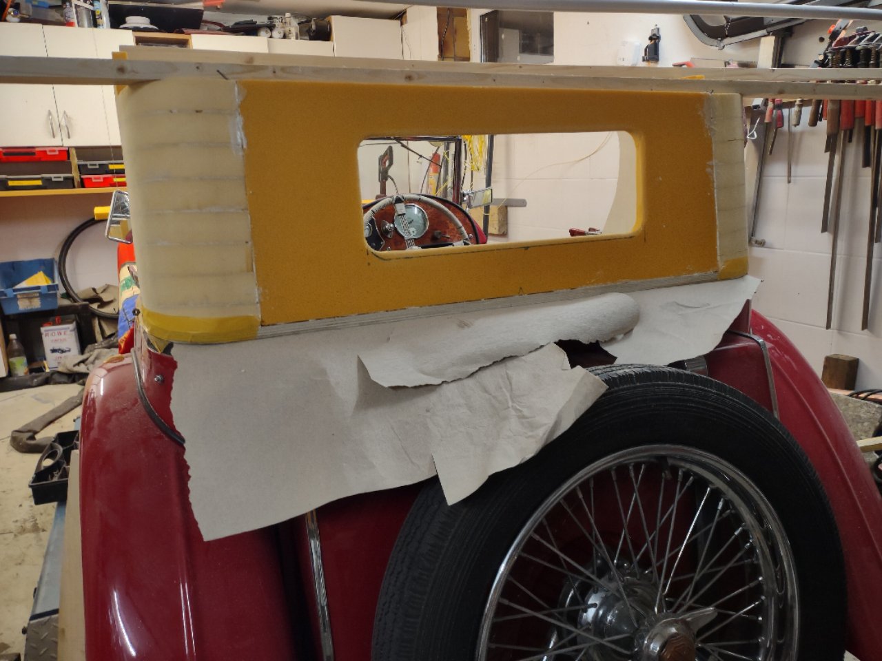

the corners were not really hardened
but hard enough that I could do the next step

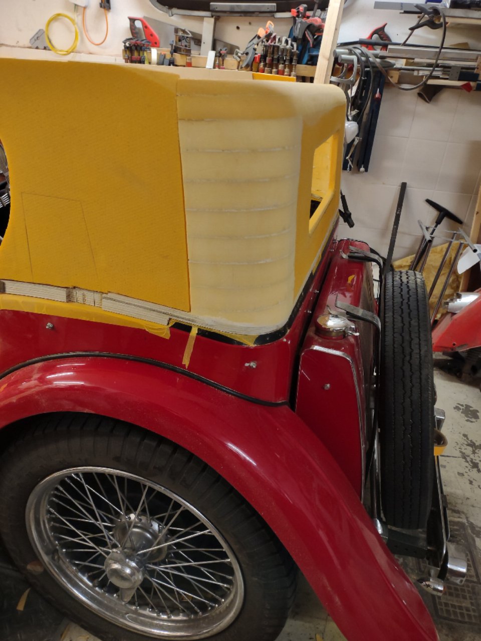

as you can see I cut a part for the back
first I marked the position for the glass
then cut it out and glued it in with Pu
i am really happy with the result of the moment
the window i will put in as i have done it with my ta
i think it will work without problems

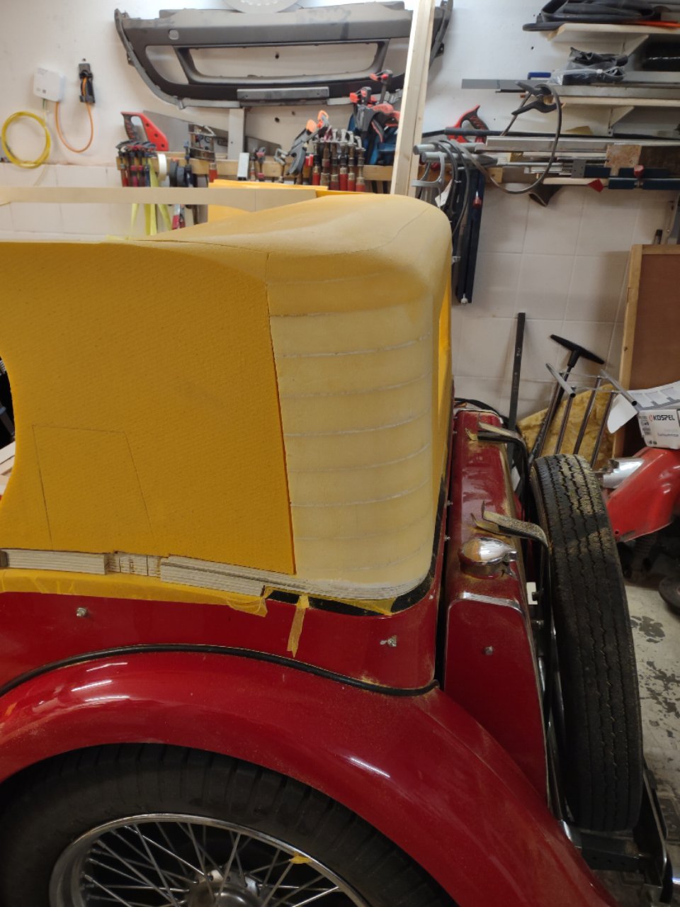

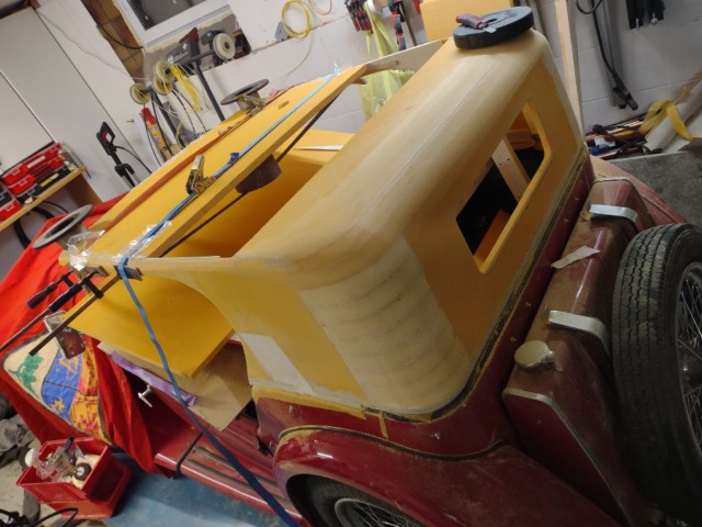

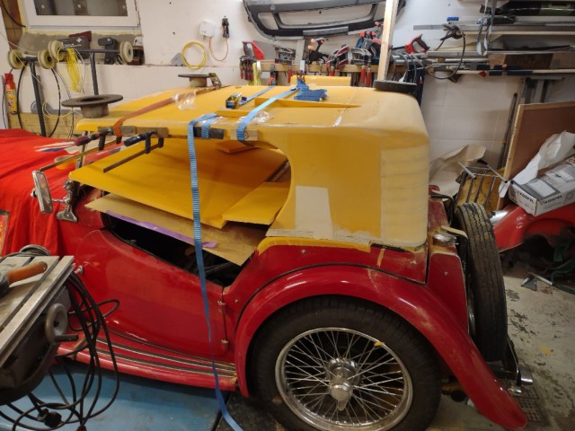

next steps this morning
i have a good run ??!!
easy to sand because it's really stable the way i did it
so 2 more xps layeres and sanded them after i glued them down
now i need to make some templates so i can check both sides
should be the same
it is such a fun to make it
should be the same

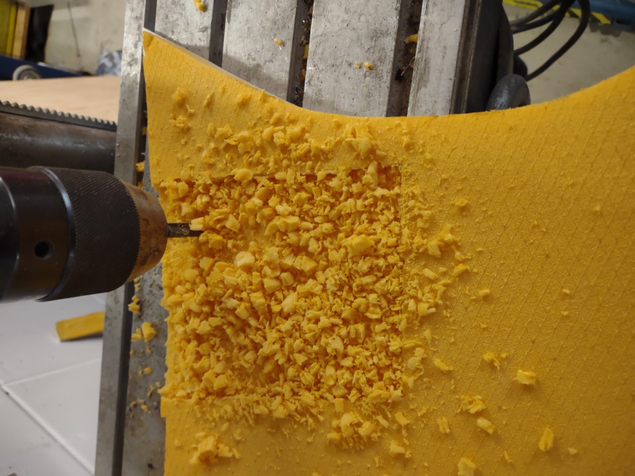

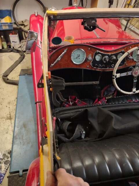

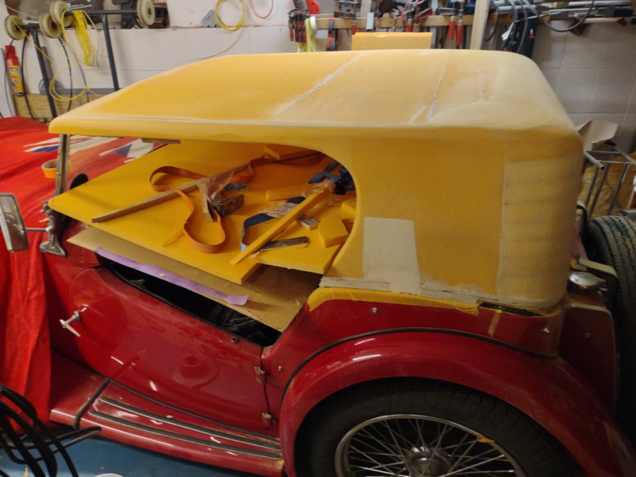

in the morning i prepared the b pillar on both sides
I took my drill and cut 6 mm deep into the xps
then i glued them in with pu
then i put some wood glue on the wood and pu on the edges of the side parts and put that in place
then i put them in
seom hours later i grinded both side
then i put them in
grinded the front wooden rail
adjusted the sides in the front , glued them and fixed with one screw
after this i took some xps and glued it to the sidepanel
grinded them
the last step was to glue in 2 xps panels for the roof
now i have to wait until all the pu is hard
until this step it was much easyer and faster then i thought before
really happy and a little bit proud
one big difference between a profi and me
my garage is chaos pur now
only 3,5 x 7 m and a lot of stuff in it
not much room to work
grinded them
A 1933 MG Magna with aftermarket removeable hardtop.
i am silly
i can t wait
i want to see how it looks like
still a lot of work
but i like my result for the moment
have to make the finish grinding
but like this it will work with the expoxy and the carbon
i can t wait
still a lot of work

You are making good progress with the hard top. I could have missed something but how is it fixed to the body? You need a really strong attachment to stop it blowing off at speed!
look to the b pillar, there i will have a strong fixing point with a sandwich from: cevlar wood xps wood cevlar
there i will make one ficing point to the back seat fixing, i hae written it here ..
perhaps in the front at the one extra point too
Nice progress, but keep in mind that at speed there will be wind buffeting if the finished roofline is flat (as it appears in latest pic).
Hi Ducan
yes in the moment it seems to be flat
but it will be curved when i put on the carbon
curved like the windshield in the front
have to put something under the roof before i do this
there is nothing in the moment....
Amazing progress Franz and looking very practical, bur perhaps consider that it should be somewhat flexible when complete as our cars twist so much and you don't want to risk damaging the windshield, cowl, or the hardtop. Don't know how cars fitted with a steel roof fared but most models usually had unitary steel cowl windshield surround pressings.
