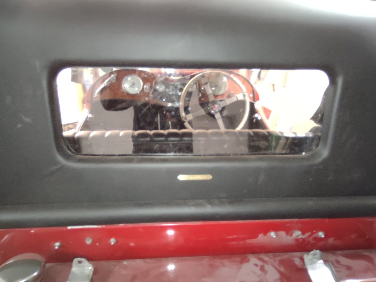

Hi here with the Hardtop on the car
as you see i can use the tenax with the new parts inside the car
with this one tenax the rear side screen secured perfect
have a idea how i can make a junction to the front side screen s
so no rattle when i drive

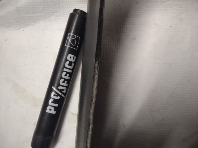

I took a black pen to make the edge black

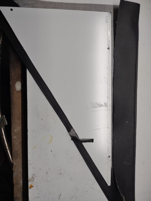

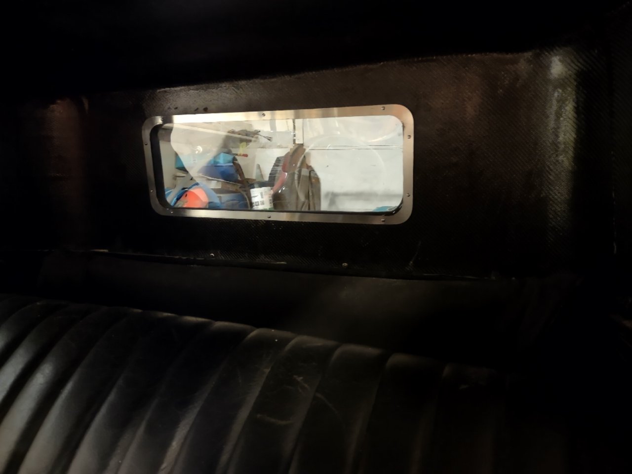

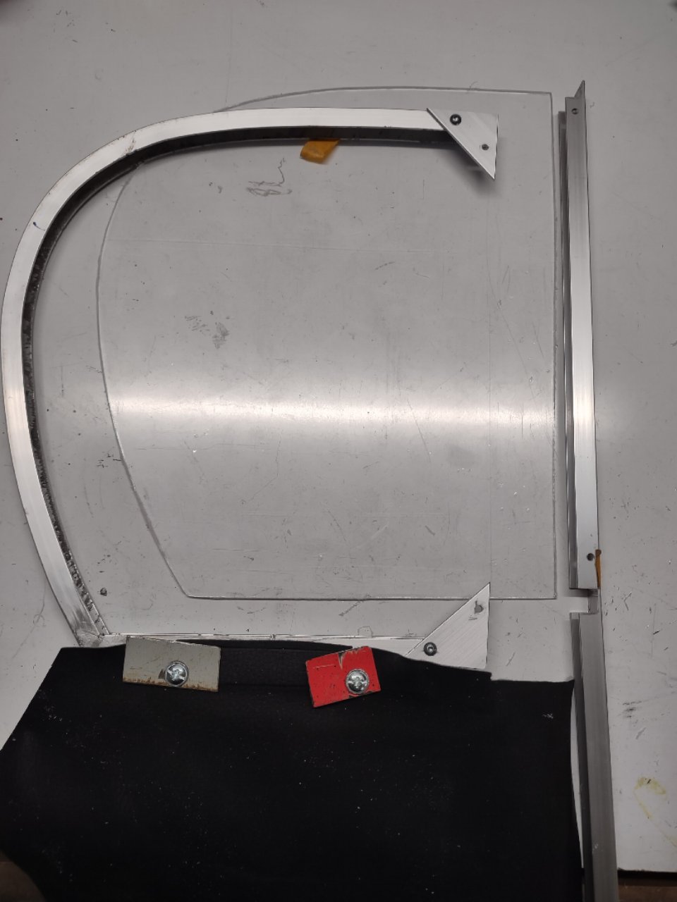

today I made the frame for the rear window
first I wanted a laser-cut aluminium part, but the workshop has no time for that
so I used a 2mm aluminium sandwich plate that I used for my heat pump a few weeks ago
It's light and easy to work with and I have a lot of it in my garage
I cut it with my bandsaw and drilled 4 x 40mm holes in it, then cut it with a scroll saw.
10 holes for the screws
finished
It looks great.
I also sewed leatherette with foam so that I now have a sealing lip at the front that closes the gap between the window frame and the hardtop.
have to paint the red part - forgotten ;-)

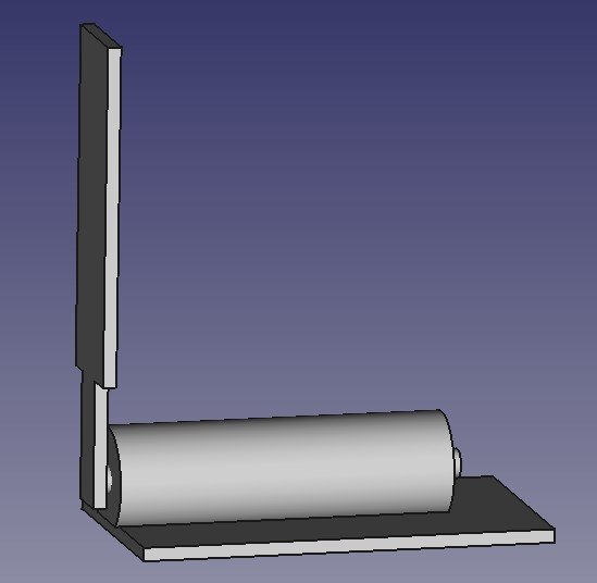

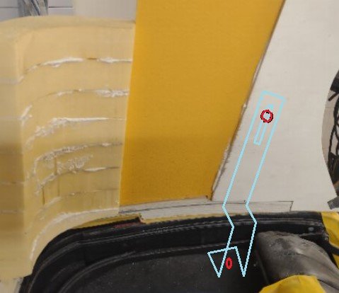

also have an idea for the mounting point on the B-pillar
could do it with steel ( snapshot )
but maybe it's easier with the strip from the picture
I could pull both up between the roof bars and the bodywork
both could stay in the car
so fast and easy to istall it after i have put the hardtop on the car
at the star i could fix it
a m16 screw from the outside to the inside and a nut to hold it in place inside
a MG octagon sign outside to make it fine ;-)
but the 2nd solution would be much easier to attach to the attachment point on the b-pillar
steel isn t flexible
what do you think

just ordered the next parts for my solution at the b pillar
i hope i can make it like i want to make it
you will it see next weekend ;-)

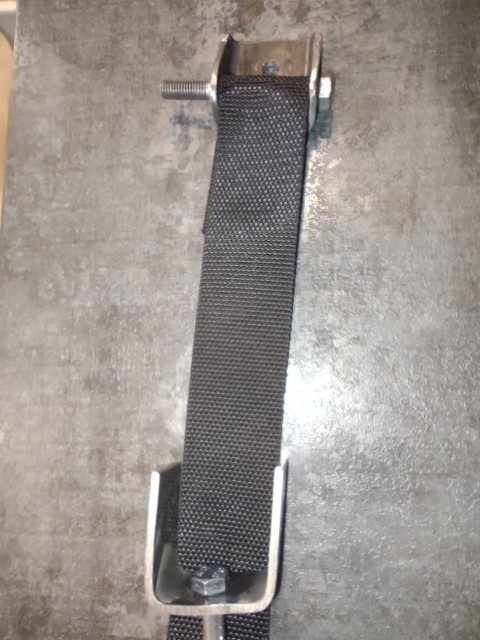

I received the parts I ordered today
the U-steel and some more
I cut the U-steel as you can see on the pictures
I will use one on the B-pillar and the other on the rear wheel arch
I will make the black band so that the roof has 5 mm free space here
but the road tests will show that
to install the hardtop i have to put the screw through it, simple and fast

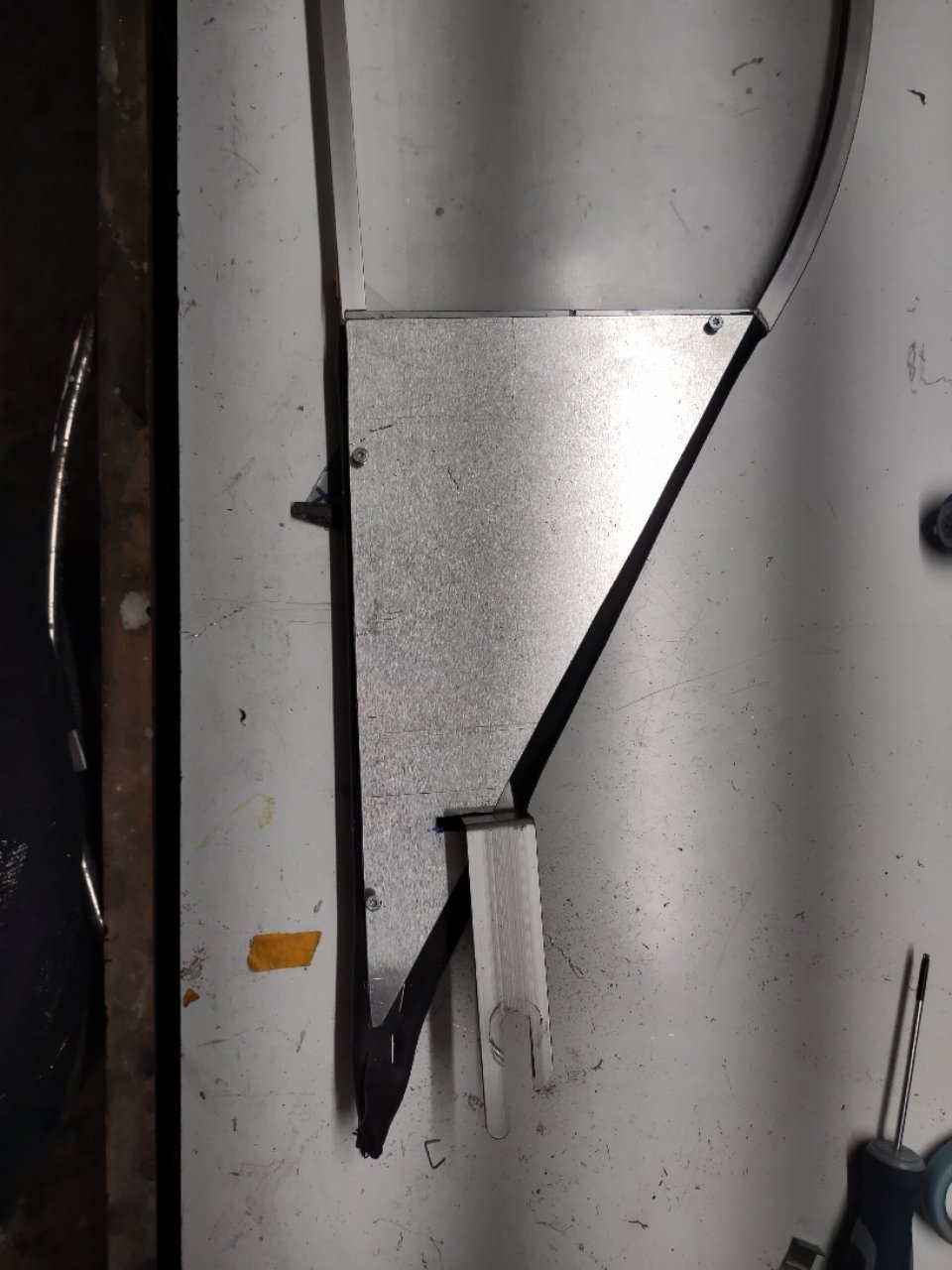

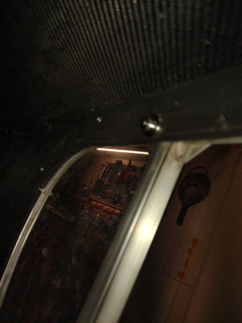

yesterday I made the right rear side window
this little part was the most time-consuming thing I had to do for my hardtop
it took me three hours just to make the last leatherette part
first I had to open the front aluminium profile to be able to insert the window
then I removed the aluminium sandwich part
put the leatherette under the front
fixed it with two screws
then I folded back the leatherette
now you can't see the screws anymore
then I put the leatherette on top under the sandwich and fixed it with a screw at the back
the only screw you can see now
at the end I used a needle and a thread to close the rest

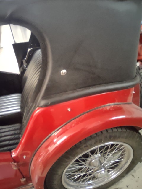

beautiful weather in the afternoon, so i could open the door from my garage
it makes the work much more fun

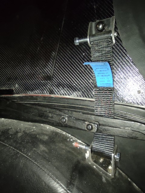

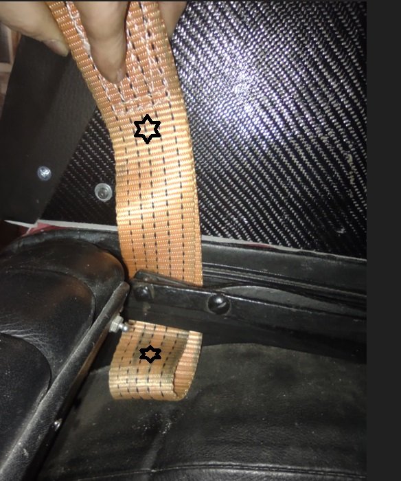

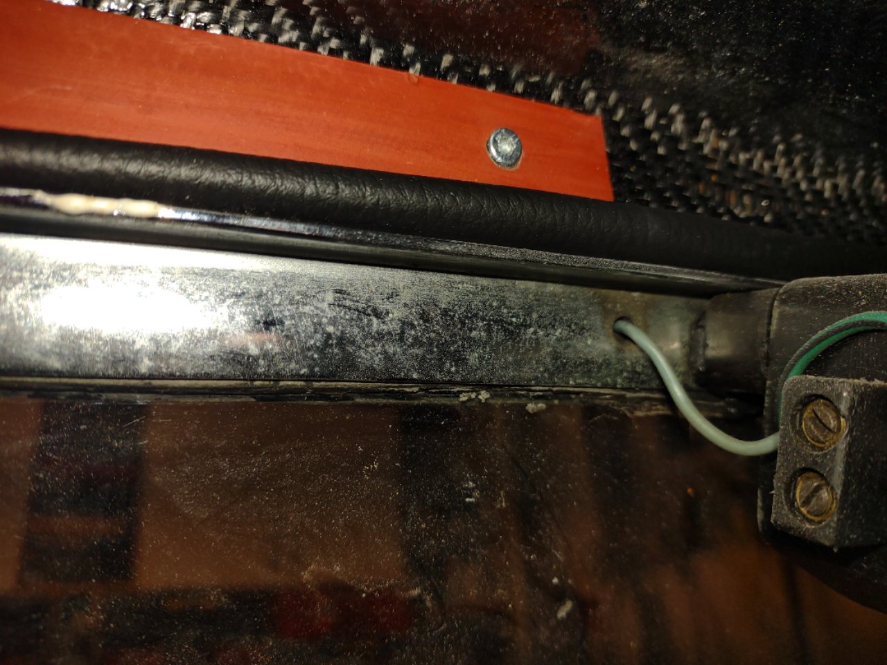

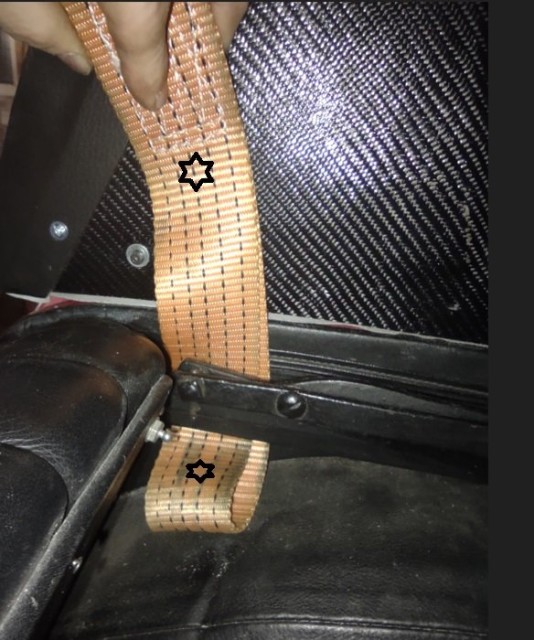

I made a new lower bracket for the straps
everything is working perfectly today
welding the lower bracket,
made a few holes

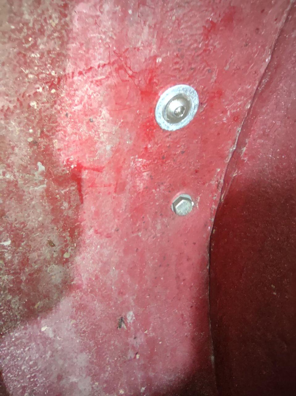

made a thread for the screw that holds the part from the wheel arch
when i took the rear wheel off the body did what i thought it would do
the hardtop went up about 5 mm
the rear side window follows the hardtop the bottom holder isn t closed
like this it is ok , the window is fixed with two tenax
then i installed the upper bracket with a 5mm clearance
I still have to think about what to do with the screw that you can see from the outside

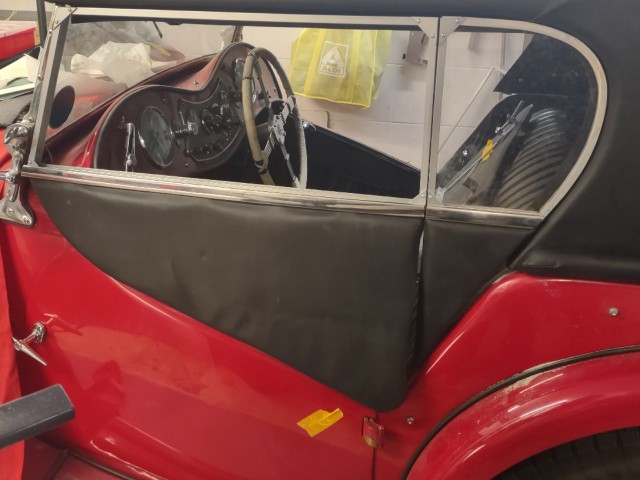

What a wonderful day,
one of the first days of sun and warm
perfect
a day to ride my TA
at first I only wanted to drive round the block once
but the car runs perfectly with the hardtop
no problems
i drove over humps where the body twisted but the roof went up only a few mm 3-4 as expected without the retaining straps having to go into action
I drove without side windows at 80 km/h and everything was safe
so proud

It was fun, from the first step to the first ride today
In the beginning it was just an idea
I have never done this before
I had a plan in my head and only the two pictures of the black TC
but as so often in my life I said to myself
there is no such thing as can't
it's worth a try
it turned out better than I had hoped for
when I drive over a hole in the road it still makes some noise
it just hits hard at the back
I'm going to try it with some felt, if that doesn't work I'll use a modern foam
I'll think of something.
