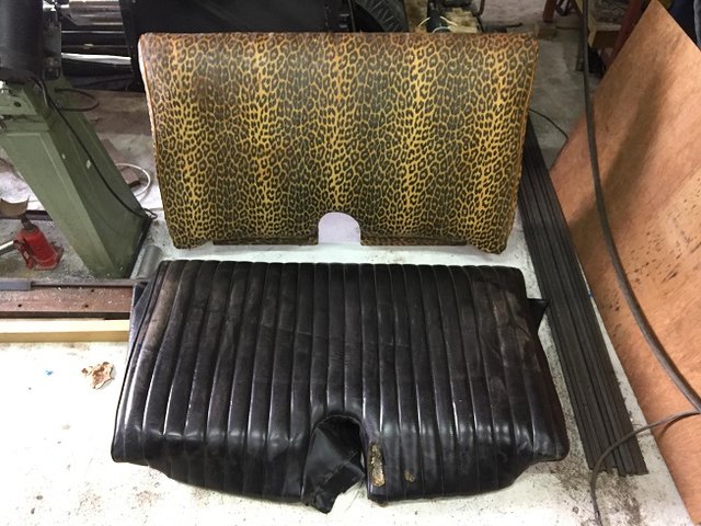

So I thought getting started with the seats will be an easy start as I had already made the bases.But no slides, no hinges attaching the bases to the back rest, no wheel arch cover brackets to adjust the back rest.

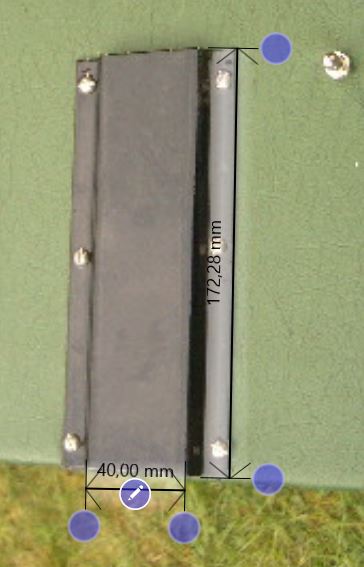

So I thought the easiest would be to make the hinges. To get the sizes I removed the sear cover hoping to het some witness marks to help with the re manufacture process.
This really make me wonder about the history of this car. And this cover is old. On stapels everything is done with tacks.
Can anybody help with some dimensions especially material thickness? I guessed the hinge is about 40mm wide by 5 mm thick.
From my backrest the hinge slide is only 150mm long. The app I used ro scale the pickture indicates it is about 170mm long.

If you are making a driver (as opposed to original specs) you do not need hinges. I needed more leg room so I took out the jack handle (behind the seat) and made new seat cushions. I just used a piece of plywood and foam for the backrest- spray glued the foam to the wood, then cut out and stuffed in foam until i got the right shape and it was comfortable for me. Seat bottoms are plywood with a built up front, then again seat foam added or removed to make it comfortable. I have no seat slides, seat bottoms are just placed on the carpet, I have a pin in the floor and a few holes in the seat bottom plywood to keep the seat in position. Backrest is just placed on the back of the seat bottoms. seats do not move while driving and are quite comfortable. Moss leather kit makes Seats look original, but I am not doing car shows. I have done several trips of 400+ miles in one day.

I am 6'2" so also need all the space I can get, I also do not have seat slides and merely wanted the hinges to tie the whole lot together. I do not think I will loose any space by fitting the hinges. I do not even have a jack so that is no problem :lol:
