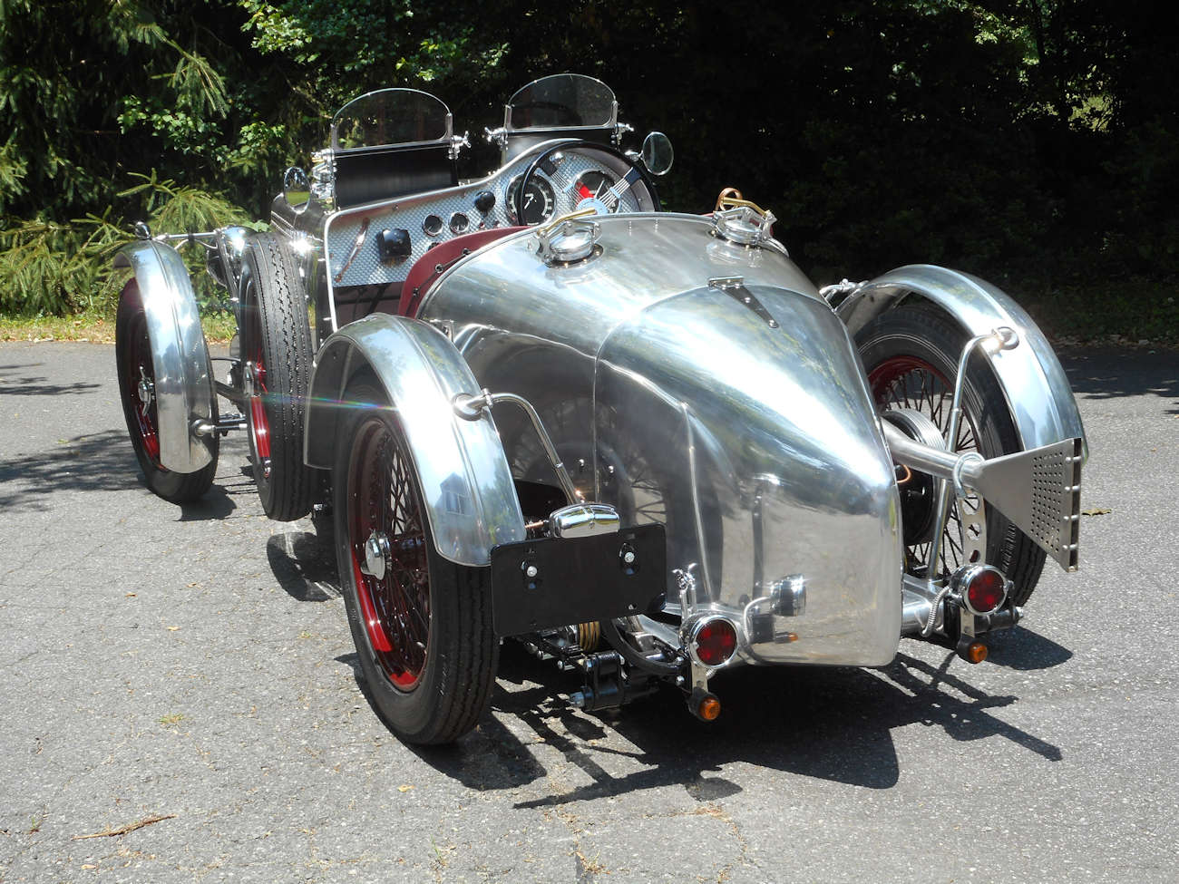

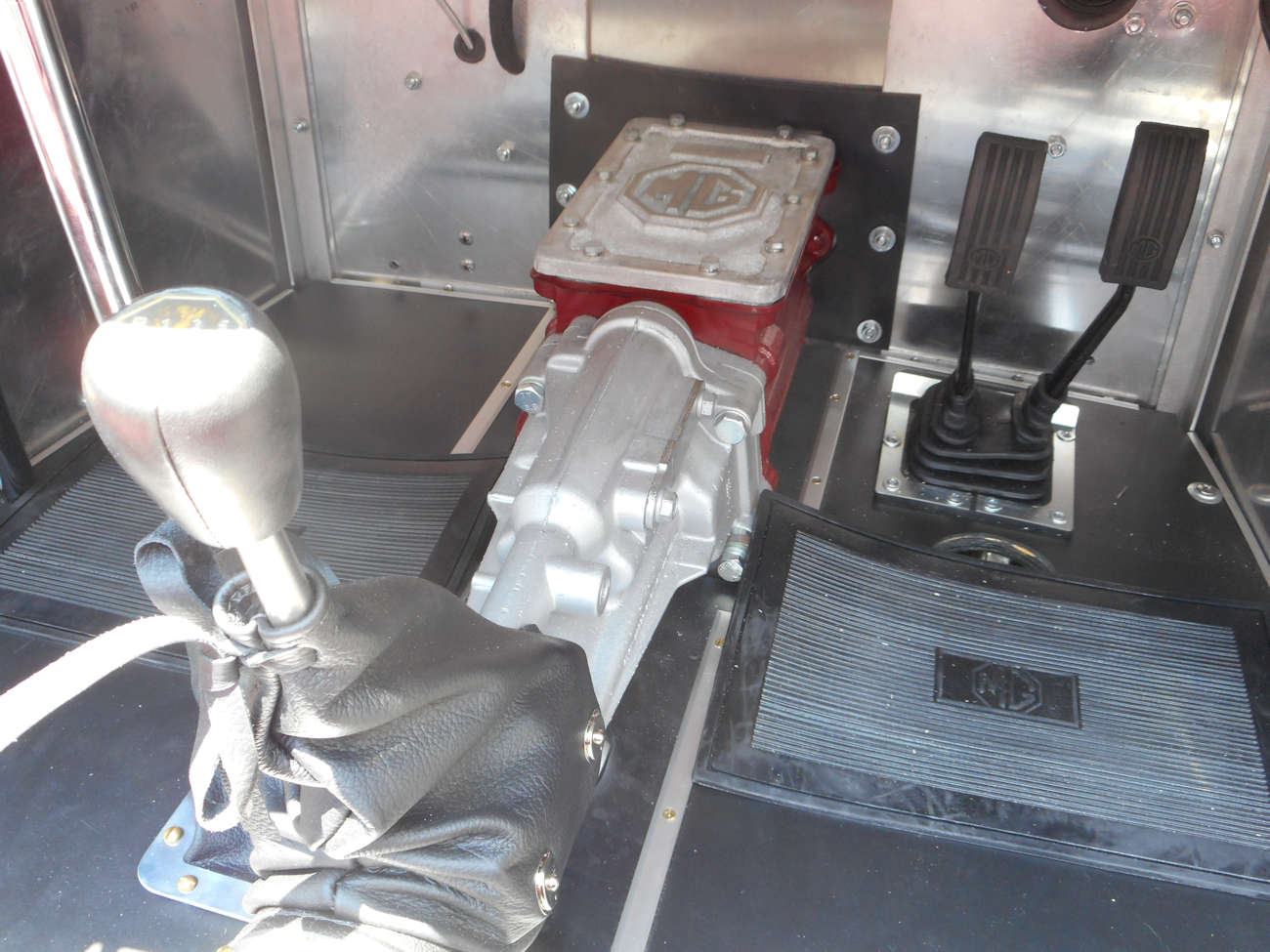

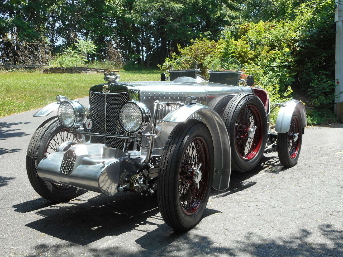

I just finished my Steve Baker Q. It isn't a "kit" as we kind of know the word. The body comes as an empty shell. Many important parts are included, some are extra. Everything else is on you. Floor brackets, seat belt mounts, floors, scuttle supports.... There is a lot of fabrication to be done. I spent 1,200 hours on it, as much time as on a recent hot rod build with A/C, P/S, P/B, SatNav, Full upholstery...
Sourcing all the parts was hard on the wrong side of the pond, but possible. There are some terrific suppliers in the UK. There are other body makers and Steve likely jobs out to one of them, but he also gave a lot of help with the small bits. You will have to be able to weld aluminum or find someone who can. Small changes and adjustments are inevitable.
