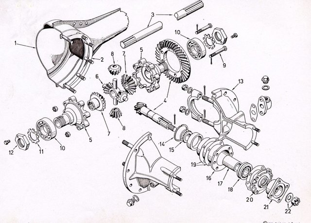

Does anyone have any of these pinion bearings #18 for sale?
If not do you know where to get some, the named reference number or stamped model of them?

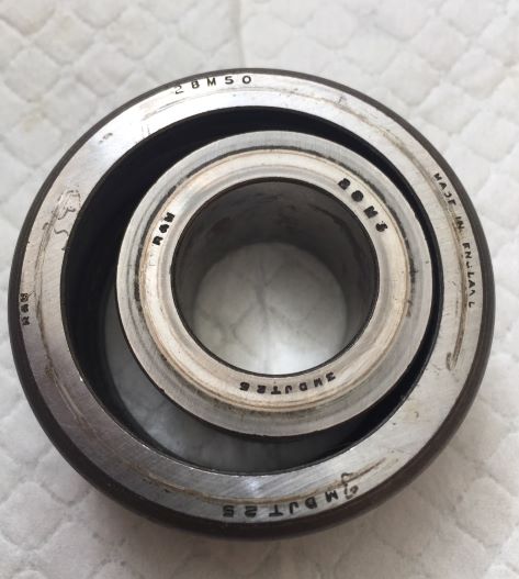

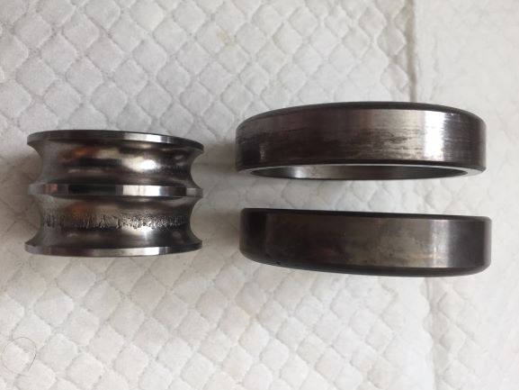

Not sure where the incorrect size of 62 x 25 x 17 is coming from. #18 is a double row angular contact bearing of dimensions 62mm x 25mm x 1" (25.4mm).
Here is a couple pics of the known original R&M bearing. It had a single piece inner 2X race, and split outer race.
