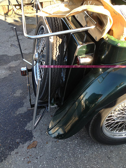

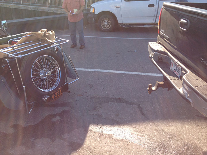

7794 was clobbered by a Chevy truck with a trailer hitch the day before yesterday. Although the fender sustained some damage being bashed against the gas tank, it could have been a lot worse.
I don't intend to fix the damage myself, but I am curious about the procedure. To remove the fender, is it necessary to remove interior fittings?
The car was pushed sideways about 3'. Is there other possible damage I should be on the look-out for?

Robert can you tell me what the diameter of the steel is on your bumpers. I have a drawing of them but don't have
the correct size of steel.
I would look for a bent wheel on the opposite side to the bent bumper.

Good idea to check the opposite wheel, Stan. The antenna is 3/4" diameter.

Should be able to unbolt it with no problem. All of the internal connections are to the inner fender.

I would look for frame damage, possible bent after impact?

No frame damage or bent wheels. I'm looking for a sample color of "Almond Green", and, or pics of TC's TD's that color.

This is where 7794 was smacked:
