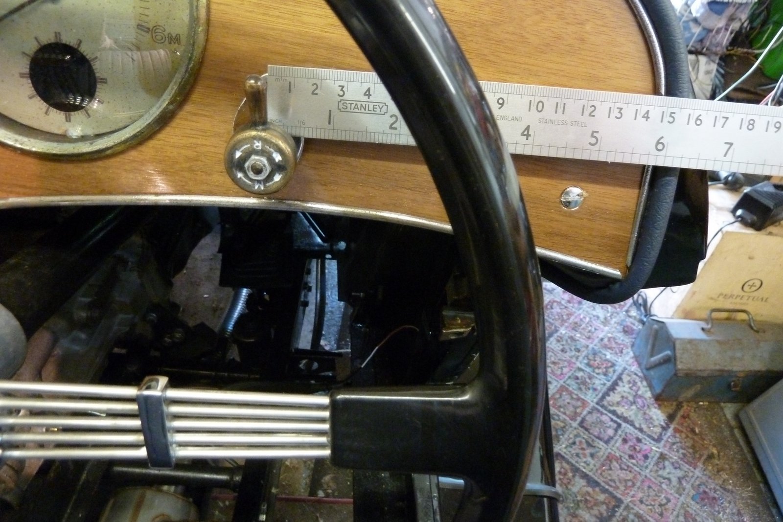

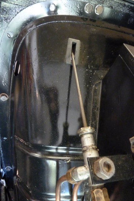

Mine is about 150mm (6 inches if you prefer) from the right hand end but of course the important part is that the control rod need to line up with the slot in the bulkhead.
Chris

Re: Let's talk about the TB for a few minutes!
Roger, the photo I sent you offline showing the gearshift knob (TB is just like the TC according to this photo) also shows the position of the fuel control.

Hallo
my TA has a MJPG replacement engine, somebody has delete the part on the photo, in the middel under the car there is a part to change between the two petrol hose from the tank, the third goes to the front.
Perhaps it will work ??????
so i would like to make it original
you know where to get the parts ?
what Diameter is the hose
I hope you understand my bad English
